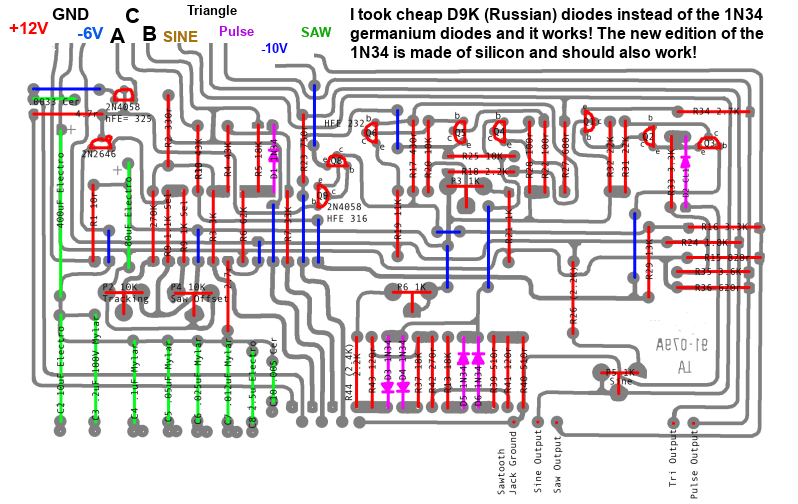

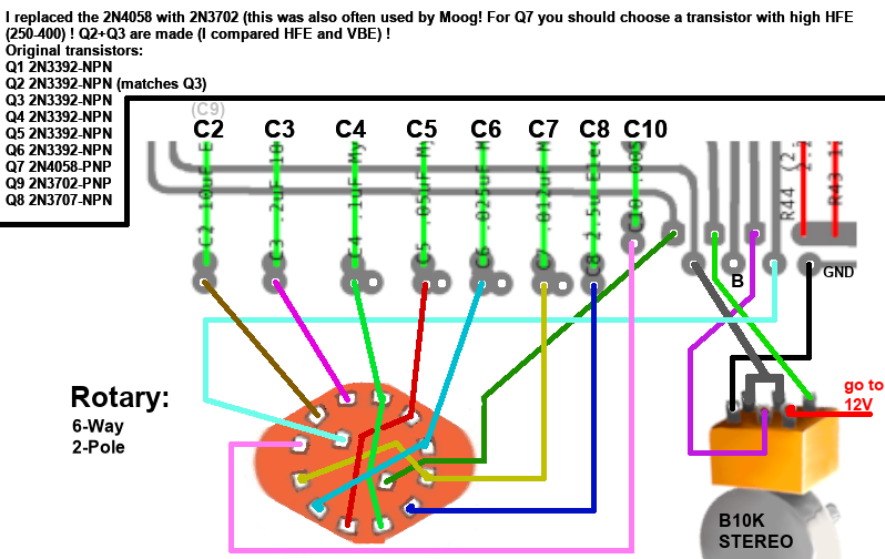

Many thanks to "Peake" who published the layout in 2007!
I checked the layout with the schematic and built it, everything works, great VCO!
I added some information to the layout !
