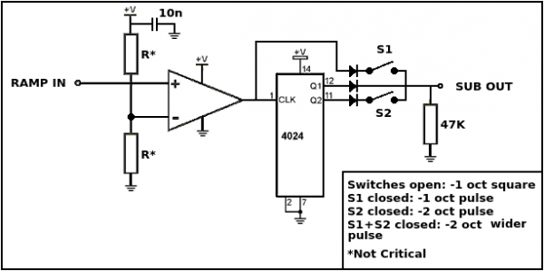

Zac Belver
Joined: Sep 20, 2018
Location: Brazil
PostPosted: Thu Sep 20, 2018 5:10 pm    Post subject: Reply with quote  Mark this post and the followings unread
Necro post! [2]
Today I've finished this one that I've started after reading this topic and other ones on the same subject. I've tested with 9V and 12V and it was ok.
The pulse switches idea came from the SH101 sub oscillator.
I didn't care not having a -2 oct square wav option.
 Filesize:  7.33 KB
 Viewed:  287 Time(s)
