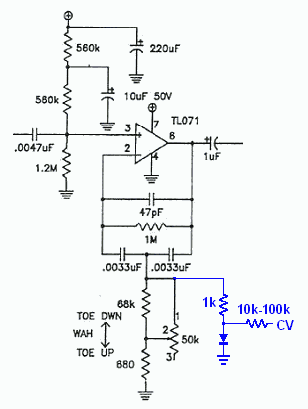

I've been researching alot of voltage controlled filters, trying to find the simplest and easiest to make and the designs in this thread keep cropping up.
But why does it have two capacitors in the feedback path? (My suspicion is that it is something to do with resonance or it increase the filter order) And what is the purpose of the 500pf cap in the middle of the feedback resistor in tim escobedo's one? And why does he say it's a "fake" low pass filter? This is a real low pass filter, I can see that it is!
Good question. I don't have an answer that will legitimately explain the theory, but the filter in the e-m link is a bridged-T filter; the two caps and diode (used there as a crude VC resistor,) schematically resemble a "T." The resistor from output to - input "bridges" the T.
The resemblance to a T is clearer in the top escobedo filter, which is a Twin-T bandpass filter;2 caps & a resistor form one "T", 2Rs and 1C form the other T. The presence of 2 "T" networks is what gives it a true bandpass response, unlike the circuit that has only one T, which really is a low pass, but sounds like a bandpass because of the peak the resonance pot gives it.

Spiffing thankyou Very Happy Looks like I will have to look up twin T filters next Cool
Just thinking: if the diode is only acting as a crude voltage controlled resistor, could it be exchanged for a transistor/mosfet? or a vactrol?

PostPosted: Fri Dec 16, 2011 12:05 pm    Post subject: Reply with quote  Mark this post and the followings unread
http://www.paia.com/ProdArticles/syndrum.htm
This circuit has the embellishment of a simple Voltage Control mechanism. The diodes D1 and D2 are effectively in parallel with R4 (one of the components that determines pitch). As the CV-in voltage increases, the exponentially increasing current flow through these diodes causes their effective impedance to decrease, which raises the frequency of the twin-T network.
The twin-T referred to is an oscillator, which is what this type of filter will do with high enough resonance (Q). But the principle is the same. And, yes, a transistor would do the job, too. Use an npn with emitter to ground, collector to where the 2 caps meet, and CV at the base.
Fucking brilliant!
Pardon my french but thats just solved a huge mystery for me and made designing my filter much easier, thankyou! Very Happy

Yes, everything in "T" filters and oscillators interacts, and the presence of the diode -- which should be silicon, not germanium -- skews the equation.
My suggestion to get more range from the filter is to disconnect +V from the Cut Off pot so that only a resistance controls the initial CF and the CV input alone -- which can get its own pot -- acts on the diode.
Increase the CF pot to 250k or even 1Meg. If that makes the range too low you can decrease the caps.

JingleJoe wrote:
So, what is that diode really doing? From the explanation above I thought it was acting as a voltage controlled resistor? But it seems like something more...
No, it does nothing more than what I said or what the quote from PAiA says.
Jeeze, you guys are getting bogged down in equations and theory. The concept works. John Simonton has used it, Thomas Henry has used it, escobedo and numerous others -- including Yours Truly -- have used it.
Here's how the Morely Wah might be modded for CV:
 Filesize:  7.7 KB
 Viewed:  32225 Time(s)

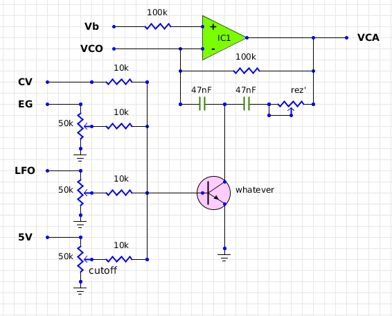

Oh I forgot to give a link to the circuit I'm working on, which uses the one op-amp filter discussed above. Here it is :
http://electro-music.com/forum/phpbb-files/mutant_ds_7_prelim_schem_525.png
Yeah now you understand better the catastrophe going on ! I suspect that one of the problems might be the presence of "voltage dividers" type attenuators, therefore we have resistances to ground in parallel with the diode or the pot as suggested by richardc64. I might also be completely wrong.
The way I found to overcome this is to use a transistor, as JingleJoe mentioned [edit : and richardc64 developed !] (thanks!) : Vc things through the base, collector to the T, emitter to ground, frequency pot to the T too. Yet not ideal, but works way better !
Yeehaa ! That's all for now, I'm out for a couple drinks ! Cheers !

umschmitt wrote:
The way I found to overcome this is to use a transistor, as JingleJoe mentioned (thanks!) : Vc things through the base, collector to the T, emitter to ground, frequency pot to the T too. Yet not ideal, but works way better !
just to clarify your arrangement could you post a circuit diagram please? I may have it right though: The transistor is conected as the diode is, but your CV goes to the base (through a 100k resistor?) and the initial/main frequency control pot is connected as normal?

PostPosted: Sun Dec 25, 2011 7:25 am    Post subject: Reply with quote  Mark this post and the followings unread
You're right. Here's a nice drawing of it with happy colors to make it even clearer. It's still a work in progress, so values may (will) change. I'm not sure if the resistors between CV pots and transistor base are required. I'll have to try without. Perhaps a small value resistor (470R ?) at the transistor's emitter is to be added. Now the pots behave in a *very* log manner, I'll have to handle it too. And screeching noises are heard with rez' at max and cutoff in the treble. A tiny cap across the op-amp might help, like in the Morley schemo above…

hah, whatever transistors, the newest brand of high fidelity medium power whatever-polar junction transevers! Laughing
I would strongly advise 100k resistors on all things going into the caps and transistor, acctually the transistor may require lower resistance but I would put that main frequency pot through a 100k resistor just to be safe.
Thanks very much for the schematic, everything is becoming clear now Smile

You're welcome, but why add those resistors everywhere ? I'm actually trying to have to be able to get the lowest possible resistance to ground at the T. For the whatever, I need to calculate how to achieve this (saturation ?) with CV pots maxed. Besides, I think - pardon the math - that the relation between cutoff R and frequency is the 1/n type, so we want those little R values… Except if I can find a 220 Gigaohm pot of course.

CORRECTION ! I'm so chaotic that I hadn't noticed that this arrangement works better than with a pot to ground ! Still need to set proper values… Anyway this transistor trick is great.

This circuit is so versatile Shocked
I've been experimenting with it alot today, I really figured out alot of things ... but it's hard to word them right.
The transistor/capacitor combination filters the signal, yes, but it also allows much of the high frequency oscillations to be bypassed to ground, so they do not feed back into the op amp and are subsequently not attenuated, this gives you the resonance (see my thread on the resonator for a device which just adds resonance and no filtering). When the resonance potentiometer resistance is high, it is almost as though there is no connection between the capacitor on the output side and the output, so you end up with alot of unusual, frequency independant resonance, also changing other components will affect the resonance.
All components are changeable!
Both caps determine the resonance and filtering of the signal however the capacitor on the input side of the feedback path (the left hand side one in my diagram) has more to do with the resonance frequency and amount of resonance. I haven't played with it but I invite you to try some different values!
Attached is a diagram of the circuit I was using today. keep the input low, about 1 or 2 volts, for best results. If it gets too close to the op amp's limits it doesn't work very well. Also using a better op amp like an LM324 or something really special like a TLV072 would make this work alot better. I just happened to have an LM348 to hand (four 741's) so I used that.
Remamber, all components are changeable and thats what makes this circuit so good, but you may get better results with other values or other types of op amps or transistors.
I feel I should mention that I had some problems with slight irregularities on my input signal, I say problems, but that should be "features" Wink Any distortion on your input signal can have a great effect, adding a power supply filter capacitor helped keep my input signal clean.

i also play with this filter and i like it!
i think this is also intersting to mod this filter
