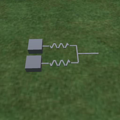

The photo below shows our simplest Boolean Sequencer which consists of a two-bit counter and a two-resistor aggregation network. Of course the two-bit counter needs a clock source which is not shown for simplicity's sake.
What happens is the counter counts out 00, 01, 10, 11, then repeats. The resistors are actually a two-input voltage divider, which I like to call an aggregation network because they take the digital input voltage levels and aggregate them into a single analog level.
Let's say the resistors are equal in value and the supply voltage is 10V. Then the output sequence will be 0V, 5V, 5V, 10V. Or if we were to weight the resistors so the MSB was half of the LSB resistance value we'd get 0V, 3.3V, 6.7V, 10V. This becomes the Control Voltage (CV) output of the sequencer.
As with any other sequencer, we would then drive some circuitry such as a Voltage Controlled Oscillator (VCO) with our control voltage to create a musical tone that varies with time. Oh, and I neglected to mention that the tempo of the music is set by the clock source. The frequency of the clock is the beats per second of the music. This is the simplest of all possible Boolean Sequencers.
