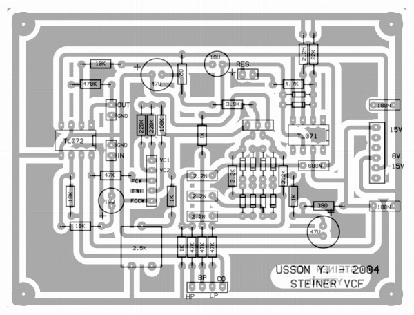

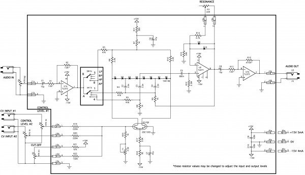

hi.
just finished
2SC1583 + TL071 based Steiner (old desighn) and no success....
checked wires by legend - ok
then started to check schematics and pcb with component overlay and STUCK.
can someone help me understand how after INput, - 10uf(+) output, - R1(10K), - signal can go in 072 pin2....
I cant reed schematic further cos i totaly cant understand what is going on.

Posts: 1319
PostPosted: Thu Mar 17, 2016 10:58 pm    Post subject: Reply with quote  Mark this post and the followings unread
Ic1 being a TL072 has two opamps in one package.. The designer made a mistake by switching the opamps in the schematics and the layout.
This is what I found. Maybe there is more, its hard to check this with a phone, even if its a smart one Wink
Make sure you use a tl071 u2 and tl072 for u1.
