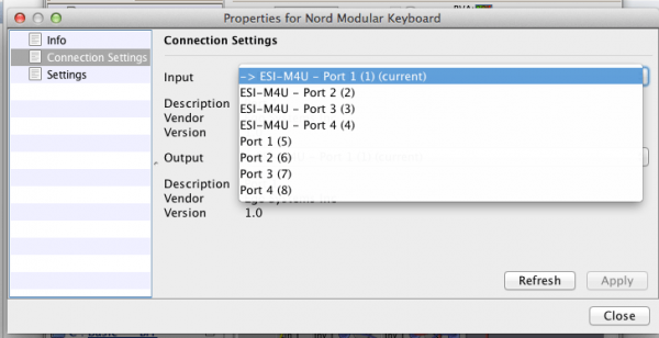

I got Nomad to work in my setup and thought I'd share it here.
I downloaded Nomad 0.3 (OS X version) here:
http://nmedit.sourceforge.net/
Installed following the instructions in the package.
My setup:
MacBook Pro 15" (new version that ships with Lion)
OS: 10.7.2 (Swedish language selected)
Clavia NM1
ESI-M4U (USB 4x midi interface - native, no drivers)
MOTU 823 mkIII (MOTU Firewire driver)
It took me a while to understand I should click the yellow square (down to the left in Nomad) to connect to my synth. Maybe I should read the manual.
Two problems - solved:
1. Firewire Midi/Audio messes witth Java midi somehow. The Firewire soundcard must be turned off when Nomad is started. Luckily it can be turned on as soon as Nomad is sucessfully connected to the synth. I haven't tried using it for long, Nomad connection might be lost under certain conditions (inactivity maybe) but not during my tests.
2. The native driver for ESI-M4U has issues in Java midi. It presents the interface twice in Nomad. See the picture! If the "real" ports doesn't show restarting the midi device (disconnec/reconnect USB) solved the issue.
My 4x midi device from ESI presents itself twice under java midi in Nomad. It's the first four ports that works. No other midi devices where connected.

It was a while now but as I recall I did not install anything extra. I just used Nomad right away I believe. Using whatever Java I have on the computer. Under Java Inställningar (settings) I read "Java SE 6 version 1.6.0".
No I don't think there was a blank panel when MOTU 828 was turned on. As I recall the midi ports in Nomad midi settings where messed up. Either there were none or it was impossible to connect to them. As if the MOTU midi port somehow made Nomad lose track of which port is which. I could never connect to the midi port in the MOTU.
However I was a bit disappointed with some functionality of Nomad so I started using VirtualBox/Windows XP running the original PC-version of the Modular Editor instead. And I must say it works better in every way (no port issuses) except it takes a while to fire up Windows and the USB-port is reserved by Virtual box.
