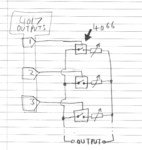

Hi, thanks for reading this post. I have just a simple question for you guys.
Basically all I want to do is to make a step sequencer that outputs resistance values instead of CV. It would just step through a variety of resistances, and the resistance for each step would be controlled by a pot, etc, etc. I have a Casper Electronics DroneLab that I have modified so that different resistances can be patched in in place of the pots that control oscillator pitches and filter parameters, and I thought it would be cool to control it with a sequencer.

What about a microcontroller with 8 pots to the input and 8 leds to show which is being triggered then a digipot to achieve your resistance

This should give you some ideas Smile
I haven't tested it but it should work, you will need to experiment a lot, the 4017 outputs may need pull down resistors and you will need a clock circuit for the 4017 too.
The output is between the two common busses, connecting to all the variable resistor and analogue switch combos, only one of which will be active at any one time.
repeat the circuit for more steps
