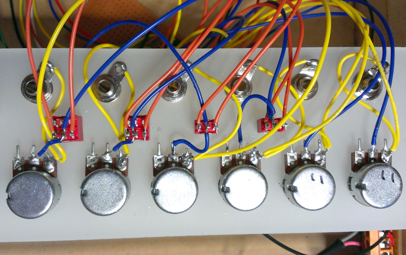

Howdy All,
I have been lurking (as a member) here for ages having a ball breadboarding all sorts of stuff and driving the family nuts with noises coming out of the office! Time has come to get my Lunetta synth actually made but this module is driving me nuts.
Just a 40106 using all six in/outs. 4 have switchable caps for a bit of variation. I have some big caps in there (330μF is the largest) since I want some really slow clock timing for some and up to 1μF and above that and the green I don't even know the value of but sound good. I am using the circuit below on the 4 with switches and just straight on the other two. I didn't breadboard this with switches I will admit. Something is very wrong though. For starters if the voltage is at 9 volts it will oscillate for a few seconds then stop. If I take the voltage to around 8 and even down to 5 volts it works sort of right but the sound is still a bit wonky.
As far as I can tell the wiring seems correct but I am missing something fundamental here. I have attached a couple of images of the module wiring and front.
Please note that the image doesn't show my connection to ground on the negative rail for the caps as I used a crocodile lead whilst testing.
Yellow wires are outputs. Blue are inputs.
Hope someone can help. I have spent hours trying to fault find this with different wiring arrangements and caps. Please let me know if you need more info.

Hmm that's some unusual behaviour and looking at the photos that part seems to be wired correct.
Do you have a photo of the part with the chip, maybe I can spot something there.

Large electrolytics can be a problem in this circuit as the leakage current of the caps will be in about the same range as the minimum current flowing through the pot .. this may stop oscillations.
However I' d expect that effect to be worse on lower supply voltages.

I also guess that 's the problem. And it is worse with higher operating voltage, because the average cap voltage ( around V/2 ) causes a higher leakage current through the caps then. So the behavior matches theory Wink
you can try to cure the bad cap behavior : take them out and attach them
to a power supply with the rated cap voltage for some minutes. Don't forget
to discharge them before resoldering them into your Lunetta !
Another option: compensate the leakage current by wiring a 22k..100k resistor from the caps to +9V.
BTW: I'd rather use small non-electrolyte Cs and use a 4040 to get the low freqs.

PHOBoS - Thanks for the welcome. After the dodgy behaviour on stripboard I went back to breadboard so I can take a pic of that later but really it is just the in/out into the 40106 plus power. I stripped the board of all other parts to make sure they aren't causing problems.
Blue Hell / elektrouwe - Yes the caps might be an issue to look at. I have had no problems using any of those caps breadboarded. I will try smaller values and then non-electrolyte. As you say elektrouwe a 4040 for the slow rates. But grrrr! This should work!

Yeah thanks Corex. I tried some smaller caps but still getting some unpredictably insane results from nothing to dodgy unsteady oscillations. I wonder if the freeform wiring has some anntenae effect (pardon my basic electronics)? Also I bought the pots from Futurlec for 55 cents (AUS) each which seemed dirt cheap. 100K but they vary anywhere from 89 - 110K! Maybe the contacts in them are crappy as well. Anyway - I think I might just get all the caps back onto the stripboard so I can just get this built. It means a few more wires to the switches etc. but so be it. Fingers crossed.

using a normal 330u cap shud work fine. i have a osc here (from a 4093) with a socket for the caps. I have tested 470u, 1000u and 2200u. the only differnce is i have a 1.1k resistor in series to the pot and iam running my lunetta stuff at 5V from a 7805.

Hey DUBmatze - as far as I am concerned there are no dumb questions! Yes I quadruple checked the ground and everything else. I tried a different breadboard, 3 power supplys including a 9 volt battery and 4 different 40106's with all the same results. Very weird. I will strip it down and check all the components. I checked for dry joints everywhere but they all seemed fine. Mysterious. Mad

OK - fixed and working beautifully Very Happy . I wired all the caps to the stripboard. It meant 2 more wires to each switch which means wires everywhere but who cares - it works! Used the big caps again as well - down to 470µF and no problems. Wished I could work out why the original method didn't work but now I can move on - yeehaa! Thanks to you guys for trying to help. I will have plenty more questions as I go no doubt Razz .
