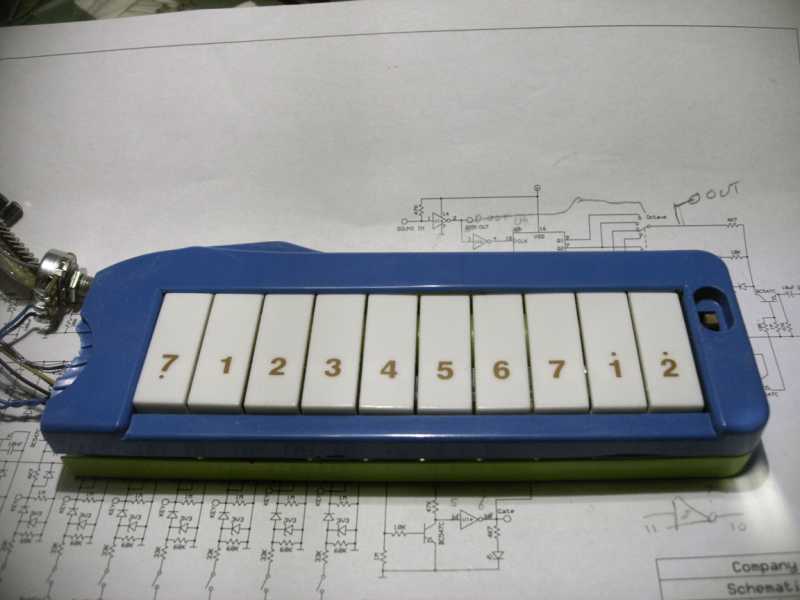

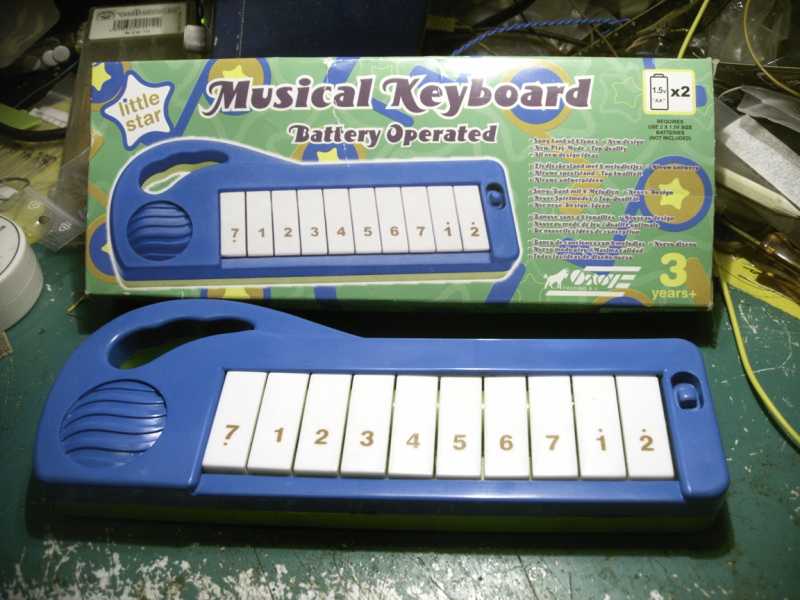

This is a project I'm currently working on and instead of waiting untill it's completely finished I'll post the progress I make
along the way.
It started when I went back to think about what i was gonna do with the Schrödinger II circuit. One thing that came to mind was to make
a stylophone controller for it, which then lead to the idea of using a small keyboard instead, using a cheap (€1,-) toy keyboard.
Initially I wanted to add a trimpot for each key or maybe a resistor string, but it turned out that the PCB was so small it would be hard to
solder anything to. So I ditched that idea and played around using the output of the keyboard to control another oscillator, and this gave me
the idea to just square up the output and use it as a tuned oscillator.
first a little more info about the keyboard I'm using. It has 10 keys, tuned to major intervals (white keys). When you press a key a tone will
only play for a certain duration so it stops even when the key is still pressed down. It also has a switch that puts it into melody mode.
In this mode each key plays a different melody, restarting from the first note everytime you press a key. It runs on 2AA batteries and has
a small speaker.
So now to square up the output. Well this turned out to be a lot easier then I could have hoped for because when I connected my scope to the
output a nice squarewave allready appeared Laughing Since the keyboard runs on 3V, the output voltage isn't high enough to control anything
directly. However, as it turns out, it's an open collector output (there is no extra transistor on the PCB though), with the speaker connected
between +3V and the output. So all that's needed was a pullup resistor, connected to the voltage I want to use, instead of the speaker.
Followed by an inverting buffer for which i used a 40106. For the sound itself it doesn't have to be inverted but when there is no sound
I like the output to be low.

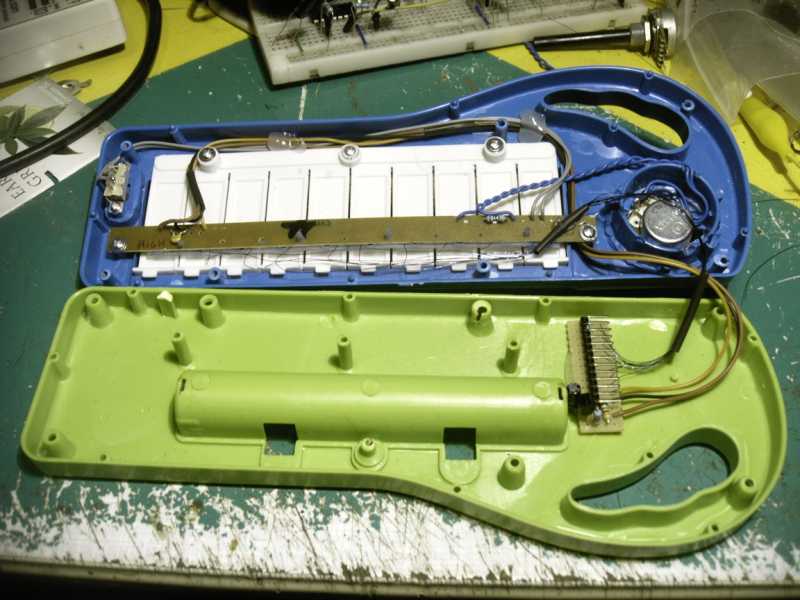

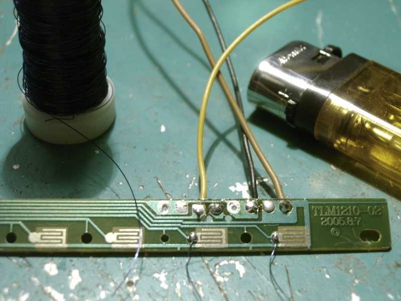

To be able to do all this I did have to solder wires to the PCB afterall, so I used some thin enameled wires and soldered them to a piece of perf
with a printconnector on it. This will make it easy to solder wires to it later. I also added a 3V supply using an LM317L.
I'm currently soldering the main PCB, So more info later.
But here are some photo's.
This is it!
 Filesize:  50.24 KB
 Viewed:  803 Time(s)
soldering small wires, lighter for reference
 Filesize:  40 KB
 Viewed:  802 Time(s)

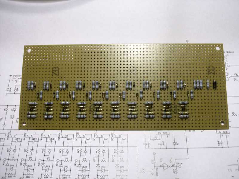

Posts: 5881
PostPosted: Sat Feb 23, 2013 6:00 pm    Post subject: Reply with quote  Mark this post and the followings unread

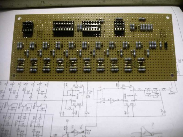

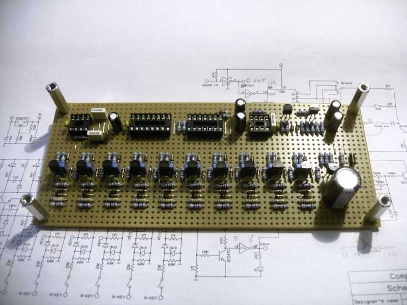

soldering,...
main PCB, under construction
 Filesize:  49.73 KB
 Viewed:  834 Time(s)
some more components added
 Filesize:  48.29 KB
 Viewed:  850 Time(s)
just a couple of transistors and a big capacitor left, but that'll have to wait untill tomorrow.
 Filesize:  48.6 KB
 Viewed:  845 Time(s)
Posts: 5881
PostPosted: Sun Feb 24, 2013 4:22 am    Post subject: Reply with quote  Mark this post and the followings unread
I'm done with soldering the main PCB, but before I can wire it up I first need to design a frontpanel and make a case for it and then order some
switches which should arrive tuesday. Maybe I'll solder a couple of wires to the PCB and do a couple of tests though.
Main PCB done
 Filesize:  47.19 KB
 Viewed:  785 Time(s)

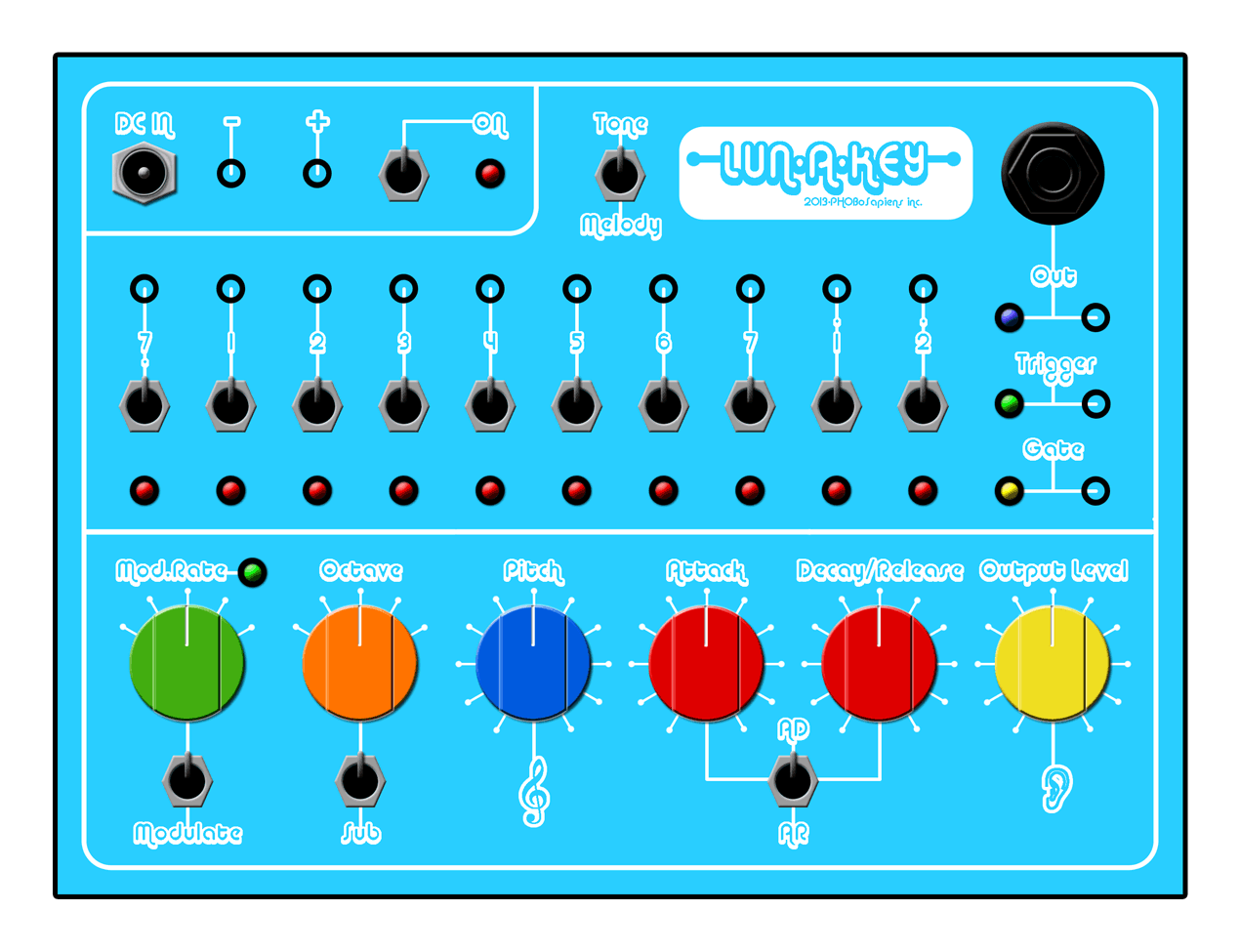

Posts: 5881
PostPosted: Sun Feb 24, 2013 8:32 am    Post subject: Reply with quote  Mark this post and the followings unread

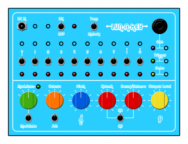

front design sofar. I think I'm gonna give it a sloped, almost vertical, front panel Cool
Lun-a-Key front V1
 Filesize:  79.1 KB
 Viewed:  842 Time(s)

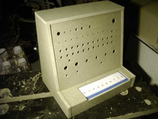

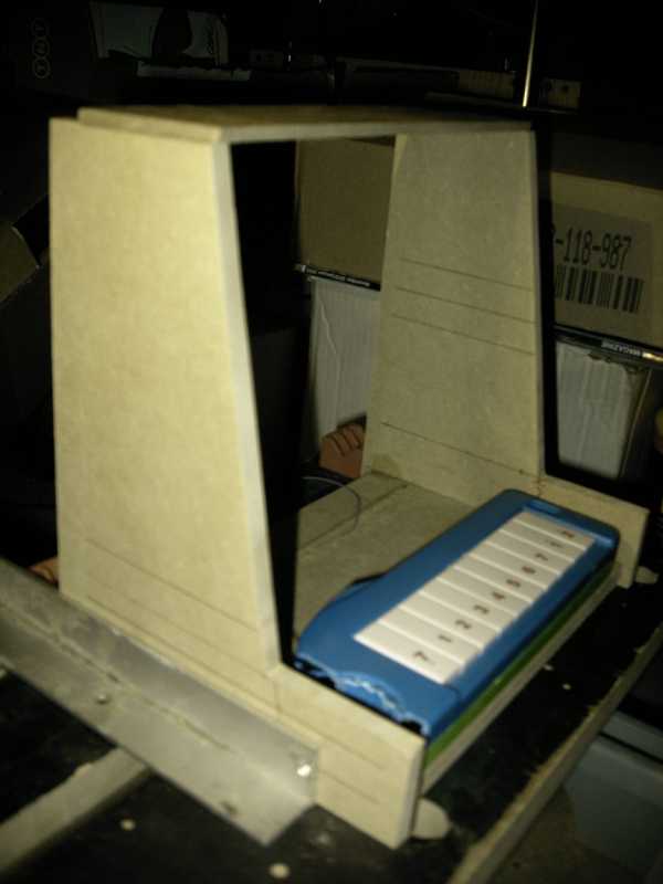

Recently I cut my keyboard in half. I also cut some wood to size, but 2 parts are allready glued together, so now I'm waiting for that to dry and then I'll take a photo of it.
recently I cut my keyboard in half.
 Filesize:  30.91 KB
 Viewed:  903 Time(s)

PostPosted: Sun Feb 24, 2013 3:57 pm    Post subject: Reply with quote  Mark this post and the followings unread
not the best picture but It'll give you an idea. the piece on top is just some scrap wood (might be usefull to cover the keyboard).
and an updated cover design Cool
case, under construction
 Filesize:  25.44 KB
 Viewed:  903 Time(s)
Lun-a-Key front V2
 Filesize:  82.54 KB
 Viewed:  788 Time(s)

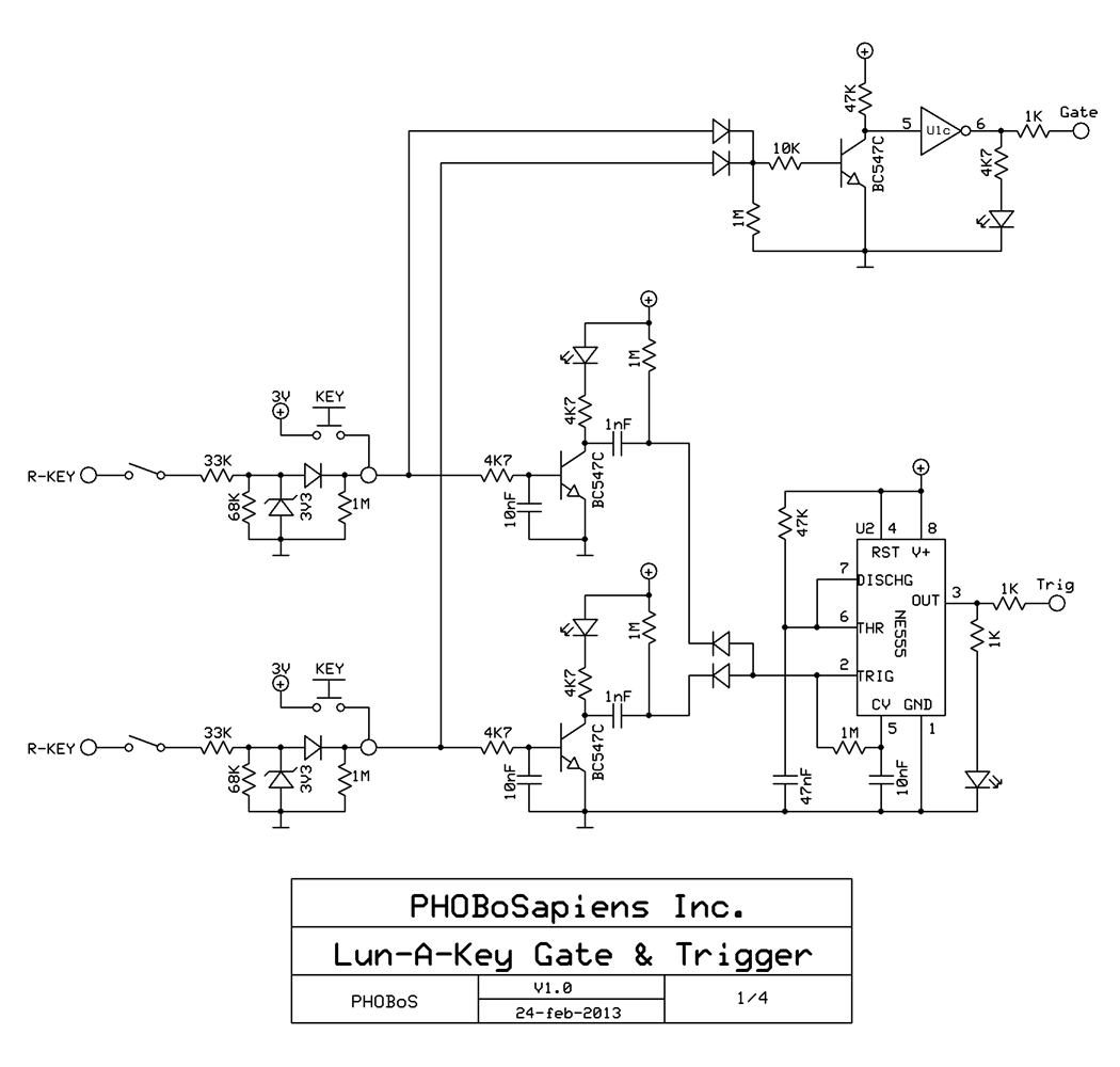

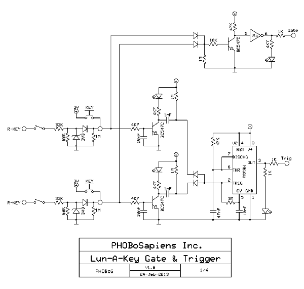

PostPosted: Sun Feb 24, 2013 8:17 pm    Post subject: Lun-A-Key
Subject description: Gate and Trigger circuit
The cat's not dead yet Laughing (I'm thinking of making a full schrödinger synth out of it Shocked ).
I look forward to see what you're working on and it would be great if you could make use of some of the things I've posted Very Happy
ok here's the first schematic (I'll post it in bits, since it's quite large and easier to understand in parts) . The Gate and Trigger circuits aswell
as the external control inputs for the keyboard. I've only drawn it for 2 keys, but in reality there are 10.
starting of with those, the keys of the keyboard are just switches that connect a 'KEY' point to the positive supply of the keyboard (3V),
so it's pretty easy to control these with an external signal. I want to use an input voltage in the range of 5-12V which would probably fry
the circuit in an instant. So I added a voltage divider (33K + 68K resistors) which has an output voltage of 3.3V with an input of 5V.
With the voltagedrop over the diode that's in series, there will be ±2.7V left, which is a safe value and enough to trigger the keyboard.
And if the input voltage is higher then 5V, the zenerdiode will still keep it at that.
next the Gate circuit which is very simple. An OR-gate made with diodes and a resistor, followed by a transistor, because the voltage is too
low to trigger a CMOS gate directly, which is in turn buffered by a schmitt trigger inverter (40106). Because the transistor allsoy inverts,
there is no need to add an extra inverter.
The trigger circuit also includes the LED indicators. The transistor, in combination with the 1nF capacitor and pull up resistors (one in series
with the LED), creates a very short high to low pulse.The pulses of all the keys are then combined, again using the same diode resistor configuration
of the OR gate but inverted, so with a pullup resistor and the diodes reversed (it's an AND Wink). If you're looking for the pull-up resistor it's the
1M attached to pin 5 of the 555 timer. The 555 is used in monostable mode and turns it a into a neat trigger signal. The 10nF caps attached to
the base of the transistors are to debounce the keys of the keyboard.
more next time sleeping
NOTE: the current through the zenerdiodes is too small for them to work, so in the final design I placed 4K7 resistors in parallel
with the 33K resistors.

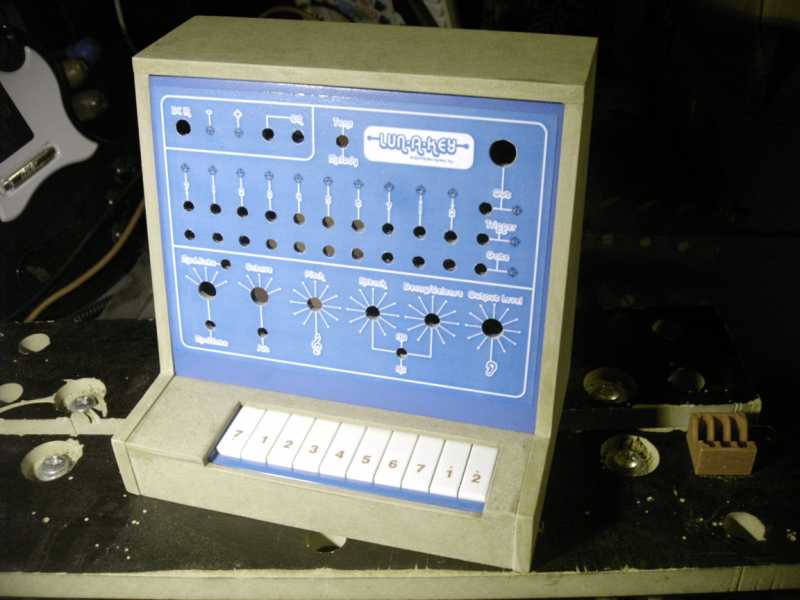

it's starting to take shape Very Happy
Lun-A-Key case, not completely glued together yet.
 Filesize:  36.29 KB
 Viewed:  708 Time(s)

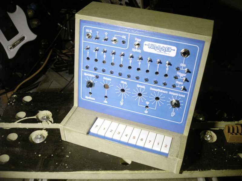

Posts: 5881
PostPosted: Tue Feb 26, 2013 7:55 pm    Post subject: Reply with quote  Mark this post and the followings unread
frontpanel and keyboard wired up. I'm almost done with painting the case, but you'll get to see that when it's completely finished. (maaaaybe tomorrow) Cool
 Filesize:  56.55 KB
 Viewed:  637 Time(s)

Yes it's MDF, the front is 4mm which is indeed too thick for sockets, but I've still managed to use them by using a chisel and carving some
layers away, If you have a completely round 3.5mm jack socket it's easier because you can use a large drillbit, I've done this for those
DC input jacks. But be careful if you do it this way,. don't put it in a drill just turn it carefully by hand. You might be able to use a drillpress
but you would have to be VERY careful, else you just end up with a large hole.
here's an example from my PWM lunetta,.. look at the sockets at the top:
the sides and top are 8mm btw and I used a heavier 12mm piece for the bottom to add some more stability. (I used 18mm for the Bandersnatch).
I now have everything wired up,. so next is going to be the hold-your-breath-and-turn-it-on-and-hope-there-isn't-any-smoke part. Shocked
The painting set me back a bit timewise, I'm doing a duotone but one color kept messing up the other. I think it's ok now just needs some
clear coating. If I can resist I'll let it harden further until tomorrow before I put it together, allthough it will be dry enough to handle.

After I rewired the LED's yesterday there was still one LED that didn't light up. I wondered if I put it in reversed again so desoldered it,
and tested it (couldn't really see what was anode or cathode) and it turned out to be dead. I used some different LED's then usual (waterclear)
of which I had just enough,. I almost went into panic mode, but luckely I did manage to find just one more. After replacing it all the LED's
lit up as they should. Very Happy
So I inserted the 40106 and the 'Gate' and 'Out' LED's worked too. After that I put the 555 for the 'Trigger' output in place and that also
worked as it should.
Next the 4040 (octave switch, sub-octave and modulation). I could see if it worked by looking at the mod.rate LED, which seemed to work
except at one position of the rotary switch. So I checked what it was connected to and it turned out to be the wrong pin of the 4040.
It would actually blink really slow, but because the keyboard only produces short tones it didn't get a chance to turn off.
After I resoldered it to the correct pin I still wasn't really happy with the modulation rate. Originally I planned for a 4 step switch,.
but when I designed the front I changed it to 5 steps (I could have used 12, but the slow modulation is useless). So initially I choose
a larger division of the original squarewave for this 5th step, but in my opinion it was too slow,. so I shifted everything 1 step and
used a smaller division instead.
Finally there was one more chip to insert, the 555 for the AD/AR generator and with this inserted I could actually listen to it. Well,
I got sound but the AD/AR generator didn't seem to work as it should, it did something though. So I compared the schematic with the
PCB layout and noticed I had the timing capacitor in backwards, which of course I also put in the wrong way on the PCB itself. (this probably
happened after making some last minute changes for which I had to move some components around). After I replaced the cap (just to
be sure) the AD/AR generator worked too. Laughing allthough it doesn't always seem to retrigger but that's probably just how I designed it.
I might look into it, but it works well enough.
At this point I thought I had all systems running,. untill I tried the remote inputs. The key LED lit up, Trigger LED blinked, Gate LED lit up,
but no sound
So I measured the voltage going to the 'keypoint' on the keyboard and it was only ±1.2V. which should be 2.7V, hmm. I first removed the
connection between the input resistors and diodes and the rest of the circuit to see what voltage I got, but still the same. So I
removed the zenerdiode (keyboard disconnected) and now I got a voltage of ±6.6V which was correct. Well, what i didn't keep in mind
was that a zenerdiode needs some current flowing through it to work, and I had done just the opposite, that is trying to keep the current
through the diode to a minimum. So I just needed to reduce the input resistor (33K) and to make life easy I didn't remove it from
the PCB but just soldered a 4K7 resistor in parallel. After this modification the remote inputs worked perfect. So at this point it was
finally all working as it should.
One final change I made was change the series resistors of the Gate/Trigger/Out LED's which were not bright enough in my opinion.
The Gate and Trigger LED's are both waterclear which usually are also pretty bright but not these ones. And the Out LED is a blue
one, which can be pretty bright, but because it's actually blinking with a 50% dutycyle it's not as bright as when it's just on.
I'll post some schematics later. I'm still working on the paint now. I put some clear coating on this morning, but I should have put
down some fresh newspapers because the force of the spray lifted the paintdust of which landed where it shouldn't .
So I had to repaint a bit again. But I should be able to put it together today.
