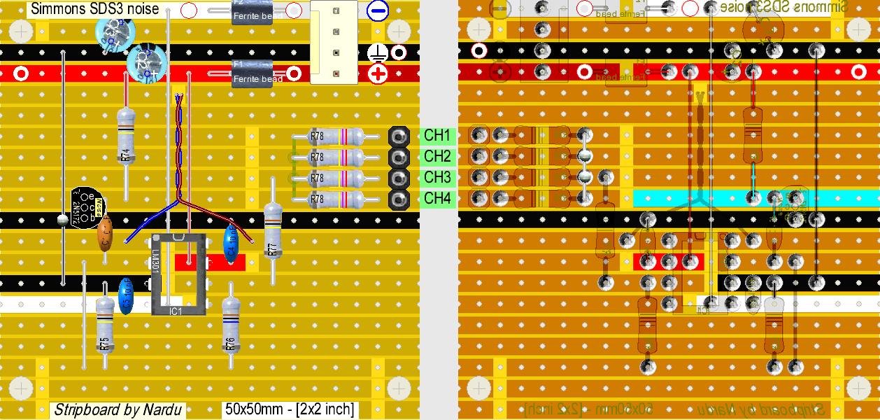

i need a noise generator Stripboard layout. does someone has one ?
I have a lot of synths without a noise source, like little phaaty minitaur etc. this synths have a external in. for live gigs i don't wan't to use modules , so i wan't to build a box with 1 or 2 dif. noise white and or pink noise. just to put it in to the external in. the best is to use it with a 9v battery etc...
does any one have an idear or can help me.
that will be great.

this is a simple circuit that you should be able to transfer to stirpboard without any problems:
http://www.electro-music.com/forum/topic-37453.html
should work with 9v without any major modification.

- Below , a striboard version for Simmons SDS3 noise circuit from http://www.electro-music.com/forum/topic-37453.html
Stripboard for Simmons SDS3 noise circuit

citric acid
Joined: Jun 11, 2011
Posts: 45
Location: germany
PostPosted: Sat Sep 28, 2013 12:12 pm    Post subject: Reply with quote  Mark this post and the followings unread
thanks for all replays:) now i have a lot. i think the sds one is cool. thanks

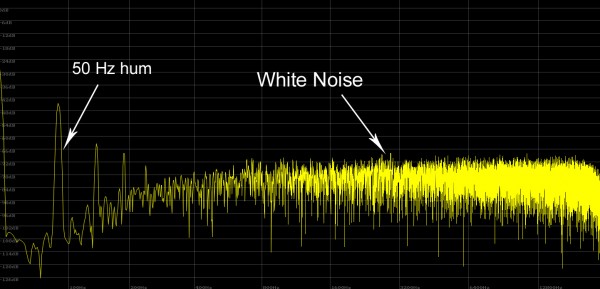

Hi all! I have a problem with 50 hz hum which present in EVERY white noise generator that I've build. I've tried few schemes. Where is it came from? It's not a sound card (i've tried different cards and amps and cables). It's not a power supply (at the picture bellow scheme is powered with 9V battery).
 Filesize:  224.42 KB
 Viewed:  363 Time(s)
