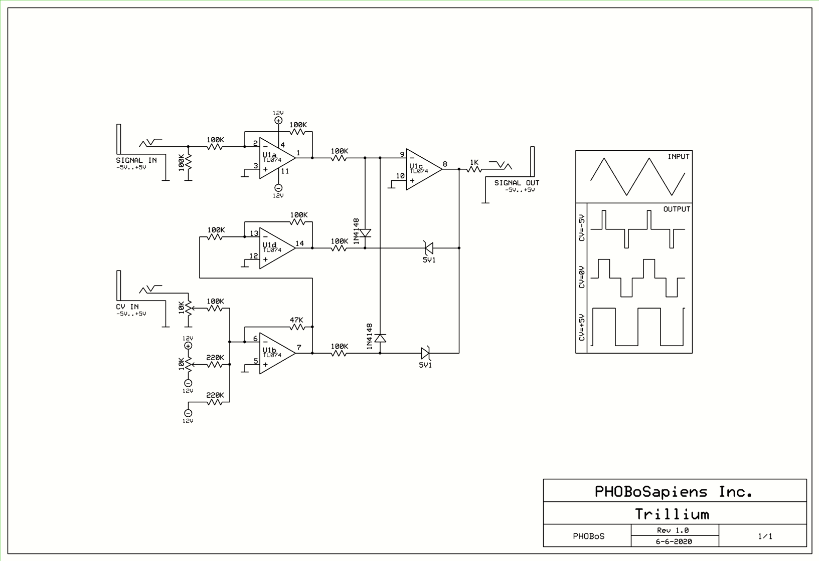

After watching this video on how to make a window comparator with a single opamp
I messed around with the circuit a bit and turned it into a simple waveshaper.
I've only tested it with a triangle wave but you could use it with some other waveshapes (squarewave doesn't work of course).
note that the output signal is more rounded than drawn caused by the soft clipping of the zener diodes.
 Filesize:  51.93 KB
 Viewed:  643 Time(s)

PostPosted: Sat Jun 06, 2020 10:51 pm    Post subject: Reply with quote  Mark this post and the followings unread
I wonder... you mention soft clipping, would putting germanium diodes in series with the zeners have any effect?
Posts: 5911
PostPosted: Sun Jun 07, 2020 4:48 am    Post subject: Reply with quote  Mark this post and the followings unread
well if anything it would change the voltage at which it clips (assuming you are thinking of guitar pedals)
at least if you use it as a zener diode. In the other direction it functions pretty much like a standard silicon diode.
Actually now that I think about it, a single zener dode can be used for assymetrical clipping. I don't know in
what way it would change the characteristics though which I think is one of the reasons to use different kinds of
diodes like germanium (they can also look really nice). Are zener diodes actually used for clipping audio signals ?
I mean they could but the voltage is probably pretty high for standard audio levels.
note that I am not entirely sure if soft clipping is the correct term in this case. I just went with how the signal looks
on my scope which has very rounded edges compared to for example an opamp slamming against the supply.

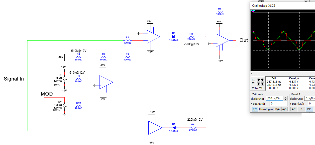

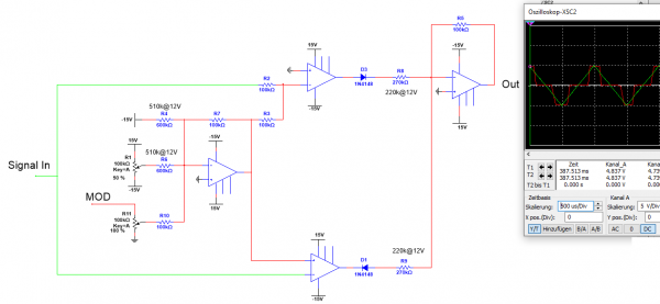

Hi!
The Trillium Circuit reminded me of something i had in the simulation-storage.
And with phoBos permission Smile i post it here.
I have used the moment also to test the idea on my breadboard and it do work as simulated.
the basic circuit:
 Filesize:  36.24 KB
 Viewed:  575 Time(s)
Posts: 5911
PostPosted: Sat Jun 13, 2020 6:52 am    Post subject: Reply with quote  Mark this post and the followings unread
That's very similar indeed Laughing
Looks like you used a somewhat more conventional approach which is closer to what I would have done too
if I wanted to design a circuit to create that waveshape without having seen the single opamp window comparator.
Note that I started with my design with the idea that you could make the waveshaper with only a single opamp, a bridge rectifier
and 3 resistors. That worked but then of course came the idea to add some CV control to it to make it more interesting.
I wanted to do some calculations to see how it works but decided to breadboard it and do some measurements instead
which confirmed a small 'problem' with it. I think it's mostly because my supply isn't completely symmertrical but I believe
that the output of a TL074 (which I tested with) isn't exactly symmetrical either. As a result the output also isn't symmetrical
but this can easily be fixed by adjusting the resistor values of the final summing amp.
Apart from that I can confirm that it works and does exactly the same thing as the Trillian circuit, nice! Very Happy
