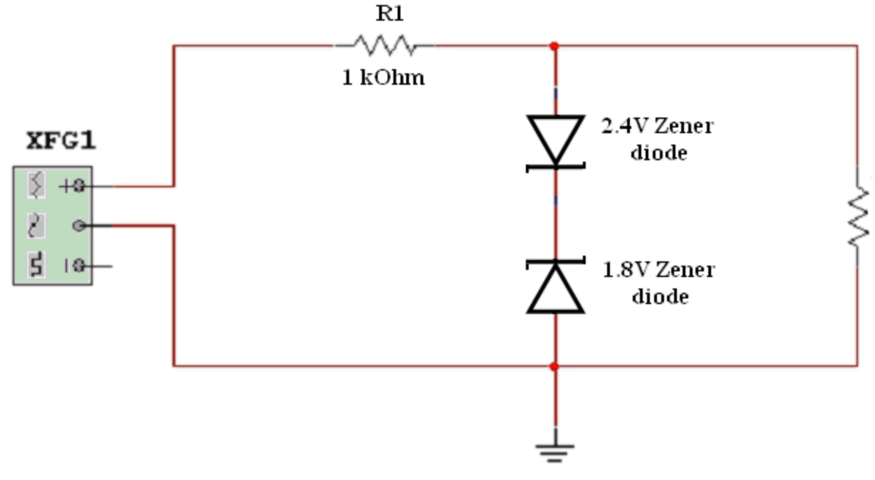

I'm having some trouble filtering through exactly what it is that I need on google and am on a time constraint with this project so if forgive my ignorance only been doing electronics for a few months this is just for an art exam
Could anyone suggest some kind of limiting circuit/other ideas I could put at the end of the signal path of a drone type synth. It puts out noise at a stupid level due to the fuzz-delay circuit at the end which is fine but it would take your head off with headphones straight into the output jack which someone might do. It runs off 9v. Ive heard vactrols can work? Anything passive would be ideal
Any help would be appreciated, thanks

You could use a resistor in series with two zener diodes, which on its turn are in series with the anodes connected to eachother.
Pick your signal from where the resistor is connected to the zeners.
Choose the apropiate values for your application.

Beautiful thank you, so is that input to the labelled resistor, output from the diodes? What do they do, it looks like an overdrive/distortion type concept do the clip the signal?
Edit: i found some information on this type of circuit but im confused where the input/output is. When 'voltage in' and 'voltage out' are stated they're referring to the audio signal? In my case? In the diagram you show, thats a function generator right? So those two lines are two different signals?
Posts: 1310
PostPosted: Thu Oct 08, 2020 2:30 pm    Post subject: Reply with quote  Mark this post and the followings unread
Voltage in is to the left, output is over the resistor to the right while the resistor most right might be the input impedance of the module following this circuit.
Mind you: the voltage over a conducting diode Is approx. 0.7 volts add this to the reverse voltage across the zener diode and you have the maximum (ish) voltage you need.
For example: If the zener voltage of both zeners is 3.3 volt you get a maximum voltage of 4volt positive to 4volt negative.

OK thanks mr grumble, so when we're talking about volume in an audio generating analog circuit does that also equate to voltage? So a high volume would be a high voltage? Hence we're using diodes to set the maximum voltage/volume?
Also when you say 'voltage of both zeners' would that be all together, not individually?
Posts: 1310
PostPosted: Fri Oct 09, 2020 4:00 am    Post subject: Reply with quote  Mark this post and the followings unread
Exactly 🙂👍🏻
Since the zeners are connected anti-serial (is that even English?) one is conducting and the other is in reverse (which means that the max voltage is the zener voltage) and the output voltage is across both zeners, the answer is : Yes

OK, one last thing, your example of 'zener voltage of both zeners is 3.3 volt you get a maximum voltage of 4volt positive to 4volt negative' - does that mean there's 8 volts across/output? I'm still confused by the negative not just meaning ground in synth designs. And is there a chart for equating voltage to volume/db or is that not the right way to think of it
It could be 8 Volt across the output but it depends a bit on your signal. If it is a bipolar signal, meaning it has a positive and a negative voltage
(referenced to ground), then yes the output swing would be clipped at maximum 8Vpp (peak to peak). Most audio circuits do have a bipolar signal
and for a single supply circuit this usually means there is a capacitor on the output, which kind of shifts the whole signal so it is referenced to GND.
For example if you have a circuit that produces a signal that fluctuates between 0v(GND) and +9V then after the output capacitor it could now
fluctuate between -4.5V and +4.5V. This does depend on what you reference the other side of the capacitor to but this will usually be GND.
It doesn't work perfect though but in general that's what you'll see with single supply circuits. You will probably come across circuits that label
this capacitor as DC-blocking or AC-coupling and it is also used on inputs.
Now if you would not have this capacitor and the output would indeed fluctuate between 0V and +9V then the zener diodes will only clip the
positive half of the signal so it would be clipped at +4V making the total amplitude 4Vpp. (in that case you would actually only need 1 diode).

I do wonder if clipping with diodes is what you are after but I will make a seperate post for that.
Although diodes will definitely limit the signal they're not very kind to them and just chop off whatever is above their limit. For a squarewave
or a DC signal this is fine and it will mostly just reduce the amplitude but for any other signal it will affect the waveshape. For example a triangle
wave will turn into a trapezoid looking wave and you can say goodbye to those nice curves a sinewave has which in the worse case will end up
resembling a squarewave. Of course different waveshapes also sound very different so if you clip it with some diodes what you get out of it is
not just the same as what you put into it but at a lower level. This doesn't have to be a bad thing though, a lot of distortion/fuzz effects make use
of clipping the signal with diodes to create extra harmonics by changing the waveshape which will result in a richer sound.
I don't think that is what you are looking for though and you might just need a simple attenuator, which does bring the level down but without
affecting the waveshape. Of course this will only work if your signal has a somewhat constant level to begin with otherwise you would need some
kind of automatic gain control (AGC) which would keep the overall level constant but that is a lot more complicated.
For an attenuator you could use a potentiometer so the level can be adjusted or just 2 fixed resitors to bring it down to a more usuable level.

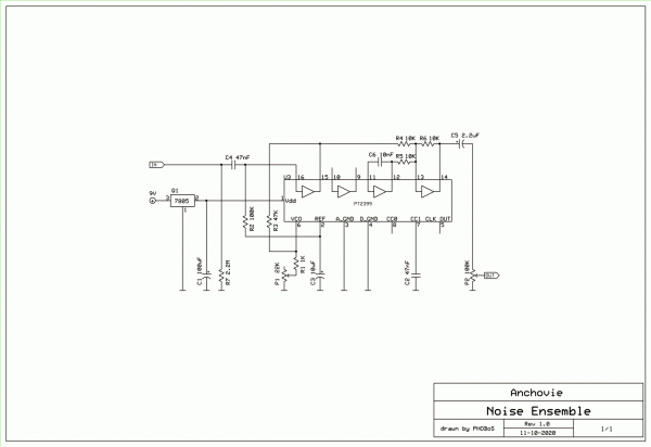

Damn son that was a read. I took in what I could but i think youre right the fuzz delay might need tweaking first its out of control and im probably being lazy. I have been trying to figure out how to tame the volume on it maybe you could help and then I can figure whats needed at the end once its sorted.
Its basically just the noise ensemble circuit:
at the moment its good volume with the pot at about 1/3 way through
edit: im actually looking to replace the vol pot with a resistor if possible, im using a 100k pot at the moment but im unsure how to do it properly, thanks
Posts: 5792
PostPosted: Sat Oct 10, 2020 4:34 pm    Post subject: Reply with quote  Mark this post and the followings unread
I drew the schematic based on that layout which has some interesting things.
C4 and C5 are the AC-coupling capacitors for in-/output.
As you can see C4 is connected to pin2 of the PT2399 with R2. Pin2 is the internal reference voltage created
by the PT2399, basically a fake ground, so the input signal is shifted up so that it fluctuates above and below that
voltage. On the output the opposite happens with C5 in combination with P2 which shifts the voltage back to
having it referenced to GND.
R4,R5,R6 set the dry/wet mix and the output level.
if R4 is smaller than R5 (or R5 larger than R4) you will get more of the dry signal
if R5 is smaller than R4 (or R4 larger than R5) you will get more of the wet signal
R6 in combination with R4/R5 sets the output level of the mix. So if you make R6 smaller (or R4/R5 larger)
it should reduce the output level.
R3 seems to be the main feature of this circuit (apart from just being a delay) as it feeds the input signal into
the VCO of the internal delay clock. This means that the input signal has an effect on the delay time. It might
be interesting to replace R3 with a potentiometer or put it in series with R3 (and make R3 smaller).
note that the ouput from P2 is not really suitable to drive a pair of headphones directly.

PostPosted: Sat Oct 10, 2020 5:58 pm    Post subject: Reply with quote  Mark this post and the followings unread
Mate youre a legend, took me ages to breadboard from verolayout schematic so much clearer. Ye I've got a basic lm386 amp driving everything to output
It goes 6 transistor oscillators into noise ensemble into filter into lm386.
Im gonna have read over all the circuit notes once i got some sleep

I was under the impression you needed some kind of passive emergency limiter to make sure the module where this was intended for wouldn’t destroy the input circuit of the following module.
All signals below the diode voltages would be undistorted, but will clip (and thus distort) when the voltages are higher than the diode voltages.
Im still waiting to get some zeners online to test, ive only got a bunch schkotty kit diodes.
Posts: 5792
PostPosted: Sun Oct 11, 2020 2:04 pm    Post subject: Reply with quote  Mark this post and the followings unread
You were right, although i never doubted it Let us pray but i brought R6 down to 500r or something like that cant remember, brought the volume right down even when the circuit is pushed its not violent on headphones. Im assuming its because the circuit is meant for guitars abysmal output?
good to hear that worked Very Happy
Personally I wouldn't go as low as 500 ohms (if that is indeed what you used) but make everything a factor 10 larger:
R4,R5 = 100K
R6 = 5K
This will reduce the current though the PT2399 might not have any problems with it, if it works it works.
But if you do want to make it battery powered it's always good to keep the current low.
It might affect the sound, maybe you'll like it better maybe you don't so just experiment with it.
Judging by the 2.2M resistor on the input (I'd reduce that to 10K..100K) it does indeed look like it's designed for a guitar.
The gain doesn't seem very high with those resistor values but the PT2399 might have some more internal gain.
I do wonder if reducing the output signal is the best idea, generally you want the signal in a chain to be as high as possible
untill the end for a better signal to noise ratio. Of course I don't know how high the signal from the PT2399 actually is.
I guess that also depends on if you want the ouput to be available or if it is only hardwired to the next circuit.
How would I go about making the vol potentiometer fixed? My brain is saying a resistor across ground and out of c5, does output just become c5?
If you want to have the signal as if the pot was turned all the way up then yes. Otherwise you'd have to replace the pot with 2 resistors.
You might not need C5 or a resistor though depending on what is happening next with the signal. You mentioned it goes into a filter
before going into a LM386. This filter might have an AC coupling cap on the input already and you probably don't need to put 2 in series.
Never been a big fan of the LM386. It's a very convenient little chip but prone to oscillations and the standard gain, which can only be
increased externally, is too high for a lot of applications.
edit: another thing im not having much luck with the classic 'starve' knob, im running it off the mains and it works 9v or 12v but ive tried all the information i can find online, its works 'best' with 10k lin and a resistor across the pot but do you have insight on a right way to do it? At the moment it just basically turns 'on' when the pot is at full instead of a smooth gradient of voltage
Success rate depends on what you try to starve. Something like a PT2399 might just shut down below a certain point.
Note that you would have to connect the starve pot after the 7805
btw if you want to experiment with diode limiting you can also use 2 LEDs in antiparallel (that is english).
floating-water
Joined: Oct 06, 2020
Posts: 62
PostPosted: Mon Oct 12, 2020 3:41 am    Post subject: Reply with quote  Mark this post and the followings unread
Well the filter is just an RC filter for now, as basic as it gets, this is just 1st version of this synth.
Thanks for the tips about the resistors, ill have a play around.
So how would you recommed wiring up the starve knob, if the oscillators are first in the circuit I guess I could just have two wires coming of the power jack? One going to the starve knob ->osc, one going to the pt99 ->amp?
What other amp ic's would you recommend for this application? There was such an abundance of info on the lm386 i just went with it
PostPosted: Mon Oct 12, 2020 6:26 am    Post subject: Reply with quote  Mark this post and the followings unread
I'm something of an ignoramus when it comes to compressors, so forgive me if this is a dumb question, but would a rack compressor do the job here? Are there hard limit compressors? (I don't know the words needed... ugh...)
Posts: 5792
PostPosted: Mon Oct 12, 2020 7:34 am    Post subject: Reply with quote  Mark this post and the followings unread
is it adjustable or does it have a fixed frequency ?
Also is it a lowpass or highpass filter and what values did you use ?
it might be possible to integrate it into the noise ensemble circuit.
yeah, just split the power from where it comes in.
For starving it sometimes has a nice effect if you add a small capacitor (experiment) to ground after the starve pot.
btw there are different ways of wiring up the starvepot, most common is to use it as a variable resistor in series with the power,
but you can also wire it up as a voltage divider. So the outer lugs to V+ and GND (might need a resistor in series) and then take the power
out from the wiper. The only difference is really that one end of the pot is connected to GND or not so you could add a switch there.
If you just want to be able to drive a pair of headphones and/or use it as a line output then an NE5532/NE5534 can work quite well like in this circuit:
http://www.hobby-circuits.com/circuits/audio/audio-amplifier/749/portable-9v-headphone-amplifier
You could also do it with a single transistor and you can find some examples here:
https://www.hackster.io/jwzumwalt/single-transistor-audio-amp-32033a
floating-water
Posts: 62
PostPosted: Tue Oct 13, 2020 2:32 am    Post subject: Reply with quote  Mark this post and the followings unread
This is where my ignorance may start to frustrate you, with the filter I've l literally just put a cap on a 50k pot, how can I make this more efficient? Continue with the passive topology for now. However I noticed placing the 'filter' before the pt99 got some wild resultsl; washes of white noise and oscillation
So with the amplifying circuit im gonna stick with the 386 for now as i have a bunch of them at hand however is there some kind of summing thing I could implement for the output so if you plug in headphones with a stereo adaptor its sums the audio into both ears, is that a thing? Looking at that schem with the NE's its using two op-amps with what looks like two inputs and a stereo jack?
Also you teased me with an LED anti parallel thing before? What is that exactly? I did a search online but the info is cacophonous
floating-water
Posts: 62
PostPosted: Tue Oct 13, 2020 9:31 am    Post subject: Reply with quote  Mark this post and the followings unread
Starve knob works perfectly now and also acts as a master pitch knob. Putting it before everything including the amplifier, therefore turning it off was probably the stupidest thing i've ever done Microsoft
Posts: 5792
PostPosted: Tue Oct 13, 2020 4:34 pm    Post subject: Reply with quote  Mark this post and the followings unread
you could have a look at this page for some filter topologies, but if you have something you like just keep it.
The advantage of integrating it into the noise ensemble would be that the signal is buffered so you don't get any further
loss in signal strength nor does it get affected by what you connect to it.
But adjustable filters are a bit more tricky to make active.
The NE5532 is amp is stereo so does indeed have a stereo input and 2 outputs. But you can simply send the same signal to both sides
of the headphones. This will place them in parallel but the impedance is usually high enough that it shouldn't be a problem.
But if you do this, don't plug in a mono jack as that will short it out. Or you could place 2 resistors in series with the outputs like I did
for the NANDulator output. (you need some lower value resistors for use with headphones)
It's the same as using 2 antiparallel diodes, so 1 diode between the signal and ground pointing one way and 1 diode pointing the other way with
a current limiting resistor in series. so like (a):
Standard silicon diodes have a forward voltage of about 0.7V so that is what it will limit the signal to in the same way as when using zenerdiodes.
LEDS are also diodes so you can use those too but they have a forward voltage somewhere between 2V and 3V depending on type and color so
the signal is clipped at a higher level. You can also put multiple diodes/LEDs in series to get a higher voltage and use different combinations for
asymmetrical clipping.
floating-water
Posts: 62
PostPosted: Thu Oct 15, 2020 3:30 pm    Post subject: Reply with quote  Mark this post and the followings unread
Appreciate all your help mate. I've ordered some NE's and some diodes to start implementing some of the lessons.
Might be a bit cheeky and not sure if its required to start a new thread but im balls deep in another project which I wouldnt mind some guidance with. It's a basic solid state guitar amp (lm386 type) and I'm trying to figure where and how I would implement a reverb circuit.
Lets say the lm386 circuit is this:
https://robrobinette.com/images/Guitar/Ruby/Ruby_Guitar_Amp_Schematic.pdf
And the reverb module id use is this:
http://www.accutronicsreverb.com/main/?skin=sub01_05_1.html
I understand the reverb needs to go before the lm386 as its a power amp, driving the speaker. However wouldn't the 386 affect the reverb? Wouldnt it distort? The reverb module will need buffering and filtering on each side of it but would that be sufficient for 'guitar -> amp with reverb -> out'. Should there be a pre amp before the reverb? Is pre amp the right circuit? Should it be boost instead?
Thanks
Posts: 5792
PostPosted: Sun Oct 18, 2020 10:17 am    Post subject: Reply with quote  Mark this post and the followings unread
Thanks
The 386 should not really have any effect on the sound apart from amplifying it.
In practise it will always color the sound somewhat but as long as the signal isn't too hot you should be ok.
Doesn't look like that reverb module needs anything else as it is already AC-coupled, has a high input impedance
and a low output impedance. Though some filtering might improve it.
According to that page the peak input voltage is 1.5V so you don't want to go above that, but at the same time keep it
as high as possible. A guitar has a rather low output signal so yes you would probably need a preamp.
