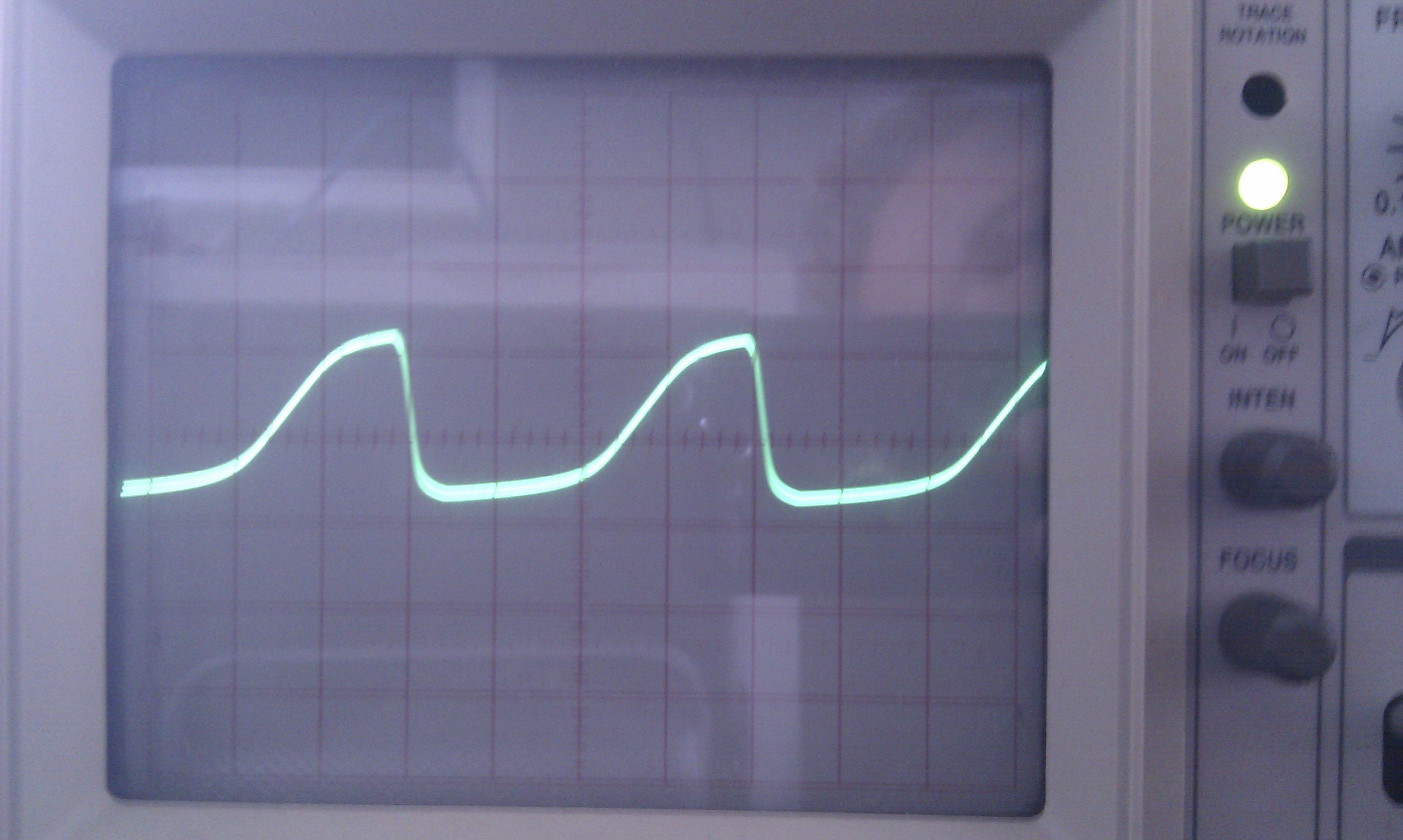

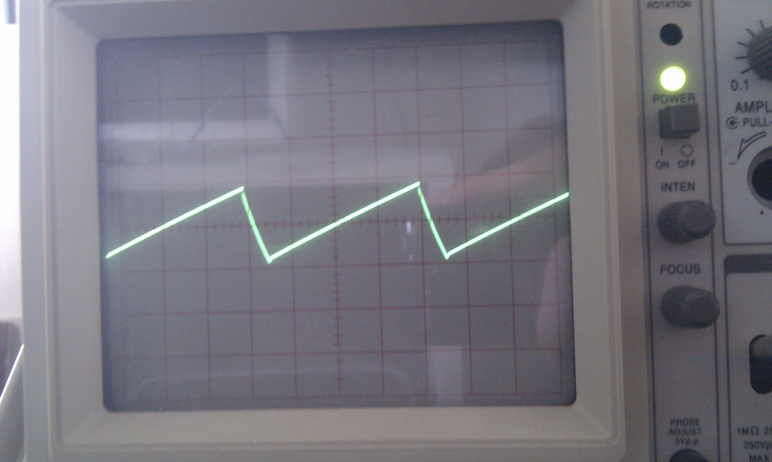

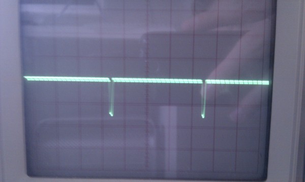

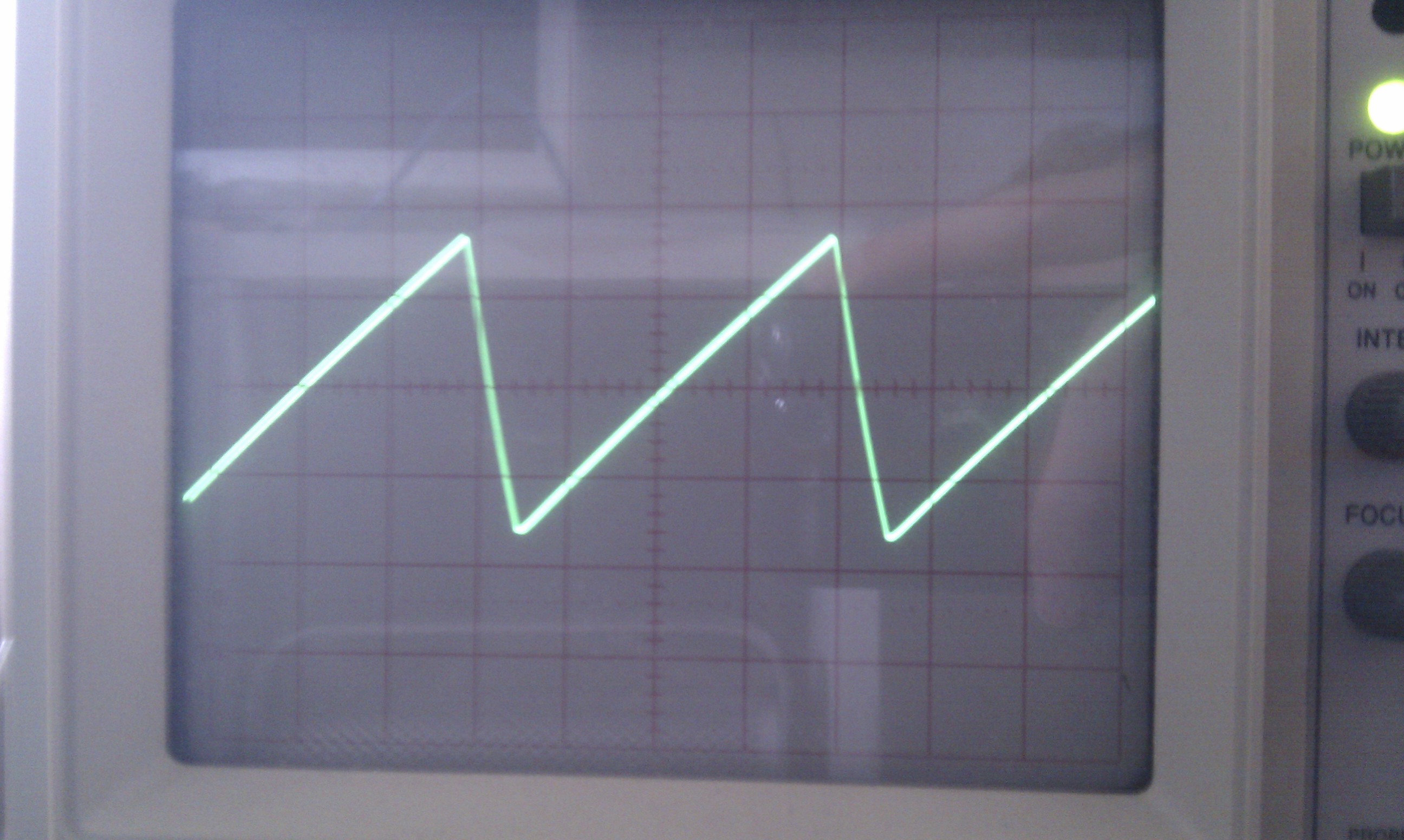

I am trying to trim my yusynth LFO, but it doesn't seem to work really well. (scope y is divided by 5v)
I've tried a lot but:
The LED is always on, it doesn't blink
The triangle looks more like a saw
Pulsewidth is varies from 0% to 10% (as you can see on the picture)
Sine doesn't really look like a sine (see picture)
what can i do?
thanks!
Saw

Triangle
 Filesize:  751.63 KB
 Viewed:  499 Time(s)
Sine
 Filesize:  764.39 KB
 Viewed:  507 Time(s)
Pulse (on maximum pulsewidth, minimum is just a flat line)
 Filesize:  763.17 KB
 Viewed:  499 Time(s)
