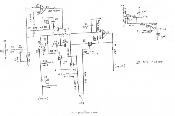

Subject description: Looking for 292 lopass gate schematic
I purchased a 292 lopass clone circuit board from Analog Haven / electricmusicstore, got the board with a link to construction notes, board layout, and front panel layout, but I don't have a schematic. There are lots of 292 lopass gate clones and schematics floating around, but I'm looking for the one specific to this board. It says "292 REV 3.0".
Picture at https://imgur.com/a/bMiTV
Build files at https://electricmusicstore.com/blogs/build/14810493-quad-lopass-gate-model-292c
Thanks, Fred.

Roman does not share schematics, it seems, weird since they are all Buchla clones, but there you go.
I've attached the schematic from: http://www.simple-answer.com/DIY.html (found using wayback machine)
