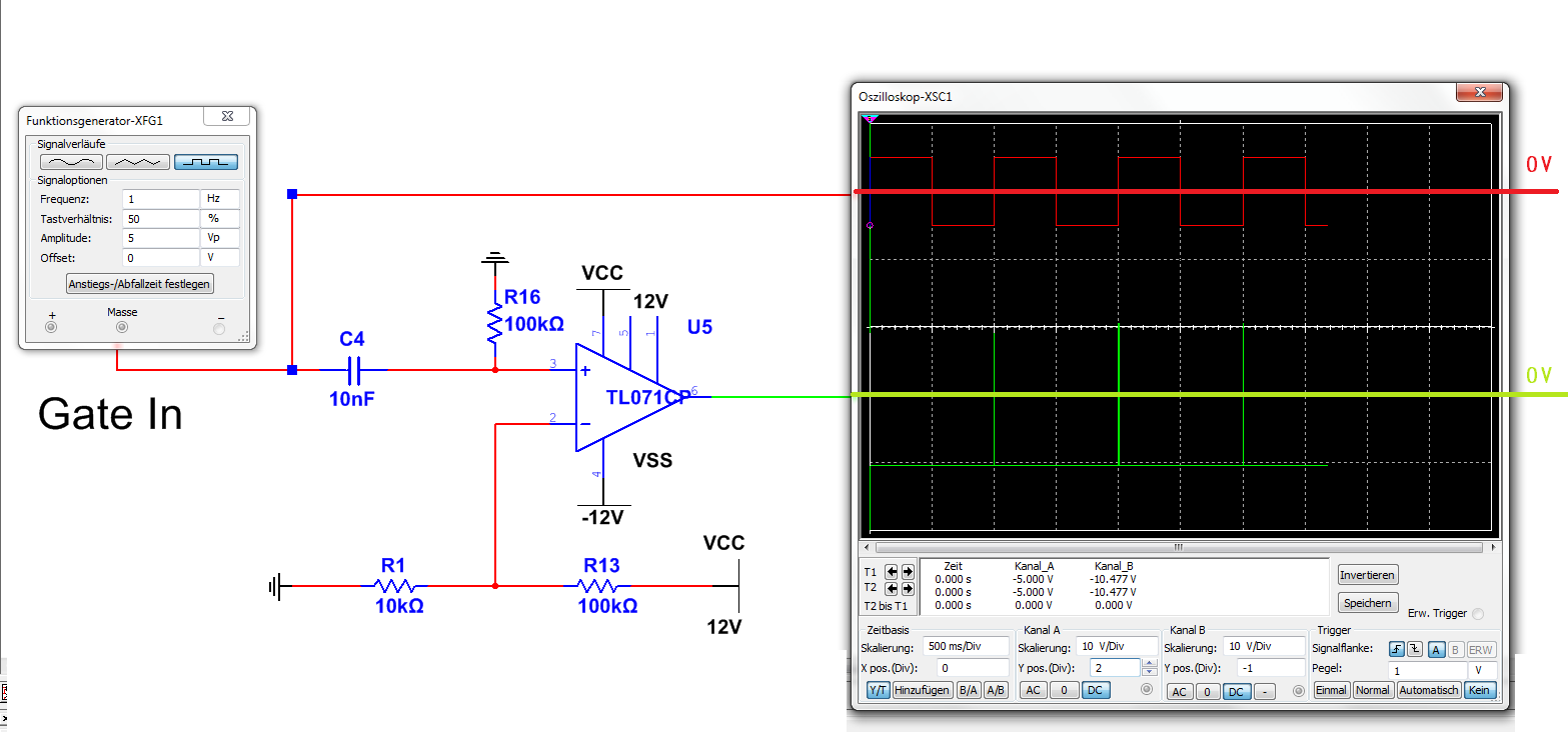

- i did a simulation for u that shows exacly what i have thought
-->it would be a good starting point to see the Gatesignal together with the output of the comparators, then we can better guess what is going on (like in the simu), i would even suggest to desolder one leg of the following doides while doing so
it dont need to be a gif, a static picture would be even more helpfull in this case, please mark also where is the zero-volt line
