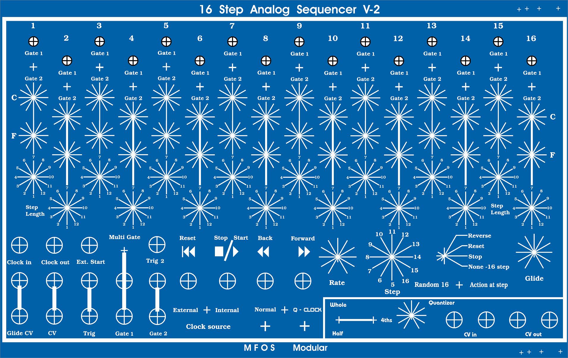

Hi all, ive been designing a panel in corel draw for a blue version of Ray's hot rod modification to the 16 step sequencer (Pontiac 455 super charged) heh Very Happy .
When i order the pcbs & wire everything up , i'll make the final adjustments to the spacings.
Really looking forward to building this one Smile .

PostPosted: Thu Jul 05, 2012 1:17 pm    Post subject: Reply with quote  Mark this post and the followings unread
As ever a great looking panel and I am sure it will make your music that much more........ Twisted Evil
If I could offer an idea or two? On my sequencer I have added a selectable voltage for the CV output. If I want full control of, say, filter cut off I can use the high voltage, CV of pitch- medium voltage range something like 0-5v etc. I know you can use an attenuator, I just prefer switchable ranges.
Secondly I have taken an alternative gate/trigger out. If I switch a step "off" I just route it to another set of outputs. Waste no want not.

thanks Ashleym , i think this will take most of the autumn to build , i've still an idea or 2 for that blank space on the right , cool idea for a 2 way switch routing the gate .

Dave- the least I could do. I used double pole switches and ran the second output off the second pole.
Ray also does a board for something similar with the 16 Step Sequencer Auxiliary GATE/LED Driver PCB that he's made for the variable step seq you are building.

PostPosted: Thu Jul 05, 2012 8:36 pm    Post subject: Reply with quote  Mark this post and the followings unread
nice panel Smile I like how you have saved some width with the offset vertical spacing
one of rays quantizers in that
space to the lower right might be nice.

Thanks Diablojoy , i have 2 of Rays quantisers im thinking of re-housing soon Smile heh.

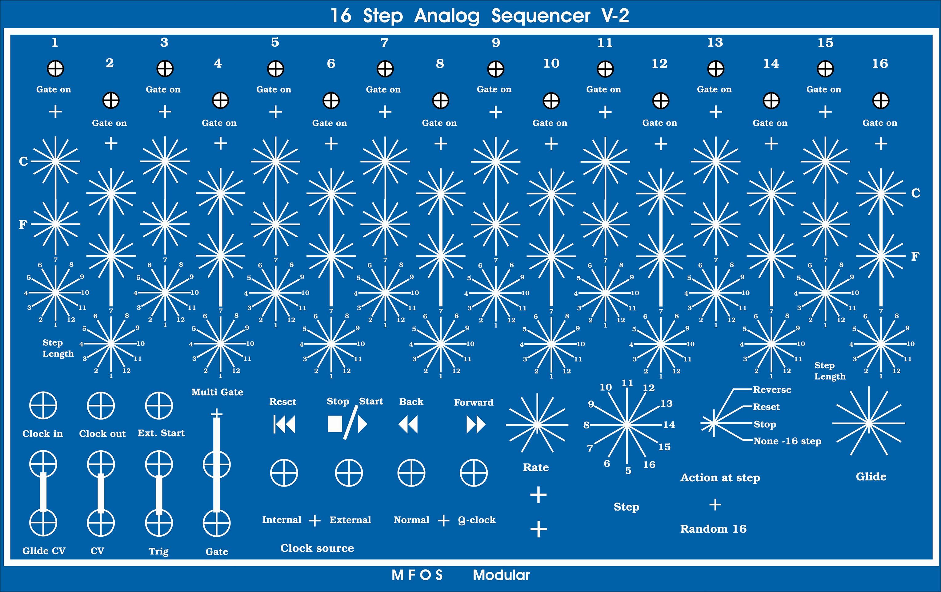

updated panel design for new 2nd gate & mfos quantizer in corner Smile
Dave.

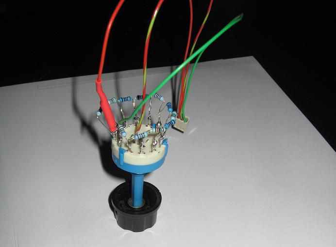

having temp hooked up the step 1 length pot, i first calibrated the pot action with the on pcb trimmer as Ray describes in the docs, then i turned the pot back to ground or 1 length position and measured the resistance at each change (solid lit led's) .
My pot is a 100K (measured - 102K ) .
At the last or 12th switch pole , my totalled resistance was 90K , i need a 12K resistor between the last position & +12V to make up the rest of the test pot travel.
So here are my results , yours will entirely depend on how you set your trimmer up to begin with.
Diagram of the 12 pole switch laid out flat with resistors between poles & a pic of the 12 way switch ( 1 of 16) to make , the heatshrink covers the 12K res.
more in a week or so , thanks for looking in Smile.

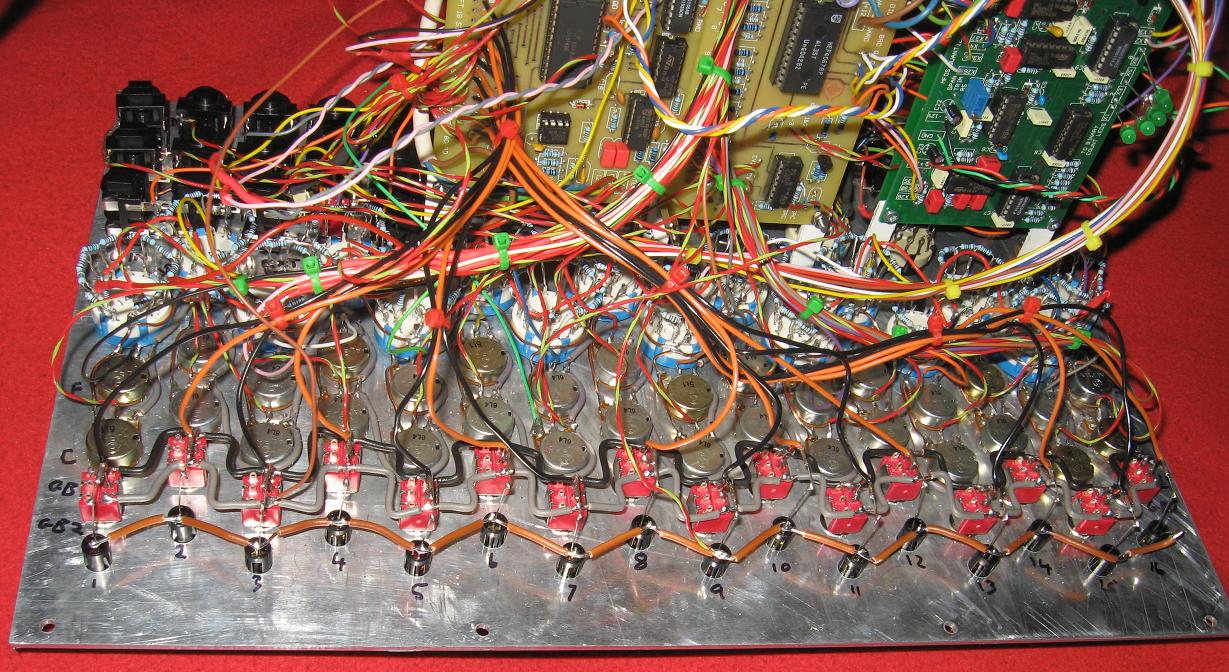

PostPosted: Sun Oct 14, 2012 6:00 am    Post subject: Reply with quote  Mark this post and the followings unread
Hi there , still working on this , deciding not to rush it since it's a bit more complicated with my old V1 (2005) seq boards with the mods to upgrade to V2(2008/9).
Here's a quick pic of the back of the panel , progress so far Smile , i had to listen to some early Erasure albums to keep a happy vibe love when soldering those 16 rotary sw's & resistors (the thought of it after work Sad )
On the home straight now, wiring & some toggles to fit.
Dave.

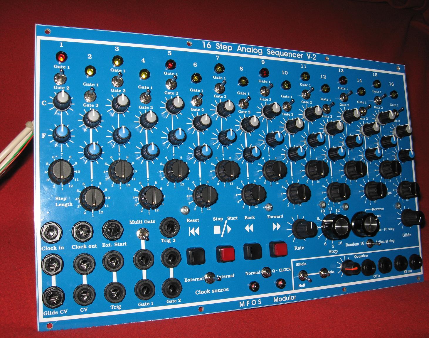

Almost there now , wired up , quick test and found some pots working back to front , heh , those to sort & tidy the cables up with some ties , i'll give it a good test at the weekend when i screw it back into the modular (there has been a draughty space in the modular for 3 months Very Happy )
A pic of the back end and a couple of the front , i'm taking a wee rest from synth wiring for a few weeks after it's all working Smile
Dave.

PostPosted: Wed Oct 17, 2012 1:59 pm    Post subject: Reply with quote  Mark this post and the followings unread
Nice. Nice. Nice
Quite a dense panel but it all looks like it works well.

PostPosted: Wed Oct 17, 2012 9:22 pm    Post subject: Reply with quote  Mark this post and the followings unread
Hi Dave
build is looking good
quick question
what is the overall size of your panel ?
I have 2 to do on my list and with a feature set exactly the same as your build so your panel layout looks like a good point to work from.
