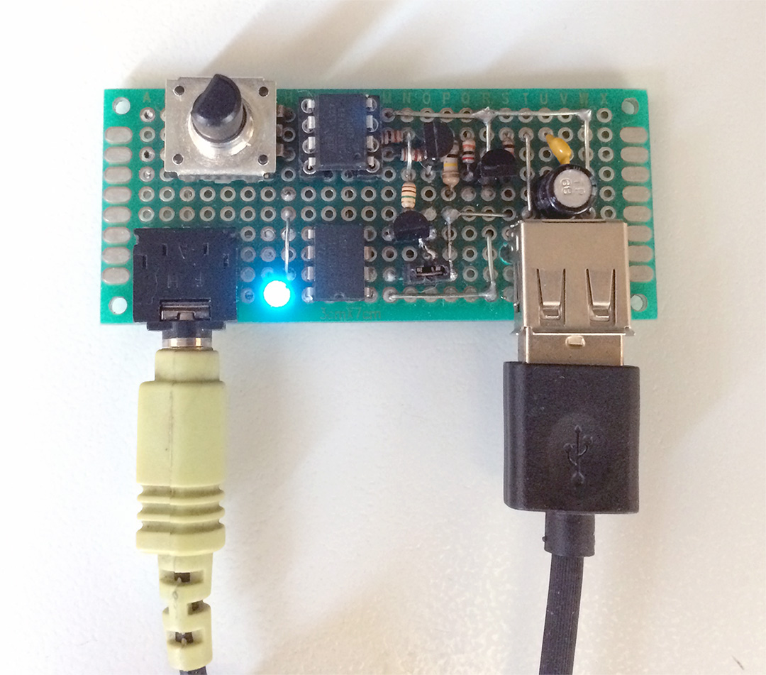

Hello!
This is RhythmMaster 85S (S mean simplified) device. It makes hi-hat and snare beats out of white noise generated by TL-431.
Full version have external clock source and bass drum generator with sidechaining feature. Still in progress.
1. When you will turn on this device, you will hear white noise with periodic scratches. If you do not hear the scratches, just wait until ATTiny85 will warm up or cold down.
2. Turn the knob, it will change beats.
3. Push the buttont once, it will change knob mode. In this mode turn the knob, it will change decay.
4. Push the button, hold it and turn the knob, it will change tempo.
Code: https://github.com/youcantignoremytechno/RhythmMaster_85S

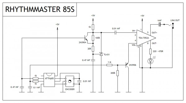

RhythmMaster 85S circuit diagram

PostPosted: Wed Jun 13, 2018 5:55 am    Post subject: Reply with quote  Mark this post and the followings unread
Hidiho Hammer,
wich transistor is right 2x 3904 npn or 2x3906 pnp
in your schematic you have 1 x3904 and 1x3906
but the symbol is for 2 x3906
thanks
StormB
Hammer
Joined: Mar 13, 2018
Posts: 72
Location: Russia, Zhukovsky
PostPosted: Wed Jun 13, 2018 6:53 am    Post subject: Reply with quote  Mark this post and the followings unread
Sorry for mistake! I've update circuit diagram.
Left - 2N3904 NPN, Right - 2N3906 PNP

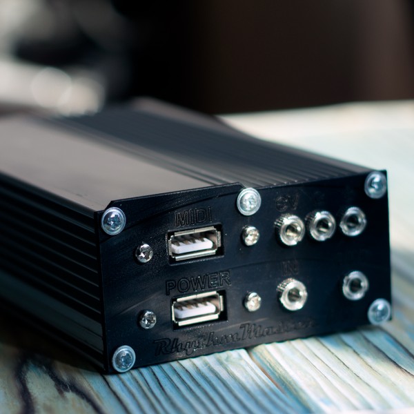

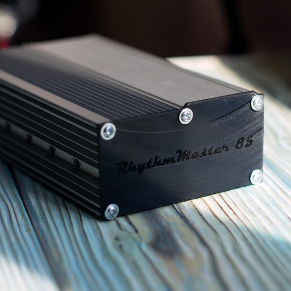

I've used for tom/kick Wien bridge based oscillator. I'ts working great with 4069. Only sidechaining part of the main circuit still isn't ready.
But I started to make case out of e-bike controller box. Sides are laser cutted vinyl.

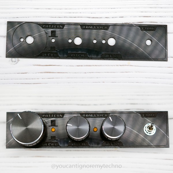

Face deck

great idea with the lasercut vinyl Very Happy
sounds good too.
Hammer
Posts: 72
PostPosted: Sun Jul 22, 2018 9:06 am    Post subject: Reply with quote  Mark this post and the followings unread
Thank you, PHOBoS!
A lot of interesting stuff could be cutted out of vinyl: https://www.instagram.com/youcantignoremytechno/
But it's not easy beacuse of releasing chlorine and condensating hydrochloric acid. CNC should be very good oiled, smoke should not stay in the room. Otherwise everything will be covered by rust.

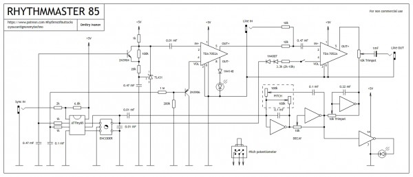

New code: https://github.com/youcantignoremytechno/RhythmMaster_85
New circuit:
 Filesize:  194.44 KB
 Viewed:  599 Time(s)
