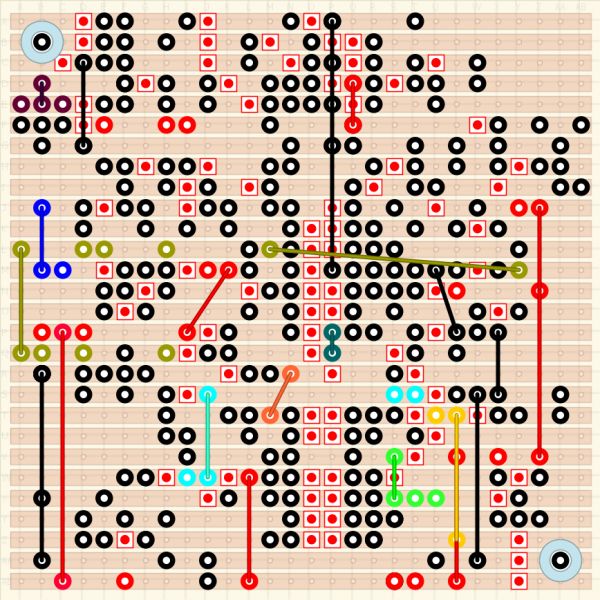

WARNING! All layouts in this thread contain errors and mistakes and neither of them is final. Once I build the unit I will be able to make a correct layout, but until then if you wish to build this keep an eye open for mistakes and check everything. Thanks:)
Ok, so this is what I came up with. I know that it's insanely crowded and it'll be a pain to build it, but I need to fit it in a box I have. It's area (2,9 x 2,9 inch ~ 7,3 x 7,3 cm) is like the half of Ray's PCB, so I'm a bit worried about crosstalk but I hope it's gonna be all right.
I'm also sorry about the crazy jumpering, but I couldn't find a better way to connect C13 and C14 (virtual ground) and also I think sockets (or plain IC-s) have the space under them for wires (for BN bus and X16 connection). Also if you can't connect two jumper wires into the same hole you may have to find a solution yourself, sorry about that.
Also note the legs of Q3, Q8 and Q9 - they are bent a bit.
I checked it a few times but of course there might be mistakes (it's very likely).
I created it using diy layout creator (http://diylc.org/) and I'm attaching the layout file too, so you can redesign, change or correct it if it's necessary.
I'm still waiting for components, so I can't verify that it's working (probably till the middle of April), but if you have the courage, try and build it:)
And of course if anyone spots any mistake, or has any comments, please say it. It's my first stripboard desing, so I know it could be done better (like less crowded Smile)
cheers!

PostPosted: Mon Apr 15, 2013 4:50 am    Post subject: Reply with quote  Mark this post and the followings unread
I've finished soldering in the jumpers, resistors and IC sockets and I spotted a few errors. Firstly, I forgot to put R16 on the stripboard layout (its between Q3 collector and BP). Luckily there's space for it (there's a hole between Q3-C and C1, and just under that stripe there's BP), but it has to stand. The other mistake is that C21 is a non-polarized electrolytic cap but I drew it as a ceramic.
Anyway the resistors fit in nicely, though a few has to stand. But you can use 1/8W resistors (except maybe for the ones <1k) and then it's less crowded.

PostPosted: Tue Apr 16, 2013 7:02 pm    Post subject: Re: noise toaster stripboard Reply with quote  Mark this post and the followings unread
;Mr. Bence... in your stripboard post you said
bence wrote:
edit, ps: In Ray's PCB the big electrolytic caps have 0,2" lead spacing, but mine are all 0,1", so I designed for them. Also note that legs of C14, C19 and C29 are not in adjacent lugs.
I have looked at your SB layout multiple times and for the life of me can't see C29. Am I C29 blind or did you mean something else? Hoping for the latter.......

Looking at the MFOS schematics and BOM, the capacitors only go up to 26, so I think C29 should say C26. Even if you add Ray's 2 additional external inputs, that only adds one 0.1uF capacitor. I can't find C17 on the stripboard layout, but that's possibly because it can be wired directly across S7.
Gary
EDIT
Just looked at the panel wiring diagram and C17 is indeed wired across S7!

PostPosted: Wed Apr 17, 2013 2:17 pm    Post subject: Reply with quote  Mark this post and the followings unread
Sorry guys, I meant C25 instead of C29. C26's legs are in adjacent lugs.

PostPosted: Tue Apr 23, 2013 7:59 pm    Post subject: Reply with quote  Mark this post and the followings unread
I'm new to this, so this may be a stupid observation. But, I've been trying to troubleshoot a breadboard layout of just the expo converter and the VCO, when I came across this post. I've been looking at your layout and noticed a few things
Pin 3 of IC1 doesn't seem to connect to the virtual ground.
Pin 11 of IC 1 doesn't seem to be connected to BN.
These observations may be a result of my own ignorance, so if I'm confused, please let me know.

PostPosted: Wed Apr 24, 2013 12:37 am    Post subject: Reply with quote  Mark this post and the followings unread
Hello and thanks for the feedback:)
IC1 pin3 is connected to pin12, and therefore virtual ground, because the strip there under the IC is not broken (check it on the last pic).
However you are right about pin11, I did mess that up (and there's no space for correcting it nicely) Sad
I reorganized that part of the layout a few times and I must have forgot to place that link again..
Thanks for noticing it, I wonder how many other serious mistakes are still there. And sorry for the low quality :/

PostPosted: Wed Apr 24, 2013 8:21 pm    Post subject: Reply with quote  Mark this post and the followings unread
I totally ignored the pic showing the broken links under the chips. Glad I at least provided some useful input! I still can't get my breadboarded expo converter and VCO to work...

Nardu wrote:
- Here is the stripboard layout in Lochmaster using a H25SR050 stripboard (2x4 inch)
- Still working. Mising: Q10,R57,R61,R62,X21,X22. If I fail, I will use a H25SR075 stripboard.
Hi Nardu
After this time I am not sure if you can recall but your design looks good and I'm wondering whether you implemented with those missing items, or alternatively what your solution was?
Thanks in advance!
