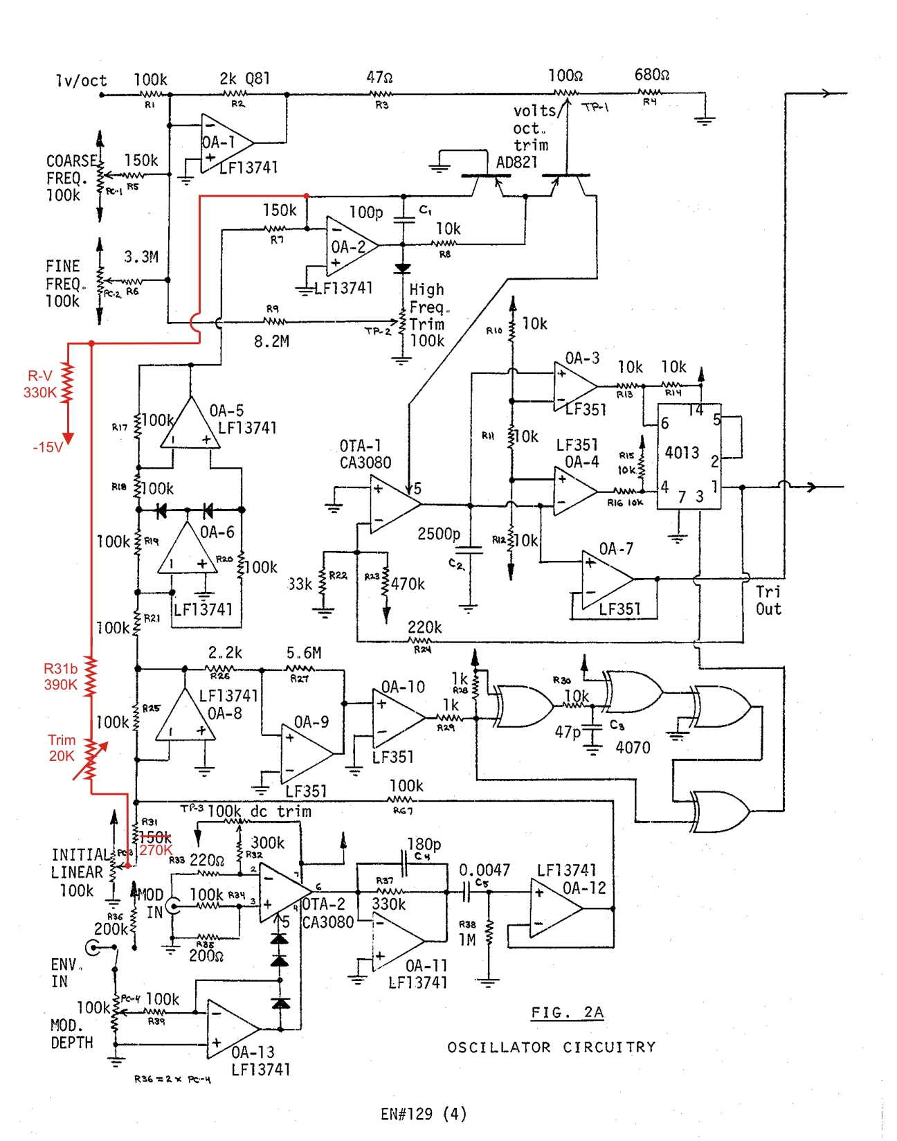

I realized that if I want to modify the Thru Zero depth (using the initial linear knob) It also modifies the frequency of the VCO, as Mr. Hutchins explains at the end of the article. He also proposes a complicated way to avoid that (using a second exponential converter).
After thinking about it I came with a simple solution: to substract the voltage at the Initial Linear pot to the voltage that sets the VCO's reference current).
The MOD worked perfectly at first time.
The only trimming needed is to adjust the 20K trimm to null any pitch variation when moving the Initial Linear pot.

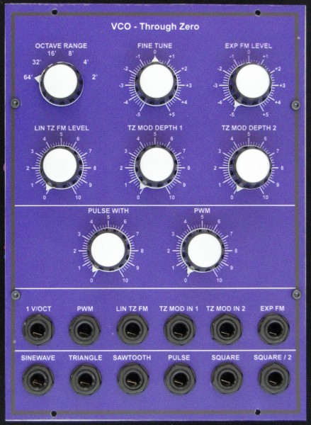

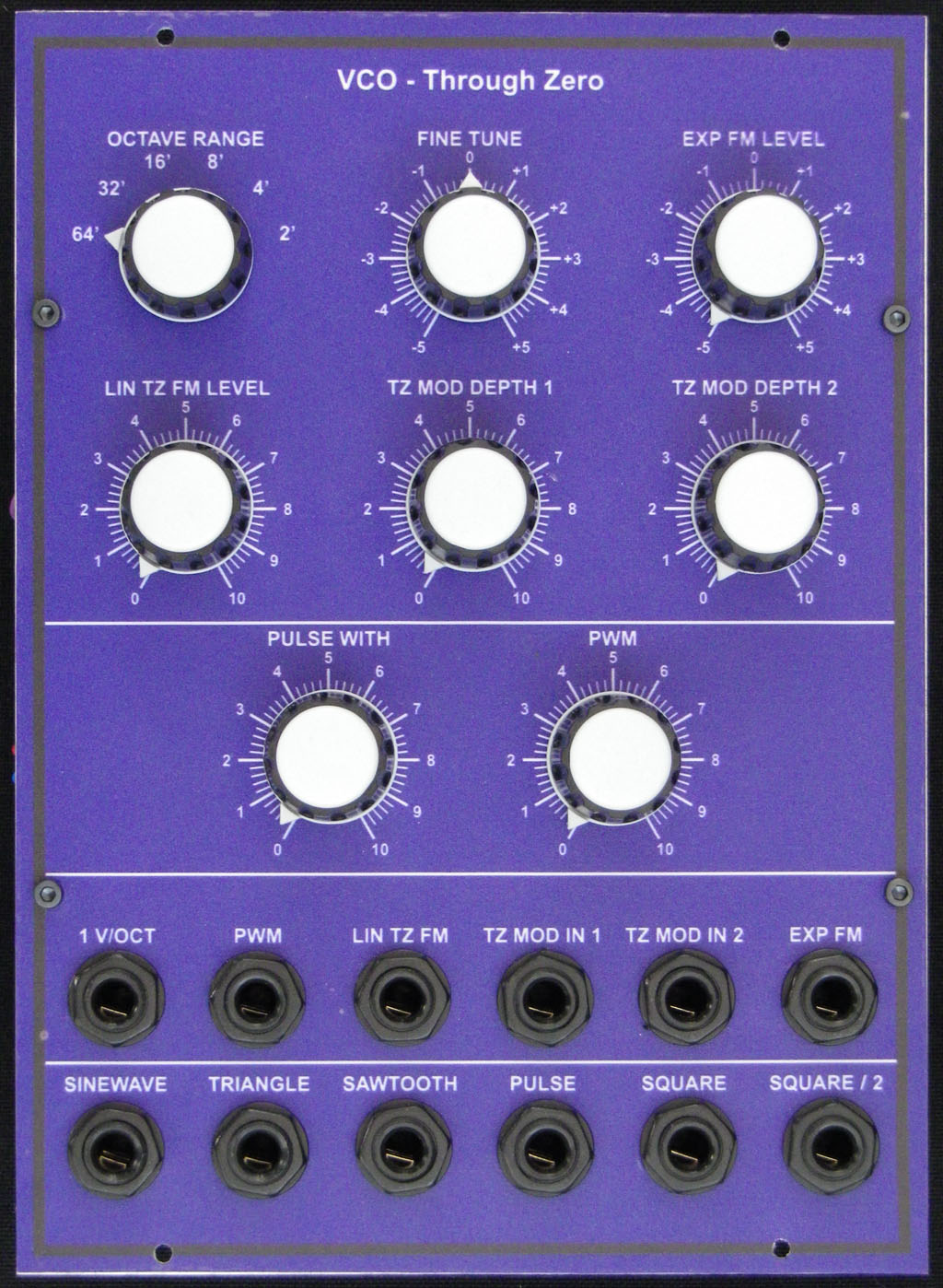

Also I'm posting a picture of the module (there are some errors in the labeling, as I did the panel before building the circuit).
 Filesize:  232.44 KB
 Viewed:  736 Time(s)
 Filesize:  290.97 KB
 Viewed:  728 Time(s)
 Filesize:  499.52 KB
 Viewed:  1081 Time(s)

1. In the schema of your mod the 20K trimmer connects on one side to the Initial Linear pot wiper and on the other via a 390K (R31b) resistor,
a. to – in of OA-2 and one side of R7, 150K resistor and
b. to -15V via an additional 330K resistor.
The above is quite straight forward and clear.
What confuses me is that on your published, finished, PCB one side of the trimmer seems connected, via the red cable, directly to the -15V connected on the Fine tuning Pot, while the other, via the purple cable, I assume is connected to the Int. Lin. Pot wiper.
Q1. Do you use only the trimmer or the rest of the components are hidden under the PCB?
2. In your solution as shown on the back of your panel and demonstrated in your very nice video, you have replaced the coarse pot with a multi-position switch, plus an ic and a trimmer and…, which facilitates the octave stepping.
Q2. Has this any relation with my first question? Could you please post the schema of your final mods?
Many thanks for your attention

Q1 - The resistors are under the PCB. I drilled extra holes for the trimpot and wires, and soldered the resistors to the trimpot, and then the wires to the resistors.
Q2 - I replaced the coarse tune pot with an octave selector as I did in all my VCOs. This mod is not related to the previous mod. I didn't mention this mod as it is a very common mod. Just a simply voltaje divider made with selected 10K resistors conected to a rotary switch, a trimpot for fine-tune and a buffer. There are a lot of octave selector circuits around, but if you like a could post mine...
