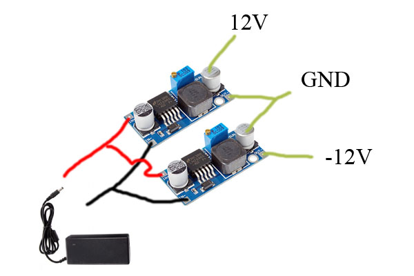

I had the idea the past month while designing my first modular and I thought it could be uselful for some people around.
You know that LM2596 Buck Step-down converters that are at 1USD in ebay:
The idea is simple. Feed two with a power supply that is at least 15V and have quite juice. A spare laptop adapter, around 18-19V is ideal.
Regulate both outs to get 12V in each converter. Join one positive out with the negative of the other. This is our GND. The free positive is the +12 and the free negative is the -12.
You can regulate them for +/-15V +/-9V if it´s what you need.
Put a bank of electrolitic capacitors on both outs. Two 3300uF of at least 16V should work.
Quirks
The LM2596´s works in the 150KHz range, but this ones shows ripples in the 50KHz area. Obviously they are fakes, I suspect they are discarded or fakes LM2576 witch operates precisely in the 50KHz area.
After some tests normally you can load it until 2A. They get warm/hot, but keep working nicely. That should be the absolute maximum. You may not use more than 750mA per rail to be in the safe side and mostly using homemade/cheap modules. You don´t want to fry an expensive one in case the converter blows and let the 19v flow intact. Be ultra careful with that. This is an experimental idea from a newbie hobbist-me- that could not work properly.
Also, remember to put heatsinks if the converters get warm/hot
The ripple is there, but it´s usable and filtrable. To filter it you need an oscilloscope- that I hadn´t yet- some ceramic caps and ferrite tubes. A homemade ferrite with 7 loops of transformer wire can do the trick.
This guy get stellar results filtering LM2596´s with this technique:
https://www.youtube.com/watch?v=h9xU1K2bqrI&t=0s&list=LLayLziN5aF2KjyYGsomq0Iw&index=31
(the filtering magic starts at around 4min of the video)
If someone has a good oscilloscope and wants to try it would be fantastic.
Remember to load the circuit to test it!
Crude scheme. Lacks the caps bank at the end of both rails

Not being familiar with that regulator, does that have floating or isolated outputs? If so, that yeah that will work.

Not really sure what you mean. The negative input and output are directly connected, if it´s what you mean. The regulation happens in the positive rail.
Does it means it´s floating type?. Should this be a problem?
Posts: 24488
PostPosted: Mon Jun 18, 2018 12:51 pm    Post subject: Reply with quote  Mark this post and the followings unread
MapacheRaper wrote:
[...]The negative input and output are directly connected[...]
This means that with your circuit proposal you create a short circuit (just follow the wires ... ), so this will not work unfortunately.

Damn!
So it was too good to be true. Now Im guessing if you can put some diodes (not sure if before the output or after) to isolate the circuit.
Any ideas on how to isolate it and render it usable would be most welcome.
Thanks for pointing at the error! salut

You could try using two regulators, and TWO dc power supplies.
But by then, you may as well just use two decent 12VDC wallwart power supplies, some filtering, and not bother with these modules.

Yeah well .. or use a transformer with a mid tap, four diodes in a bridge and two fat caps.
Can not find an example with one bridge, but basically it would be a combination of :

Yeah, I have spent some good hours trying to find some loophole to feed it from only one DC source, but seems like it´s contranatura. Diodes don´t work and there seems to not exist a negative counterparty to the LM2575 that insulates the negative rail.
In fact I have a centertapped transformer coming home, that I will adjust with LM317 and LM337, the typical suspects. This is for my main and first Euro setup and I want it as clean as possible.
The idea of this thread was to recycle a laptop brickwall- that all people has some spare- and use the LM2595 chinese modules to get the most cheap possible power supply. (And playing with the filtering stage to tame decently)
In fact after crunching some offers in ebay, is way more cheap to buy 2x 15v 2A brickwalls than a CT transformer, but this is more elegant, for sure.

Actually .. I once had a PSU built like that .. with two positive regulators to make a dual supply ...and had forgotten about it..
elektrouwe
Joined: May 27, 2012
Posts: 146
PostPosted: Thu Feb 21, 2019 4:02 pm    Post subject: Reply with quote  Mark this post and the followings unread
sorry, but I see many false statements in this thread and the nice looking
noizoid page is full of "alternative facts"
I tried to discuss it here ( with no response from the author):
https://www.muffwiggler.com/forum/topic-212318.html
