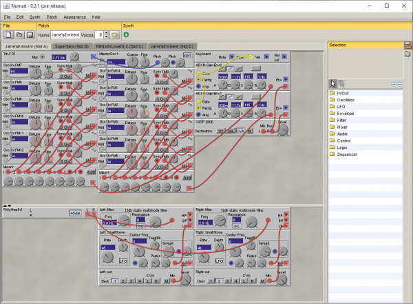

I did a first build of an older version (0.2.1-pre) from source.
I had some difficulties to get the 0.3.2 version to compile, but I will try this next time. Things changed in Java since 2006 Wink
Also I will try it to work with OpenJDK. Although (Oracle) JDK can be used for free when used personally, it might be that some of us make a living of making music and that it will considered 'production'.
