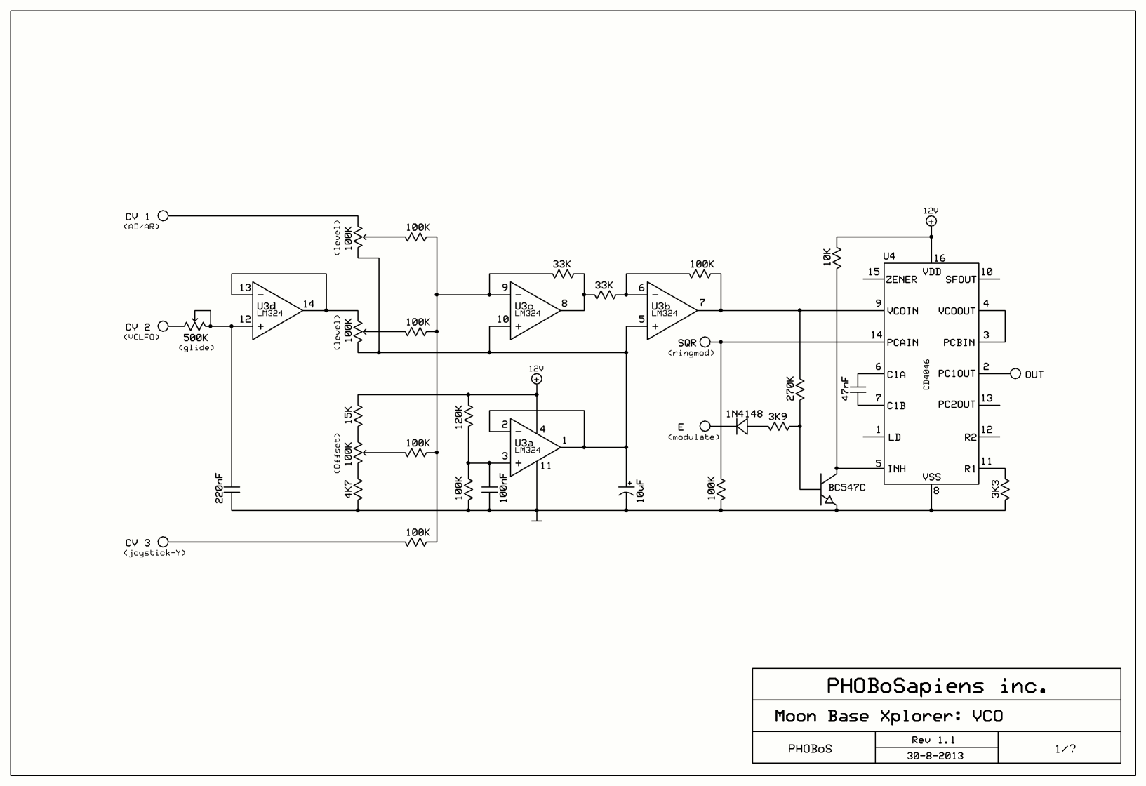

PostPosted: Sat Sep 07, 2013 11:58 am    Post subject: the Moon Base Xplorer
Subject description: yet another synth thingy
I still have to finish up another synth (and that isn't the only thing Embarassed), but that's just programming at the moment which I get bored
with rather quick, and my hands started to itch to build something.
One thing I've been wanting to make for a while is a synth dedicated for space/sci-fi sounds: lasers, rayguns, meteors etc.
A basic "space" sound can be created by modulating an oscillator with an LFO and sweeping it up/down, with some delay added. So that was my
starting point.
First I made the main VCO using a 4046. (I love that chip!).
I wanted 4 CV inputs:
- 1 for main frequency/offset control
- 1 for sweeps controlled by an AD/AR
- 1 for LFO modulation
- 1 for a joystick Cool
So I created a DC mixer using 3 opamps, which works a lot better then I expected on a single supply. 1 opamp is used to create a buffered fake
GND and I added a pot + capacitor for a glide effect (great for raygun sounds), buffered by another opamp.
But there was something that I didn't really like. With the lowest CV input the VCO acts as an LFO resulting in a clicking sound. So I started thinking,
"can I just turn the VCO off if the CV input drops below a certain voltage ?" well turning the VCO on/off is simple because it has an inhibit pin, I
just needed to do at it a certain voltage. The best way would probably be to use a comparator or at least use a schmitt trigger, but I didn't want to
add another chip. So instead I just used a single transistor. It does have the effect that right at the switching level the VCO starts to buzz. But that's
just a bonus feature. Wink
I also added an external modulation input (sounds different then CV modulation) and an input for ringmodulation. (for nice metallic sounds).
more to come,..
Moon Base Xplorer: VCO
 Filesize:  63.62 KB
 Viewed:  1914 Time(s)

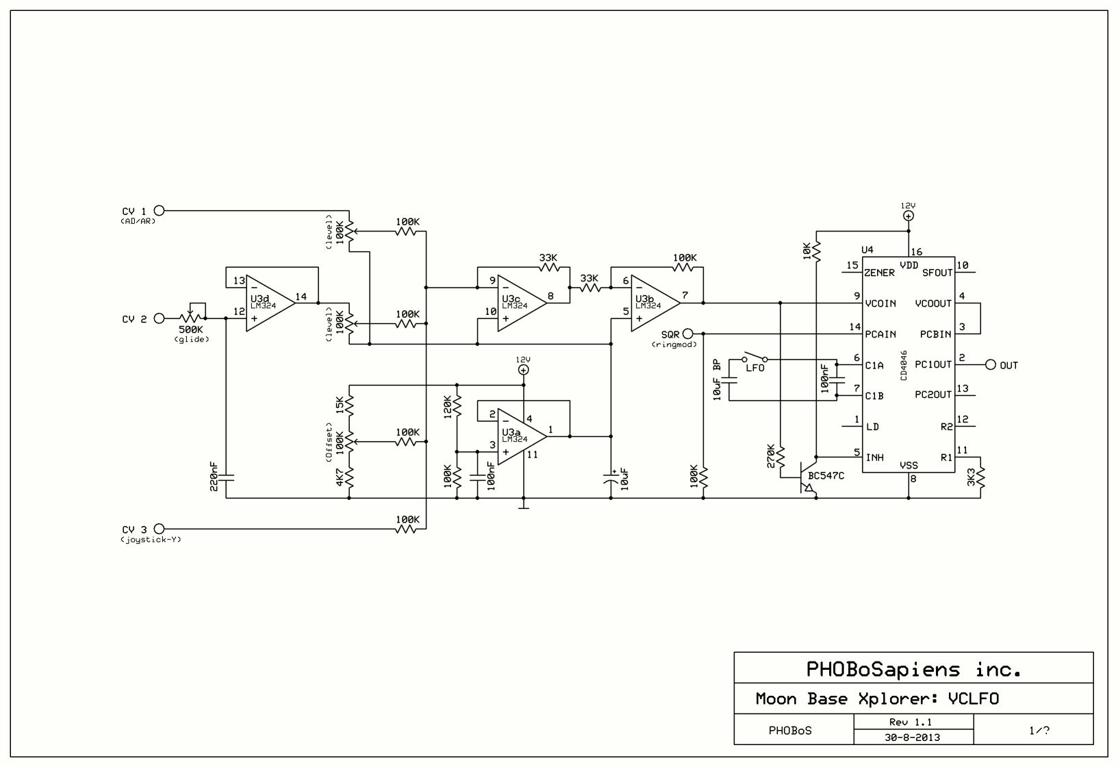

To modulate the VCO I need an LFO but it would be nice if I can sweep that one too. So I used the same circuit as the VCO but with a bigger capacitor.
When the switch is closed it works as an LFO, but it can also oscillate at audio frequencies, which is very nice in combination with the XOR input on the VCO.
I left out the input to modulate it using the inhibited pin on this one.

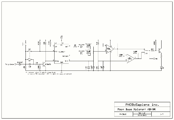

Posts: 5888
PostPosted: Sat Sep 07, 2013 1:07 pm    Post subject: The Moon Base Xplorer
Subject description: AD/AR generator

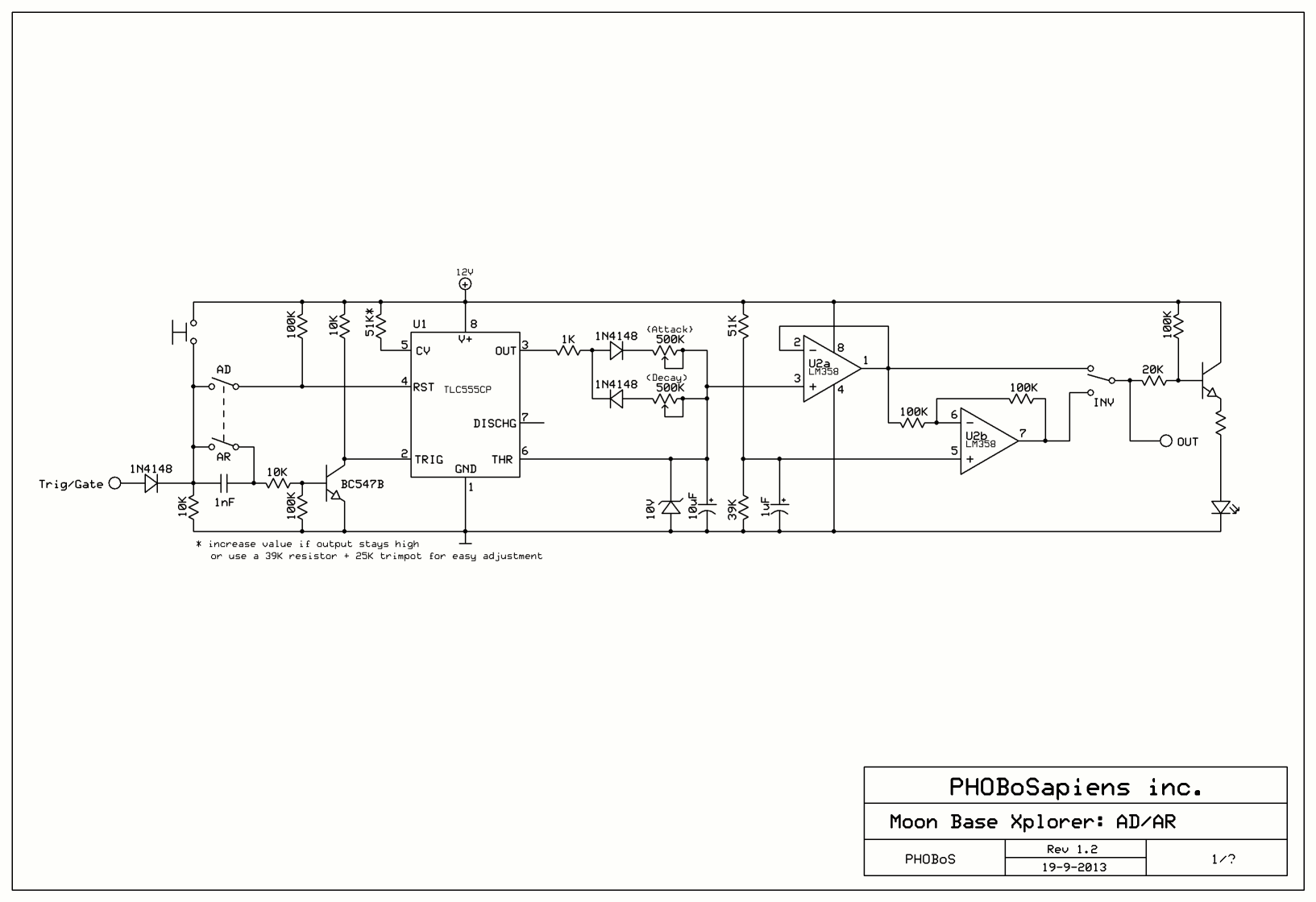

As mentioned I'm using an AD/AR generator to create sweeps, or actually 2 of them. The circuit is similar to the one I used in the Lun-A-Key and the
other synth I'm working on.
For this synth the CV range I'm using is 1...10V. I can't get to 0V because of the LM358 and the CD4046 cuts out at about 0.9V anyway. With a +12V
supply the 555 will only charge the capacitor to about 8V (2/3 x Vdd) before it discharges it (in AD mode). But I wanted 10V, which I could have
done with the opamps, instead I just raised the treshold level by adding a pullup resistor to the CV input (pin 5). To make sure the voltage doesn't
rise above 10V (in AR mode) I added a zenerdiode. I used the spare opamp to add an inverted output aswell.
The levels (treshold/limit) are very close together, I've build 2 of these and while 1 worked with a 47K pullup resistor the other one still didn't
work with a 51K resistor. (solved it by adding a 1M pulldow resistor aswell). So it would probably be wise to use a trimpot instead.
Also the gate/trigger input needs to be connected, else it will trigger itself (and stay high) when switched to AR mode. But this can be 'fixed' by
adding a 10K pulldown resistor to the input.
Moon Base Xplorer: AD/AR generator
 Filesize:  45.44 KB
 Viewed:  1697 Time(s)

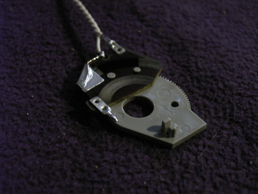

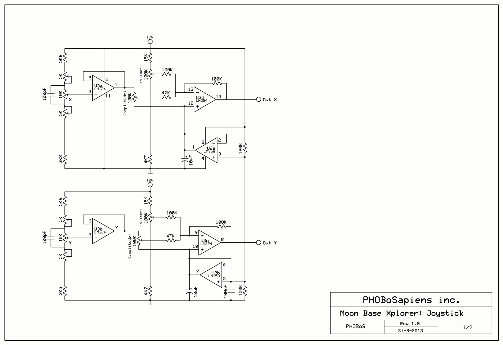

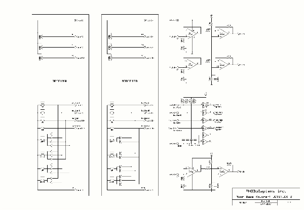

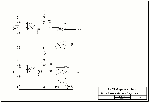

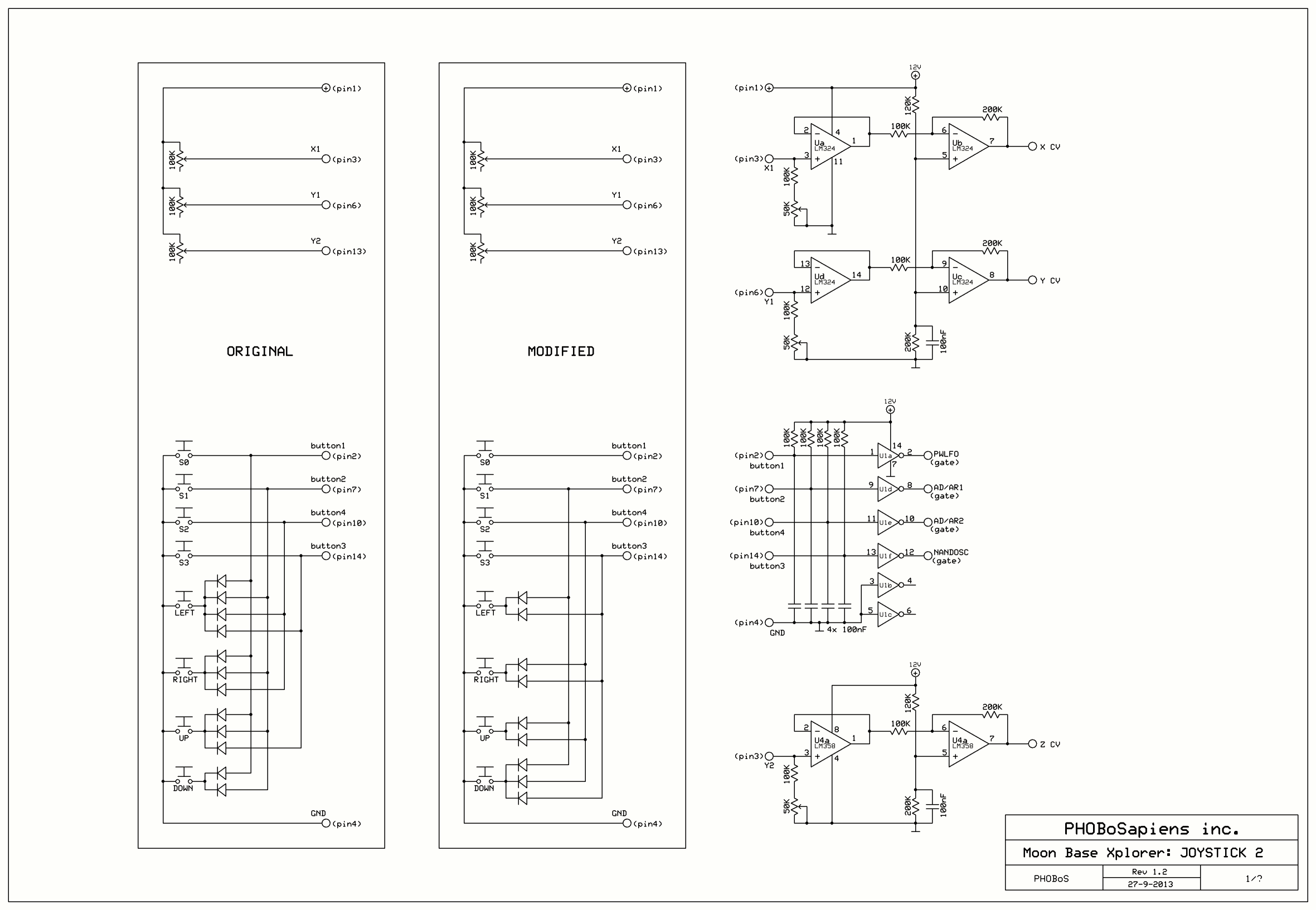

Posts: 5888
PostPosted: Sat Sep 07, 2013 1:56 pm    Post subject: The Moon Base Xplorer
Subject description: joystick controller
I added a joystick to give it a genuine spacehip control, So I can feel like flying through space going into warpdrive, avoiding meteors and shooting
at evil aliens with my raygun (not the good aliens of course).

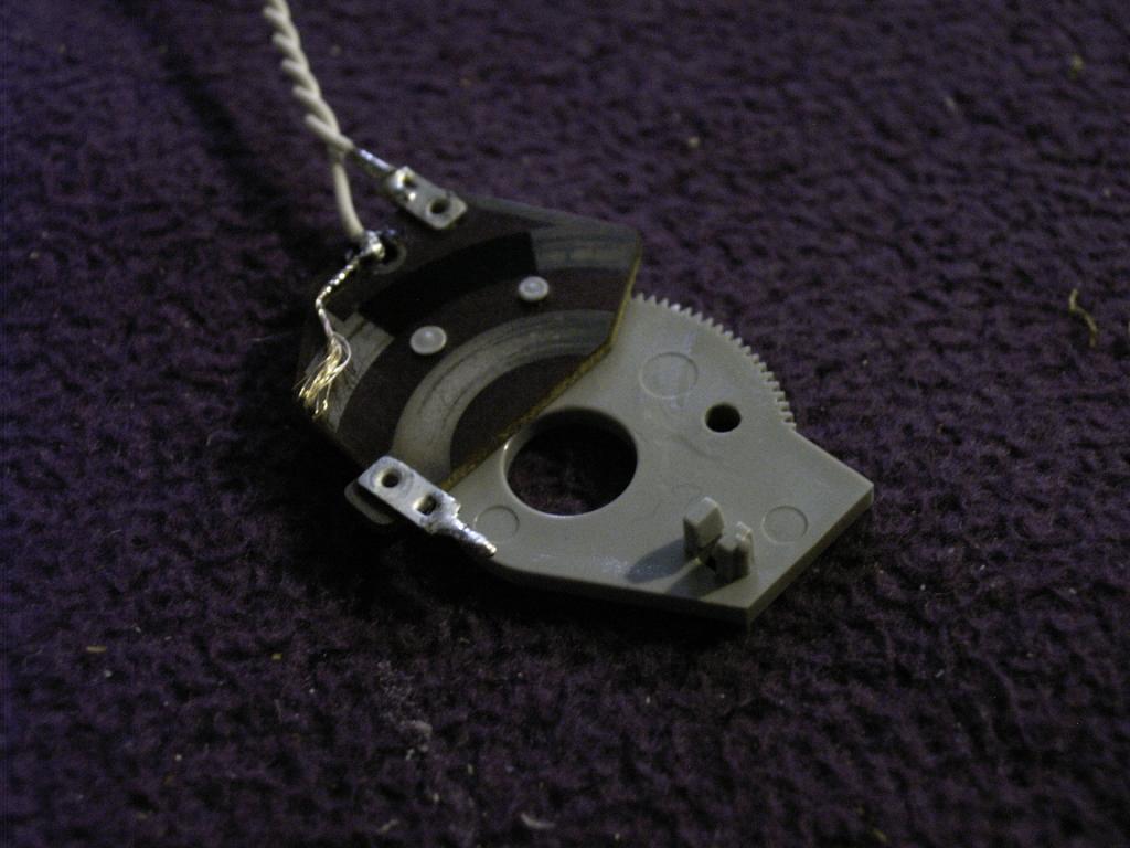

Well actually I just had this little joystick laying around (the type that's used on gamepads) so might aswell use it for something and this seemed
like a good project for it. Originally it had a spring so it returned to it's center position but I removed that a while back. Resistance wise it still
has a center position so there is a small 'dead' spot where it's resistance doesn't change.
The circuit I used is very basic. a CV mixer with a level control for the joystick and an offset control, for both X and Y axis. The trimpots around
the joystick pots are used to set the min/max levels right since I noticed quite a tolerance in the 2 pots.
Beacuse I have it hardwired to the VCO and VCLFO I don't need the offset pots, so I'll probably repace those with trimpots.
(I went a bit overboard with using 2 opamps for the fakeground but I didn't want to waste 1 Embarassed )
Moon Base Xplorer: Joystick Controller
 Filesize:  59.24 KB
 Viewed:  1286 Time(s)

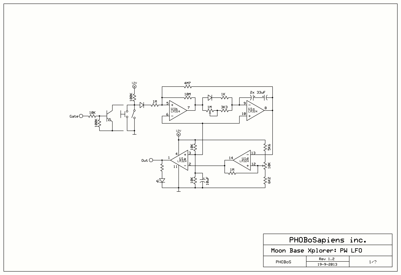

Posts: 5888
PostPosted: Sun Sep 08, 2013 1:58 pm    Post subject: The Moon Base Xplorer
Subject description: LFO width pulse width control

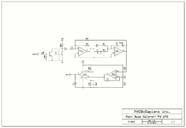

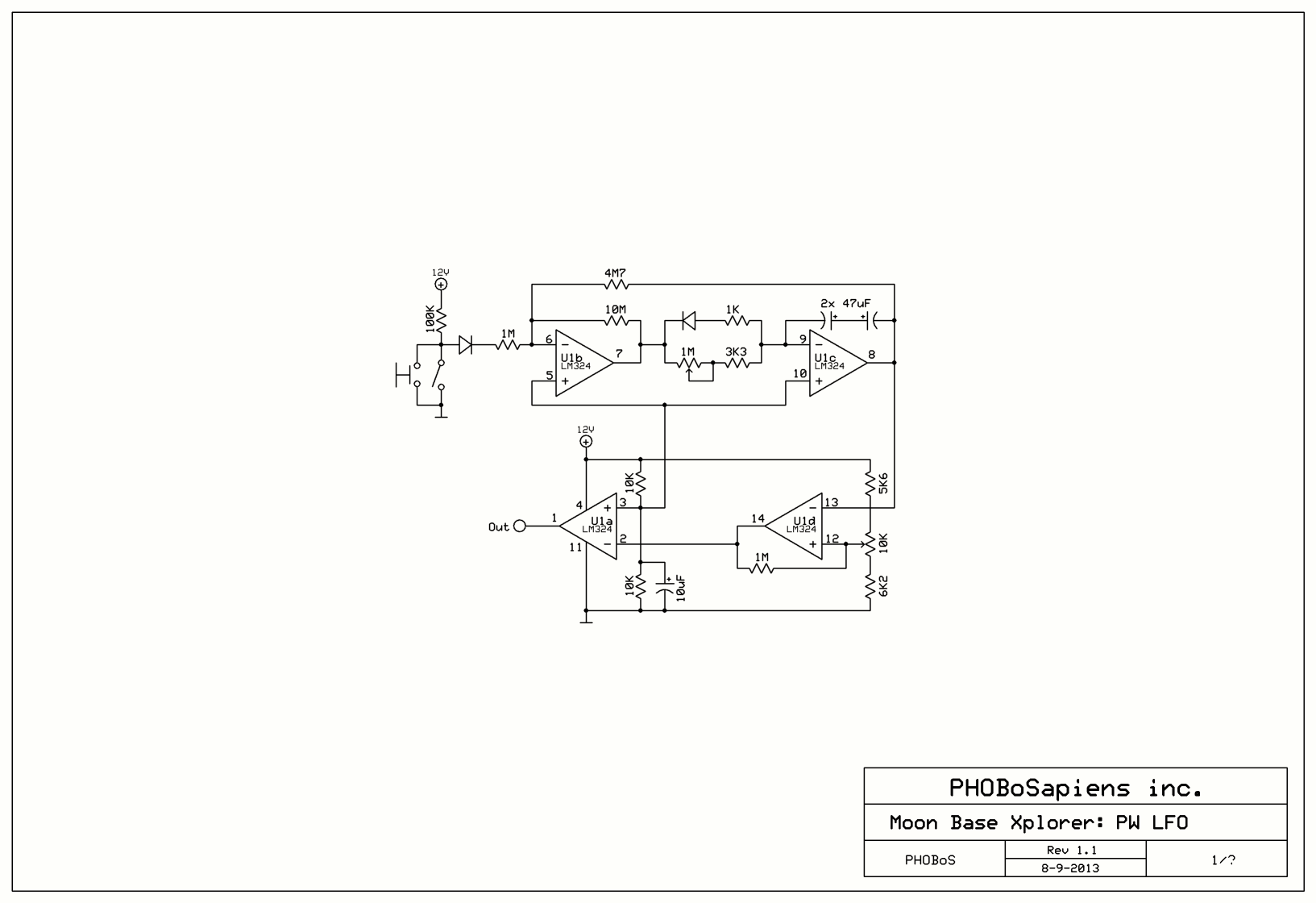

To trigger the AD/AR generators I wanted an LFO with pulse width control (very useful in AR mode). So I used a standard comparator/integrator
combo to create a sawtoothwave. Which get's turned into a squarewave with adjustable pulse width by using another comparator (U1d).
The pulse width is adjustable from 0 to 100%. Cool
The oscillator can be turned on with a switch or pushbutton. With the pulse width set at 100% and rate at maximum the pushbutton can be used as if
there was no oscillator in between. At a slower rate it works as a pulse lengthener.
I used spare opamp U1a to have an inverted output but currently I'm just using that as the main output.
NOTE: the inputs of U1b are swapped. There's also phase shifting when adjusting the pulse width.
An updated schematic can be found a few posts down
Moon Base Xplorer: LFO with pulse width control.
 Filesize:  38.75 KB
 Viewed:  1247 Time(s)

Looks like another interesting machine. A couple of questions. What sort of joystick pots are you using? Are they the expensive "proper pots" type, or are the cheaper games controller type, that look like a couple of vertical presets attached to the joystick mechanism. I've got an old games controller that I was thinking of dismantling for these, but I don't know how reliable they would be.

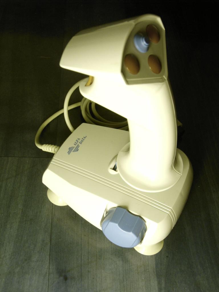

The joystick (only have one at the moment) I'm currently using is the small gamecontroler type which you control with your thumb. I would
expect they are reliable unless it's a crappy gamecontroller. But it does have a dead spot in the center (at least this one). I have a bunch of
bigger (game)joysticks here, which can be pretty cheap if you don't buy them new Wink, so I want to check if I can use one of those. (a couple of
them just have microswitches, no pots)

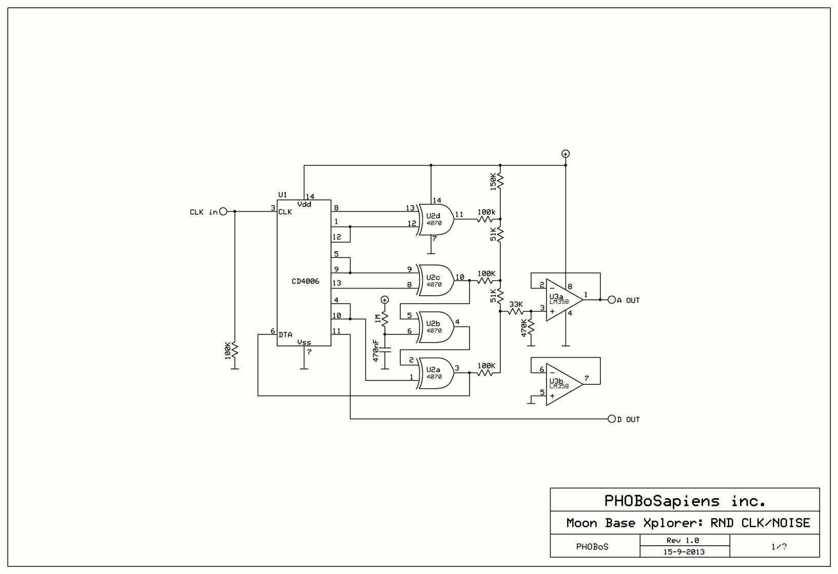

here's the Random CLK / Noise generator. A shiftregister XOR combo to generate a semi random series of bits. 1 output is used as a digital out
(sounds great at high speeds). 3 outputs are attached to an R2R for an analog output. I tied the R2R to + instead of ground to create an offset
voltage, followed by a voltage divider so that the output varies between 1-10V (in 8 steps).
I just noticed that it doesn't work when I try to clock it with the output of the PWLFO, it works fine with the VCLFO though. And everything else works with
the PWLFO so I'll probably add a transistor buffer to the input.
note: fixed it by using a different brand 4006 chip, see below.

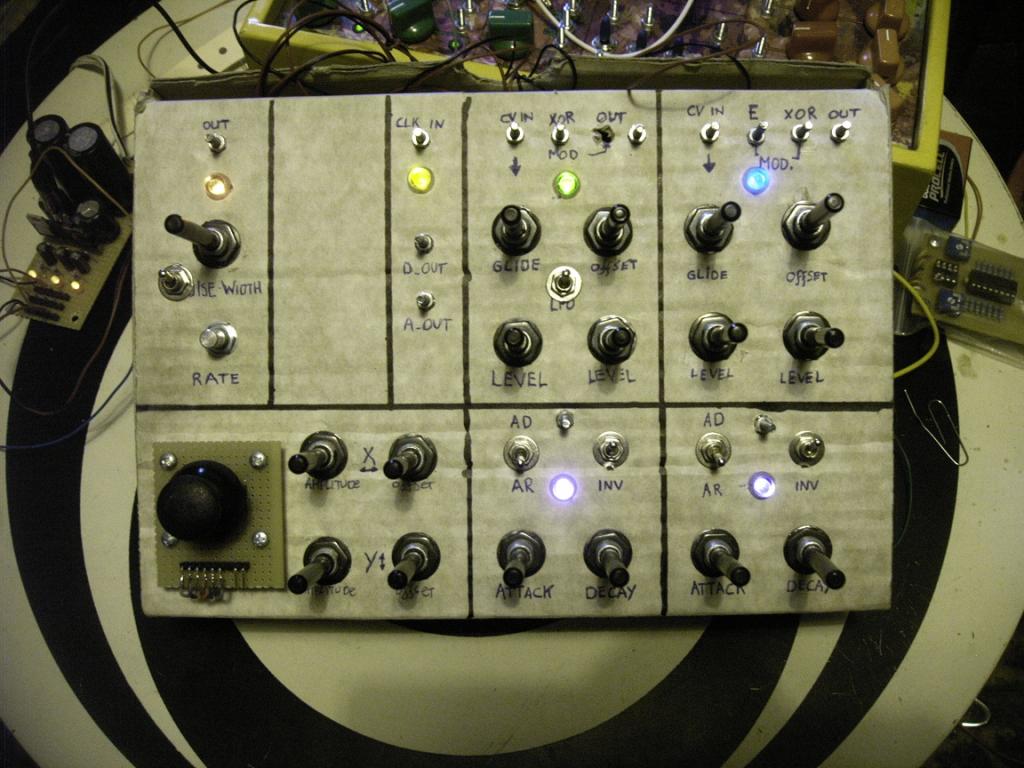

And here's a photo of what it currently looks like in it's temporary cardboard box. I still need to add a couple more things; another oscillator, subdivider,
delay,.. and I'm thinking of making a patchmatrix for it using cinch busses and shorted connectors (or maybe some with diodes). It could also be used
to link it with other synths. Cool

PostPosted: Thu Sep 19, 2013 10:18 am    Post subject: PWLFO update Reply with quote  Mark this post and the followings unread
an update on the PWLFO. After some experiments I found out that the maximum frequency was just a bit too low to get those nice 'raygun' sounds.
So I decreased the capacitors from 2x47uF to 2x33uF, which gives a much nicer range.
I also noticed a 'problem' with using the output that I had originally intended as the inverted output. When adjusting the pulse width the phase also shifts.
I had designed it so there would be no phase shifting on the normal output, so my initial idea was to just use that output instread. But this resulted in
another problem; when the oscillator is turned off the output stays high Confused . So I used the inverted ouput and solved the phase shifting issue by reversing
the sawwave. Which is done by reversing the diode between U1b and U1c.
Í drew an optional gate input, which I haven't added yet but probably will. And while changing the schematic I noticed a mistake (which I made
before Embarassed ). The inputs of U1b were swapped, so I fixed that too.
I'm using LED's on almost all outputs (PWLFO, VCLFO, VCO, AD/AR1+2, RND CLK) so I drew one in aswell. No LED drivers just directly connected
to the output with a series resistor. The value depends on the LED that's used so I left that out.
Moon Base Xplorer: PWLFO
 Filesize:  41.92 KB
 Viewed:  1000 Time(s)

Posts: 5888
PostPosted: Thu Sep 19, 2013 4:28 pm    Post subject: Re: The Moon Base Xplorer
Subject description: RND CLK/NOISE GEN
I just tried some things to get that fixed, a couple of different combinations of resistors and diodes, but that didn't work. A transistor on the input
(which I didn't want to do because it inverts it) didn't work either Shocked .
So I looked in the datasheet what the min. a max levels for the CLK are and according to the one I was reading they aren't really close to Vdd and
GND. So it should work fine but,.. that was a datasheet for a CD4006B from Texas Instruments and I'm using a Philips HEF4006BP. So I checked
the datasheet for that one but it didn't have any information about those levels. It did make me curious if using a chip from another manufacturer
might work. Well besides the Philips one I also had some other ones which seem to be oldies from Solid State Scientific. and guess what,.
it works Laughing so that turned out to be an easy fix.
I also added a switch in series with the input, so it can be put on hold without having to unplug anything.
note: I'm using the same circuit for another build and had a problem again with the CLK input. But this time I solved it by changing the 100K pulldown resistor to 10K.

Posts: 5888
PostPosted: Thu Sep 19, 2013 4:45 pm    Post subject: The Moon Base Xplorer
Subject description: AD/AR generator update
a small update on the AD/AR generator.
I added a 10K pulldown resistor to the input so it doesn't trigger itself when put in AR mode without anything connected to the gate/trigger input. I added
a pushbutton for manual triggering and to prevent shorting out anything that's connected to the input I added a diode in series with it.
Tested but not added yet is the LED driver. For the digital outputs it works fine without one, but with the analog signals the LED turns off before the
signal has reached its lowest voltage level. It does seem to have a bit of a pullup effect on the CV level but nothing dramatic and with the offset
adjustments on the VCLFO and VCO it doesn't really matter.
 Filesize:  54.33 KB
 Viewed:  1183 Time(s)

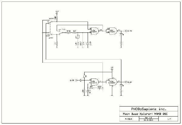

Posts: 5888
PostPosted: Sun Sep 22, 2013 12:35 pm    Post subject: The Moon Base Xplorer
Subject description: NAND OSC
I added another oscillator or actually two. Because I want to add some simple VCA's something that could produce a control voltage would be
nice. So I first tried a triangle wave oscillator, which I could turn into a saw/reverse saw. But I wasn't really happy with it, and I didn't really want
to add a sinewave generator either. So back to squarewaves and then I'll might add a glide control to the VCA's or something.
So I did a couple of experiments using some NAND gates. Trying all kinds of different configurations, some worked, some didn't, but nothing was
really useful. I was allready thinking of adding a pulse delay to trigger the AD/AR's after each other. So I that was my next try and I ended up with
something that has 2 gated oscillators that can be used seperately, But also linked. And one can be used as a delay aswell.
So here's the circuit. At the bottom oscillator A (LFO) made from a single NAND gate (U1b) which is being inverted and buffered by another
NAND gate (U1a). Nothing special there. At the top oscillator B (U1c) which has a switch for 2 frequency ranges. With the gate select switch
in it's center position it works like a standalone oscillator which can be turned on/off with the oscillate switch. With the switch set to oscillate the
gate select switch can be used to gate oscillator B with oscillator A, either with the normal or the inverted output. With the oscillate switch turned off
it becomes a pulse delay which again can be gated by the normal or inverted output from oscillator A.
If you looked at the schematic you might have spotted a zenerdiode, which is there to help it start oscillate quicker when gated. If the oscillator
is in oscillate mode then the following thing happens. If the gate input (pin9) is high it oscillates and if it's low it stops,. but if it stops this means
that the output of U1c will be high and the capacitor get's charged. When it's oscillating it will only get charged to the upper treshold level of the
NAND gate but now it will be charged to almost the supply voltage. And because of this there will be a delay when you turn the oscillator on again
because it takes longer for the voltage to drop below the lower treshold level. Long story short the zenerdiode limits the voltage to which the
capacitor get's charged when the oscillator is turned off, so it will start much quicker.
I could add a zenerdiode to oscillator A, but I actually like the delay effect on this one. I might add another switch though so I can use that one as a
pulse delay aswell.

Posts: 5888
PostPosted: Tue Sep 24, 2013 7:47 am    Post subject: The Moon Base Xplorer
Subject description: no joy with this stick
I remembered I had an old joystick somewhere which might be useful but I also knew there was something wrong with it. So I dug it up (it was actually in
the first spot I thought it would be Very Happy) and when I opened it up I saw what the problem was. On each pot, which aren't real pots but a PCB with a carbon
trace on it, one solder lug had broken off. I had tried to fix it with aluminium tape before but that didn't work, so I gave it another try. I got one fixed by
using some braided wire and using aluminium tape to secure it. But I can't fix the other one Sad. It's too bad because it would have been perfect, especially
after I managed to remove it from it's housing.
I could still use it with just one lug (it's not the wiper connection), with a slightly different circuit. But the carbon tracks are worn down so it might not
work very well or break down after a while.

Fixing the previous joystick wasn't a succes so I checked what else I got. Found a nice one with a couple of buttons but it is rather large compared to
the other one. I could remove the bulky handle with the buttons and maybe the base too but that kinda holds things together. Or I just use it
as it is and don't put it in the case, which is actually a bit more practical. And the buttons are useful to trigger things so that's what I'll do.
Besides 4 buttons it also has a little stick with another 4 buttons. I didn't see any use for this at first and was thinking of replacing it with an LED.
But when I opened it up I saw that the switches are mounted on a PCB with a bunch of diodes, so I retraced it and drew a schematic to see what
that was all about. As it turns out the little stick just controls combinations of the other buttons. So pushing it in a certain direction is the same as
pushing a couple of the other buttons at once. Well, that's actually quite usefull because it would be difficult to push more then one button using
just my thumb. However I didn't like the combinations it produced so I modified it a bit. I could have used some logic to convert it but this was
easier to do.
As for the analog part, this one has three pots: two on the joystick and a third one which is just a knob. They're all 100K but the 2 joystick pots
measure closer to 120K. I was thinking of wiring them up in the same way as the small joystick I'm currently using and maybe put the level pots
inside the joystick aswell. But I could also use them in their original configuration and then I could use other (unmodified) joysticks too.
To do this I need a slightly different circuit. The joystick pots together with another resistor (100k resistor + 50K trimpot) create a voltage divider.
This creates a voltage of ± 6..12V which gets buffered and then it gets amplified, while at the same time an offset voltage is added, to get an
output range of 1...10V. It also inverts it which is ok for the X movement (left = 1V right = 10V), but it's reversed for the Y movement (up = 1V
down = 10V). And since it will be hardwired to a VCO it would make more sense to have it the other way around. I could just use the other outer log
on the pot to fix that , or I 'll invert the signal and then it'll work with any joystick. But I'll probably just rewire it.
The buttons also need to be inverted but I wanted to add some gates to them anyway (so that a high signal is not just provided by a pullup
resistor). And by using some schmitt trigger inverters (40106) together with some capacitors it works as a debounce circuit aswell. Cool
I currently have it breadboarded but when I first tested the joystick I wasn't too happy with how it responded. Only about 60% of movement
result in an actual change in resistance. So you can't just push it from one site to the other but have to keep it somewhere around the center
position. I had removed the springs that keep it there to allow for easier movement so I placed those back and that makes it a lot easier to
control. Very Happy (and the buttons work nice too)
