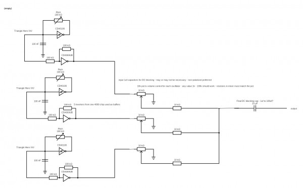

I'm building an instrument using triangle waves from a 40106 and sending them to a 4069 for buffering. I don't have much knowledge of electronics and am still learning, but I'm thinking of sending each triangle oscillator (3 or more) to a different inverter available on the 4069. connecting a 100k resistor to the input and a 100k resistor to the feedback. Is it a good idea to do it separately? or I should just use one inverter to mix and buffer it all like the active mixer presented here: https://hackaday.com/2015/07/02/logic-noise-ping-pong-stereo-mixers-and-more/
I thought of using them separately because their are going to be so many inverters unused and I'm not thinking to overdriving them.
Should I add 1uf capacitors before the triangle waves enter the 4069? Or is it unnecessary in this case?
Also, I'm wondering what's the best way to add independent volumes to each oscillator, if it should be before or after the buffer.
Sorry for so many questions, I'm going to continue to experiment with several setups of this. Thank you!

I've only breadboarded up the triangle from 40106 rather than done anything finished with it but I *think* if you're mixing them a buffer for each one (i.e. one inverter from the 4069) is essential, otherwise they will interact. Like you said you've got inverters to spare and if I've learned one thing on my electronics journey it's that buffers are good!
From the buffers you can use another inverter from the 4069 as a summing amp (some good mixer circuits here - http://www.all-electric.com/schematic/simp_mix.htm - as Elliot Williams points out in the filter article, you can substitute a 4069 for an op amp where negative feedback is being used and positive terminal is grounded)
I've put together a schematic that *I think* would work - although I haven't tested it!
Apologies for my drafting - I used this online schematic drawing software (https://www.circuit-diagram.org/) and you know I wasn't sure how to draw a potentiometer in a schematic but they're wired as volume controls so, input on one lug, output from the wiper and ground on the other lug.
The one thing you may want to play around with is the output DC blocking capacitor - I think I misread the Logic Noise article and put a huge capacitor in there (10uf I think, maybe it was more) and I ran in to trouble with impendence plugging into a guitar amp (buffered mixer fine) - there's a thread on it!
With a regular opamp configured as a (inverting) summing amp there shouldn't be any interaction.
However, a 4069 is not a regular opamp, and on top of that you're directly connecting to the timing capacitor of an oscillator.
Any change in load on this capacitor will alter the frequency of the oscillator which is already a good reason to buffer it.
I don't have much experience with the 4069 though, I did mess around a bit on a breadboard with a wasp clone
and maybe some other simple circuits but that's about it.
I think the 4069 has some non-linearity and a limited signal voltage range which can make it an interesting choice
especially for something simple like this.
That circuit looks good to me. Could test with and without buffers and see what happens.

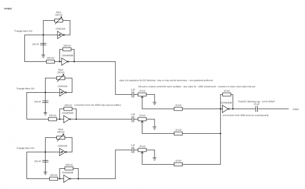

I experimented both ideas that I talked on the first post to understand them better and I liked the result of using a buffer for each one with 4069!
I breadboard the circuit with 3 oscillators, triangles waves to separates buffers on 4069, and then volumes potentiometers and resistors mixing and output cap. (I changed some things on your image Ianbax to explain this version, thank you for sharing the draft). I tried to use another inverter from the 4069 as a summing amp like you said, but I compared between the two versions and I prefered without it, because when the volumes are all down, I notice a lot of noise on the sound when outputting to my mixer and PA, the circuit sound more quieter and smooth when I don't use that part. I also added decoupling caps on power, 2 caps of 100 uf and 100nf on the power pin of every chip and it helped with the noise a bit.
I used the 10 uf and haven't got problems it, but I would like to understand better this kind of problems of impendance, something I need to search more about.
Maybe I should use an opamp to do this kind of buffering and mixing instead of the 4069, would it be better in terms of noise or connection to other circuits like filters? I have done some mixers with Opamps like tl072 and others, but I saw this tutorial of Elliot and gave it a try.
If I want to connect this kind of circuit to a filter like a WSG filter should it be a problem of connecting the mixer of resistors directly to the input of it?
I'm going to experiment more! Thank you all!!

Interesting about the summing mixer - I've used that design to mix the square waves from a 40106 but I suppose with the triangle waves already buffered individually the active mixer is just over-engineering. A passive mixer (as you've built) works just fine and as you say, a lot cleaner.
