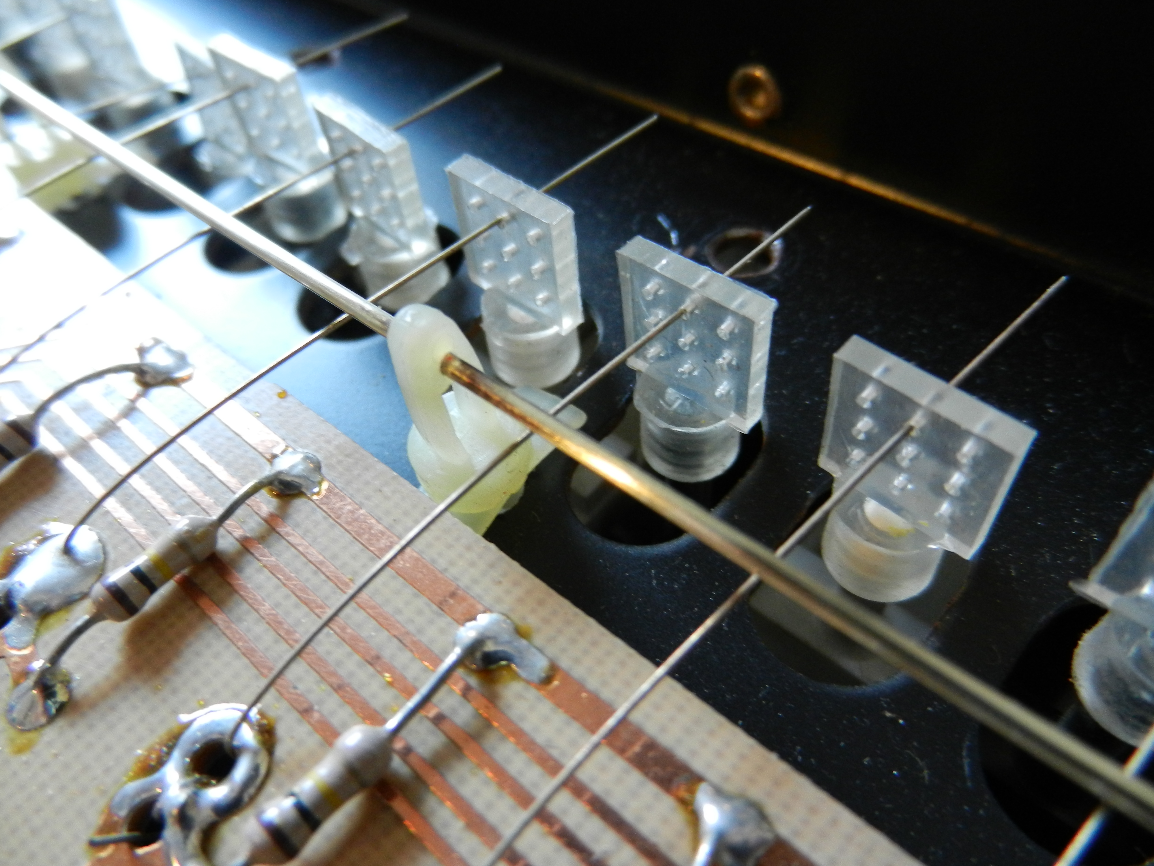

Hello all,
I've got an Octave Kitten keyboard (which you can learn a bit about from this site). A few days ago I had the bright idea to clean the keyboard.
Previously, some of the keys would make squeaky sounds, which I assumed was caused by an intermittent contact. I opened it up and started cleaning off all of the keyboard contacts with some alcohol.
According to Blue Hell in this thread I started earlier today in the DIY forum, the keyboard contacts might be "Kimber Allen key contacts or lookalikes." Here is what they look like. (pardon the dark images... I was lighting the keyboard with a dynamo-powered flashlight... because my only good batteries were in the camera... d'oh!)
When I press a key on the keyboard, most of them make the same pitch. This happens when the lower wire of the key's wires touches the lower of the thicker, stationary wires (would these thicker wires be called bus bars, like in a circuit breaker box?). If the keys' upper wire touches the upper bus bar, the frequency goes up a seemingly uncontrollable ammount. If I wiggle the upper wire around it squeals and glitches.
How do these keyboard mechanisms work? I see a series of equal value resistors making a voltage divider which should provide a different voltage at each key. There are also some SIP capacitors (at least I think that's what they are... it looks to be ceramic) which I guess would be for debouncing? Maybe? I think that's all there is to it, so each key should have a different voltae.
Could it be that the lower wire is the gate and the upper wire is for the oscillator's control voltage?

I should really know this. I have had these synths since they were new. Both the Kitten and the Cats are in storage but I know I have a stack of schematics and stuff for these somewhere. The keys are KA style thingies, that is correct. There was some kind of minor difference though, I cannot recall what that was.. but
I really don´t want to come up with advice unless I find the schematics and the "repair manual".
It is correct that you have one array for the CVs and a simple gate trigger. It should be quite easy to identify the lot. If you get the same note/ CV there is obviously something wrong,

Yeah, that's a great site. I've been looking over the tuning instructions, and I think it may have somehow gone way out of tune.
After a little experimentation with the keys, it looks like the keys that were all making the same pitch were only having the gate wire triggered. The ones that were making the incredibly high pitch were hitting the CV wire. As it turns out, the lowest keys actually are making a different pitch, it is just very very low, and the high keys are making a very very high note. I need to adjust they keys wires quite a bit more, but it looks like the scaling is just wwaaaay off now. Like half an octave, at least, per key.
So once I get all of the key wires back into place, I'll have to go through this lengthy tuning procedure. But that's good, because then I'll have a nicely tuned Kitten!

Just as I thought, the 'busbars' are almost identical to the ones in my CV/Gate keyboard which I modified from an old Baleani organ.
It should be fairly easy to extract the busbars from those white formers. Then shine them very carefully with some 1200 wet&dry. Don't go too hard, just enough to brighten them, they are nickel plated (which you don't want to remove or they'll rust) It's quite hard and makes a good contact, but after 10 or 20 years they get a kind of tarnish on them. After I did mine they are now spot on reliable.
While they are out wipe each contact finger with a bit of isopropyl alchohol on a cotton pad as well. _________________ What makes a space ours, is what we put there, and what we do there. |

| Jabberwalky wrote: | | I have acquired an Octave Kitten with the same problem. Every key plays the same pitch. |
On mine, what was happening is that the GATE contact was being made, but the CV contact was not. So the Kitten would know I was hitting a key (GATE) but not which one (CV).
The trick is to thoroughly clean all of the metal contacts with alcohol. If that doesn't get all of the keys working right, you may need to bend the metal contacts carefully so that they hit the bars when the keys are pressed.
Take the bottom off and try manually making the contacts, you'll quickly figure out which is for the GATE and which is for CV.
If they still all make the same note, even when both contacts are made, then the thing is waaaay out of calibration and you'll need to calibrate it. I'll dig through my old files and see if I kept a copy of the calibration procedure document. |
