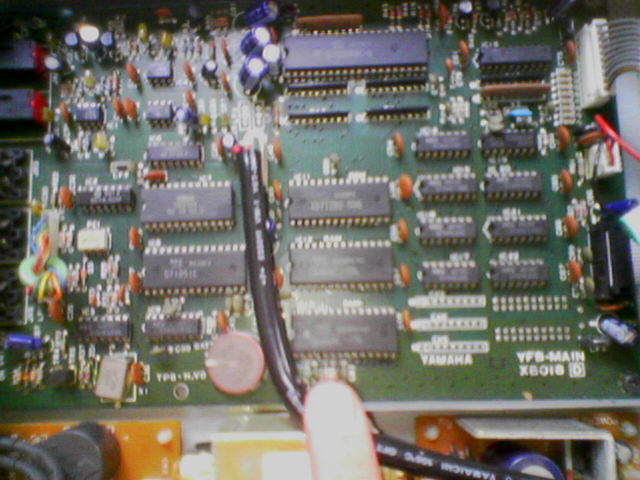

Finally I've a keyboard to circuit bend.My girlfriend give me the permission to circuit bend her Yamaha PSS-280. kiss
RAM chip is AN90B22 18 pins and CPU is XG214BO.I 've just found 14 good bend points....but I would know which pin of RAM chip I should keep away from bending.(I've found datasheet but it doesn't tell me the pins functions)
Do you think the best think to do is bending only points on the CPU?
I would'n t damage the keyboard. Wink

Hi balance.
glad to hear that you got the permission to bend PSS-280
are you sure its a RAM chip? and can you point to the datasheet, because all i did find that AN90B22 is transistor array!?
are there any other chips than the XG214BO and the AN90B22?
there should be some FM and PCM action going on inside your Yamaha.
can you take a pic of both sides of the PCB? so that we could see the traces and the chips - also a map of the "good bend points" would help.

EraSer
Joined: Apr 12, 2006
Posts: 82
Location: Italy
PostPosted: Mon Jun 26, 2006 2:19 am    Post subject: Reply with quote  Mark this post and the followings unread
Dnny
You are right. I'm not sure about AN90B22 Embarassed .I've found the same datasheet.
when I open it i can see also these three chips:YM7116, MC34072P, AN7148.....but they are far from the CPU. on the contrary AN90B22 is above CPU like in your pic.
as soon as possible.......

yES Very Happy
I've found FM chip:it's YM7116. I'm trying making connections betweent FM and CPU points .......and I can obtain strange and alien sounds! cyclops
I' will continue to try other connections....even if there's a problem:I would use a RCA patchbay but....There isn't space for it!There is the space only for switches near the first and last key.Can I use external rca module?Suggestions?examples?

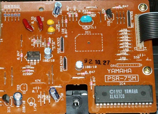

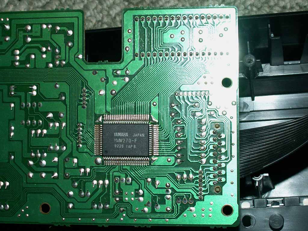

PostPosted: Mon Jun 26, 2006 5:52 am    Post subject: Reply with quote  Mark this post and the followings unread
Hey Daniel,
Do you reckon this one's a goer?
I'm going to do a search on the chip at the front of the board. It's a lot bigger than the other ones, maybe it has 16 data lines? I'll let you know what I find out.
 Filesize:  99.75 KB

Uncle Krunkus wrote:
Hey Daniel,
Hi Andrew
i think you should give it a try. it has no FM but it's sample based.
Yamaha PSS-31 has the same CPU and ROM.
also the Yamaha PSR-150, PSS-21 and PSS-11 shares the insides of PSR-75
here is Yamaha PSR-75 owners manual
maybe there is some info there.
the ROM should be crystal clocked, but i don't see any crystal so maybe it's integrated Sad

PostPosted: Mon Jun 26, 2006 4:54 pm    Post subject: Reply with quote  Mark this post and the followings unread
That light blue blob is a crystal.
CL1 right! I'm used to those metal cans cyclops
whats the frequency? maybe you could try over clocking and under clocking.
www.koelse.org
flickr: cable porn group
PostPosted: Tue Jun 27, 2006 7:36 am    Post subject: Reply with quote  Mark this post and the followings unread
"8.00T" is written on it, so I assume it's 8Mhz yeah?
