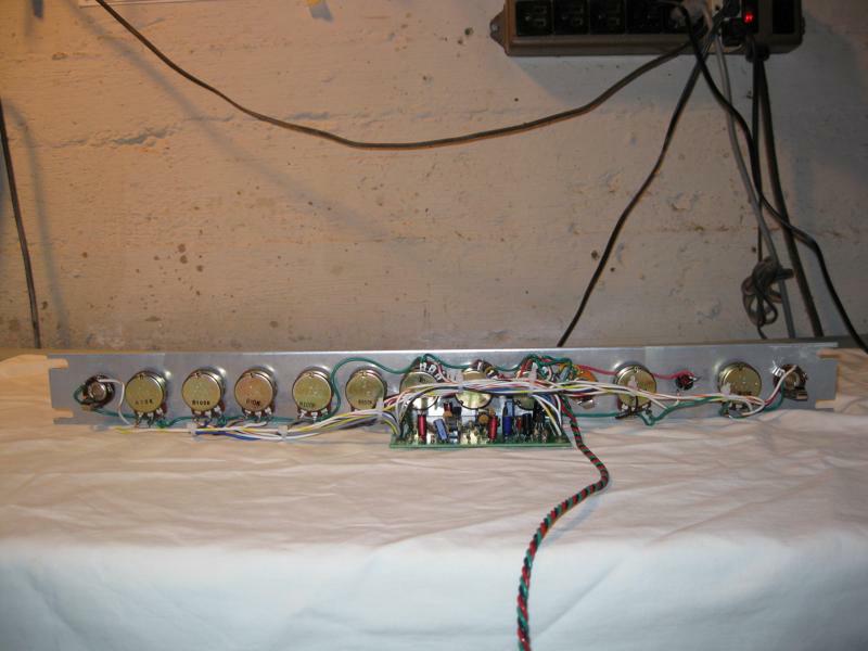

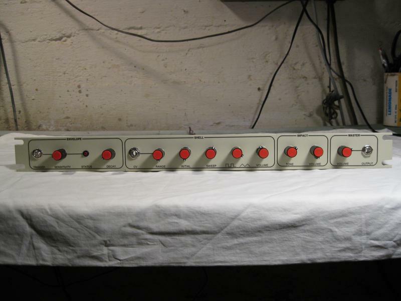

PostPosted: Mon Aug 10, 2009 9:09 pm    Post subject: Reply with quote  Mark this post and the followings unread
Hi gang,
Since things didn't work out this summer for getting six new projects out the door, I decided to catch up on my backlog of old things. Among them was my own hard copy of the UD-1. (My previous version had lived only on a breadboard).
Here's some pictures of it.
Thomas Henry
