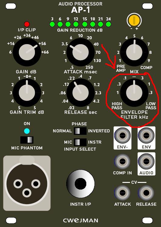

Could anybody explain me how works "envelope filter" Knob?
Thanks in advance.

It's probably similar to when you put an EQ in the sidechain of a compressor. It's a way of controling what the dynamics processor reacts to. If you set it to low pass, then it will react to the lower frequencies but not the high ones etc. Does that make sense?

Ok! Thanks Uncle Krunkus!
And the knob works like a cutoff.
