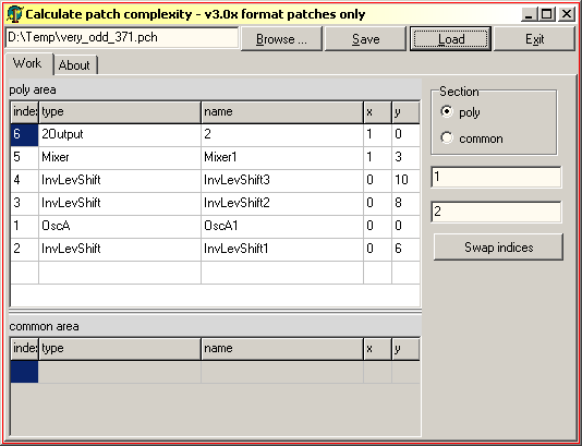

Ok, I made a little something like in screen dump below (don'[t mind the title bar, it's an old one). Any suggestions for what other operations besides swap indices would be needed ?

Hi Jan,
that looks very nice! I don't have any other wishes.
Except perhaps a `reload patch' button for quickly checking if the order is what i think it is if i've made minor changes in the patch using the editor. If the normal `load' remembers paths that's OK too.
So far, everything i've seen fits the description. I'm now at systematically checking which outputs have the latency problem. Then the inputs, and i'll try and measure the internal latency of modules..
How do I get your program, Jan?
---Rudi
It seems to work, but I have to run a few more checks, like seeing if the saved patch is actually loadable for the NM editor. When done I'll post it here for you to check out, hopefully in time Very Happy
The idea is to set a patch name by the browse button and then load and save will use that patch name. So you save in the editor, load in my program or the other way around and things are synced again.

Ok, it seems to work, so here it is. Please note that this is windows software.
Just unzip the zip to a directory that seems suitable for you to use. The zip contains an exe file, the license agreement (GPL) and a folder with some resource files used by the exe. When running the program it will write an ini file to the same folder as where the exe is located.
Just run the exe, then browse for the patch you want to mangle, then click Load to load the patch and when done mangling click ssave to save it - it will overwrite the old patch then (so maybe make copies of valuable patches before using this). The patches have to be in 3.0x format.
When it's found to be OK I'll post it on my web site along with the source code.
When you want additional functionality or bugfixes feel frre to ask.

Hi Jan, thanks for the program, it works fine here.
