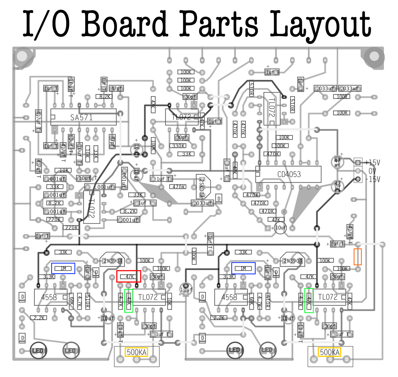

I've almost completed the Okita build, just some hardware wiring and I should be good to go.
I'm afraid I think I may have found another error on the lower right of goodrevdoc's PCB... Cut the trace as shown below (I think this may be why the Op-Amp was getting hot)
The output of pin 1 (IC29) shouldn't be linked to the Instrument gain pot via the jumper... Maybe this is also causing the indicator problems - I'll find out tomorrow, when I can start testing the boards.

PostPosted: Sat Apr 25, 2015 11:34 am    Post subject: Reply with quote  Mark this post and the followings unread
OK, so breaking the track (above) fixes the indicator problem and no hot Op-Amps.
BUT... I've also found another major error on goodrevdoc's component layout - all the 4.7uf and 10uf tant caps around the NE570/571 are the wrong way round.
I'm just about to replace them, so I'll see if that fixes things.

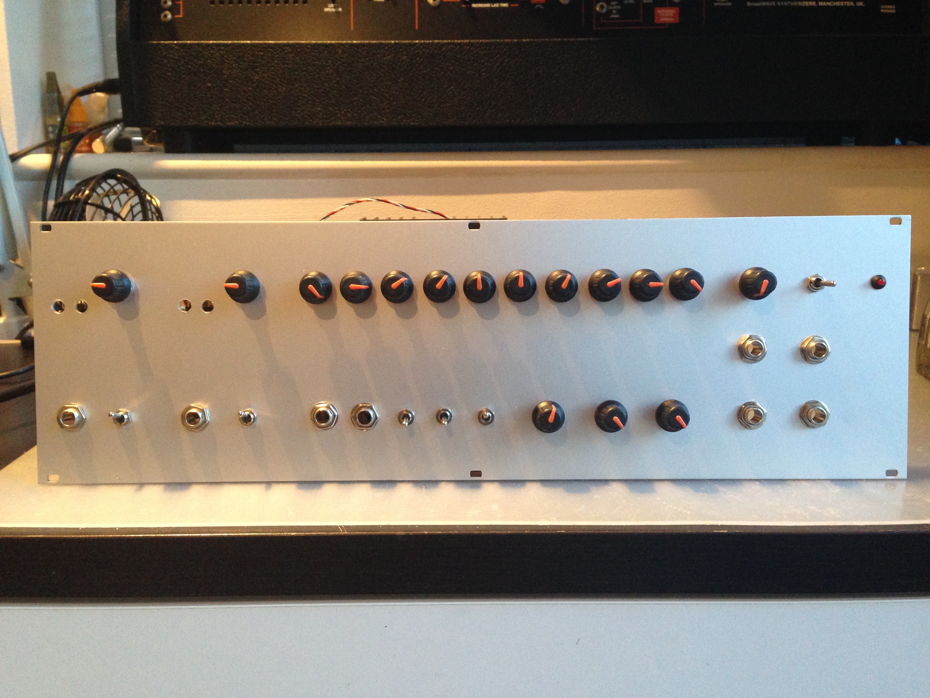

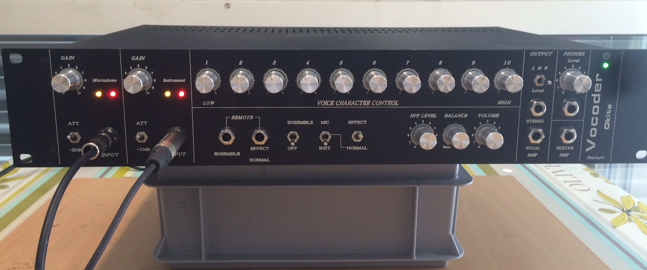

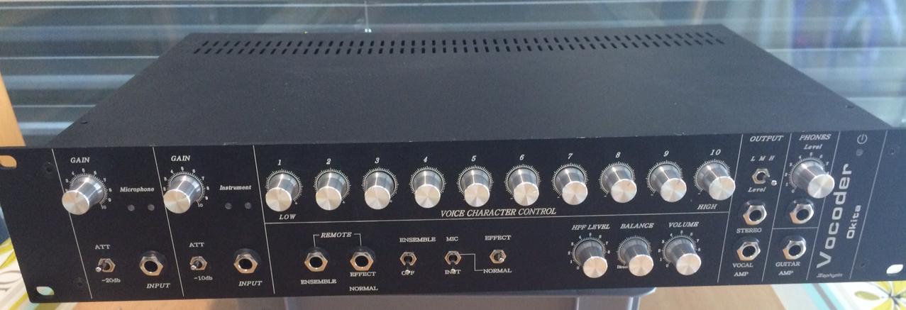

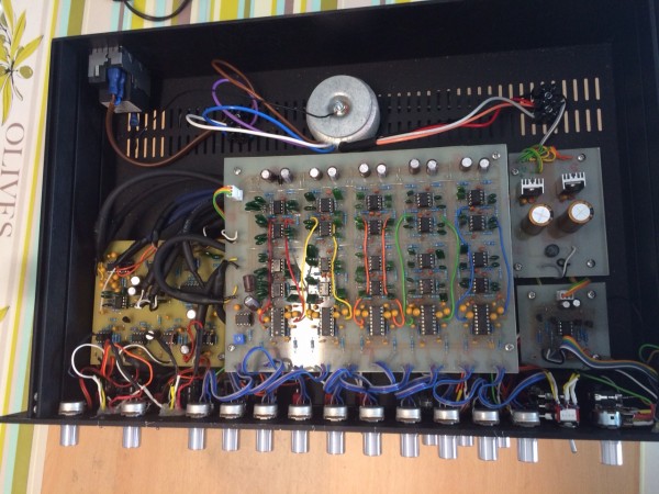

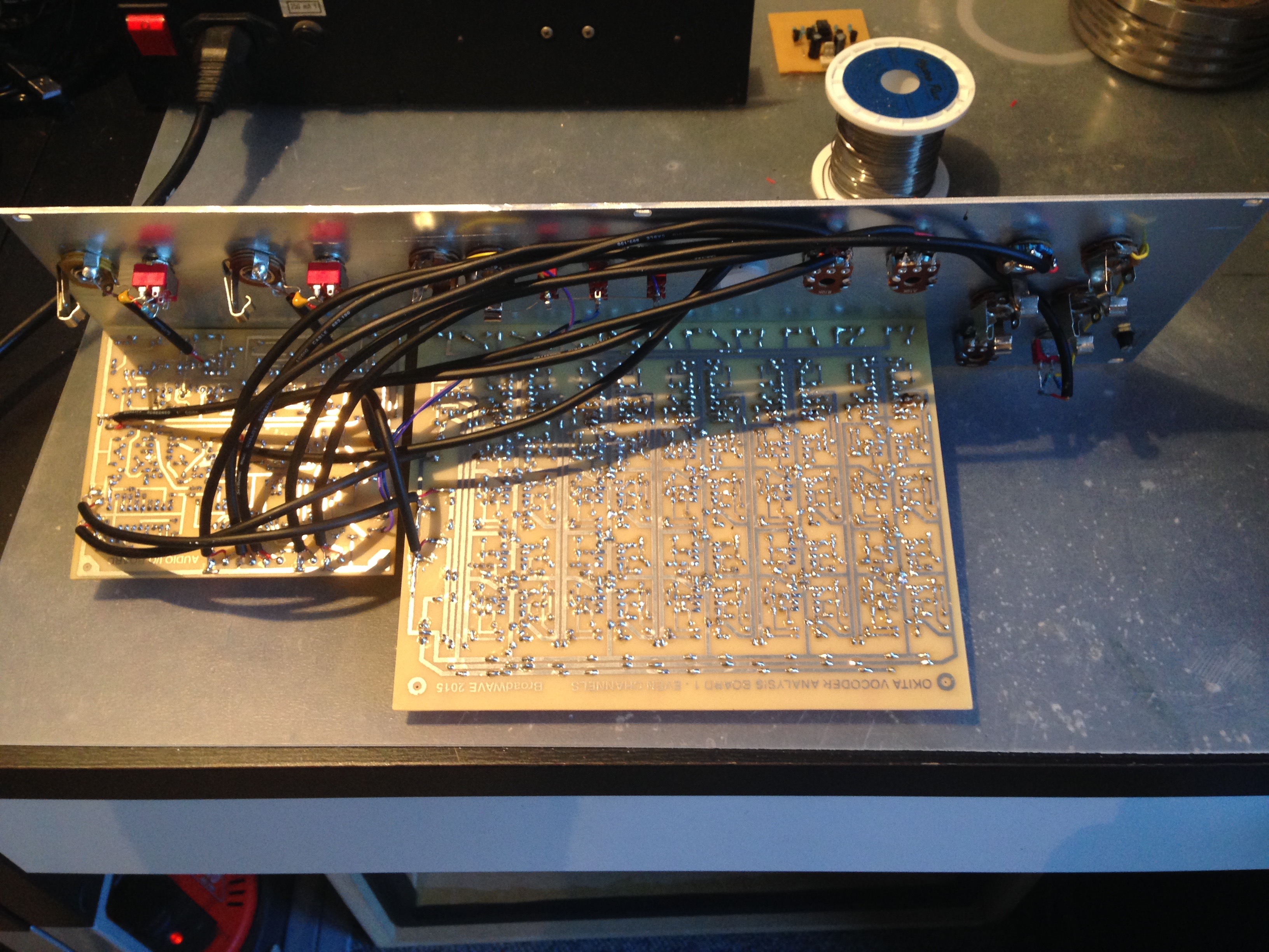

PostPosted: Sun Apr 26, 2015 11:41 pm    Post subject: Reply with quote  Mark this post and the followings unread
Built, tested & finally working Smile
I had to revert to Okita's original schematic, along with the additional 470k resistor modification on pins 1 & 16 to ground of the companders - sorry, but there's just too many errors on goodrevdoc's version Sad
Intelligibility is ok-ish, maybe not quite as good as the SVC-350 which it's based on, but still pretty usable, although I can detect a definite formant shift... maybe I should have used better quality capacitors Embarassed
You need to be careful of both input levels, otherwise it will distort! I found that it helps to roll off the bass end on both input signals. I've got an old chorus pedal somewhere, which I'll install at some point, but the good news is that substituting NE570's with NE571's works fine, and you can get them from Futurlec for a reasonable price.
For this quick test I used a Behringer C1 condenser mic, via my DI Box and Studiologic Sledge (Basic sawtooth, 3 oscillators, 1 octave apart, no detuning or filtering). Recorded directly from the Multimix 16 USB2 with a touch of reverb.

PostPosted: Wed Apr 29, 2015 1:46 pm    Post subject: Reply with quote  Mark this post and the followings unread
Congratulations on a beautiful build. It sounds quite good in your demo. I use the Nord Modular G2 for vocodeing. I like the unintelligible quality of vocoders. Sometimes, though, I want the voice to be understandable.
A little trick you can use is to mix in the direct voice in with the output of the vocoder. I process the direct voice with a high-pass filter as I have found that all you need to add for intelligibility are the sibilances, just the high frequencies. This is ironic (I love irony) because most audio engineering writings are all about how to reduce sibilance. Smile
I have two extra controls on the vocoder patch: one control is for a cross fader between the direct voice and the vocoder output, and one control is for the frequency of the high-pass filter on the direct signal. You thus get a lot more control.

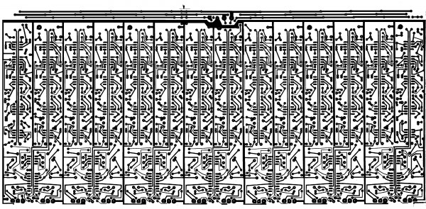

I want also to built the ETI (powertran, ELRAD) vocoder, i m starting to rebuilt the typon for the big PCB ...

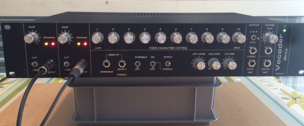

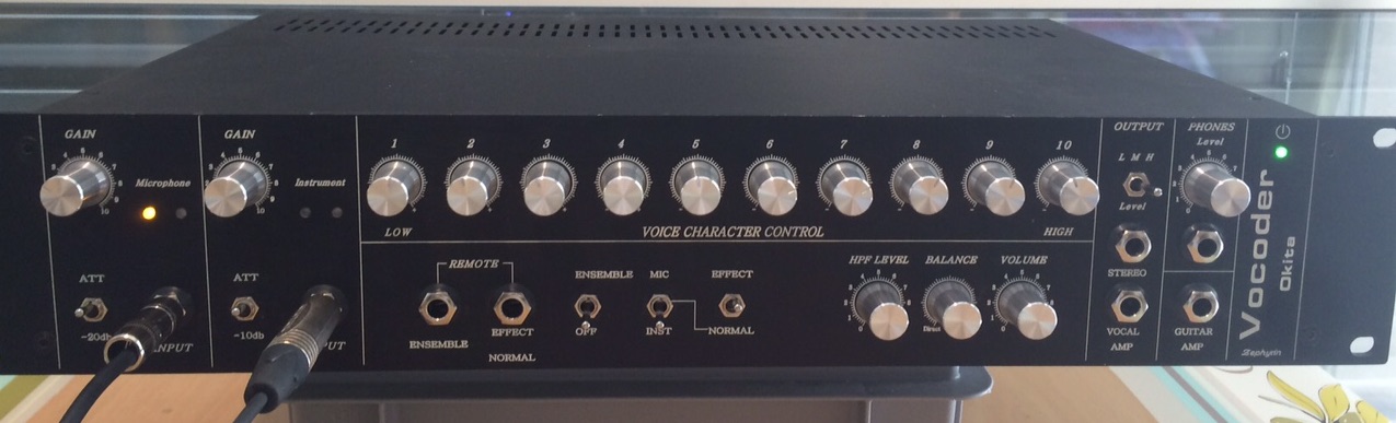

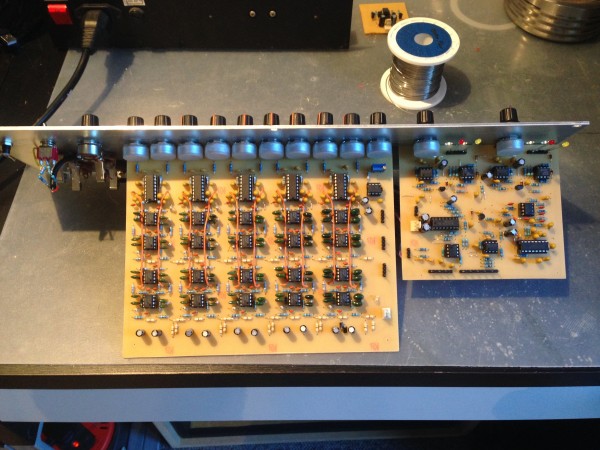

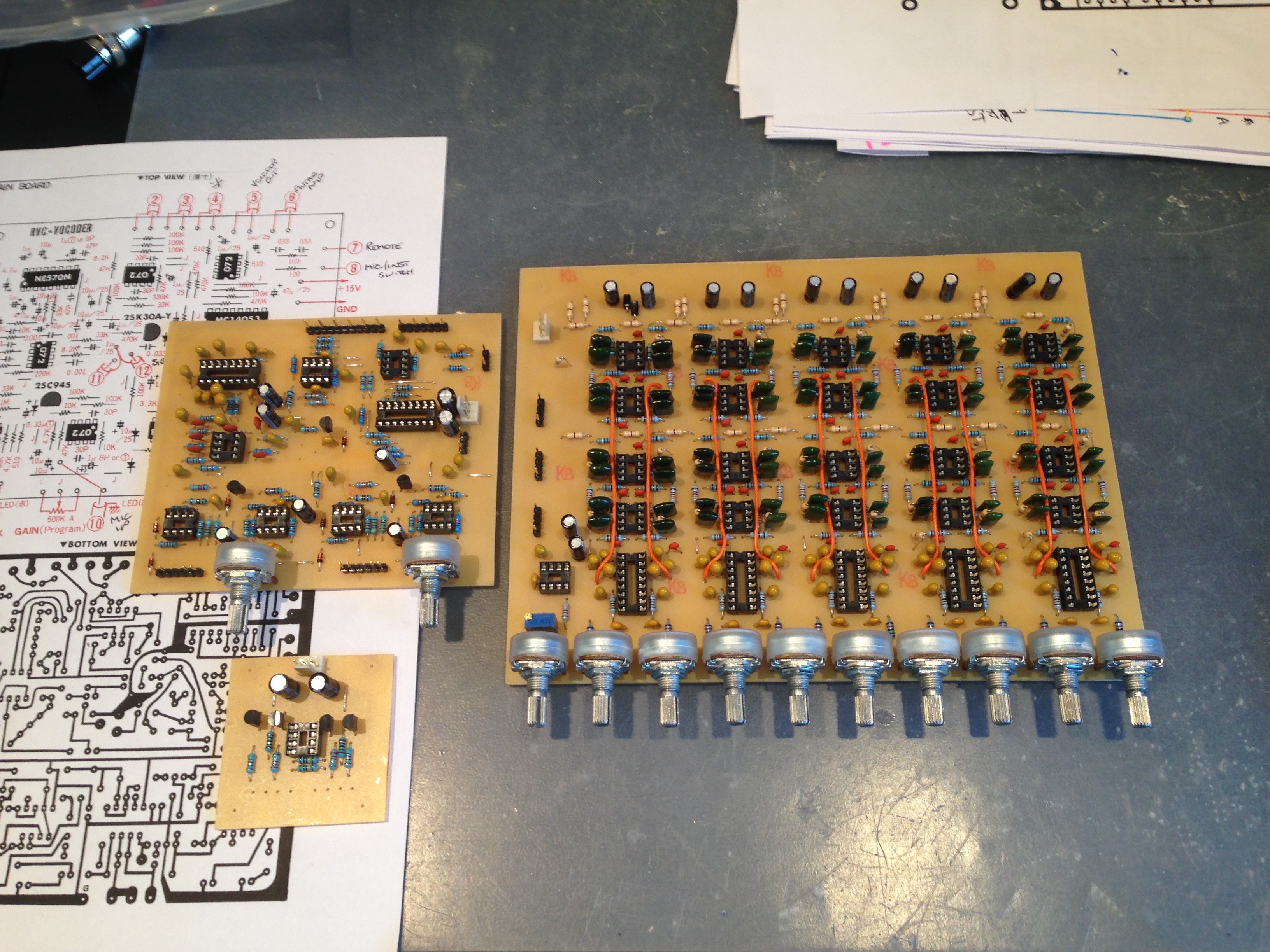

PostPosted: Mon Jul 27, 2015 8:30 am    Post subject: Reply with quote  Mark this post and the followings unread
I have finished my Okita vocoder this is some pictures of the machine

PostPosted: Mon Sep 21, 2015 12:53 pm    Post subject: Reply with quote  Mark this post and the followings unread
Unfortunatly my okita vocoder have some defect with the instrument input when i m playing and changing the note there some audio crunch.

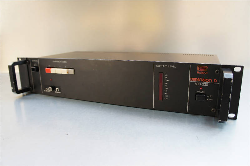

I believe the "ensemble" effect I loved when I had my Roland VP-330 is basically a "chorus on steroids" type effect with several BBD chips all doing their own thing, hence the wider, more lush and "fat" sound without the pitch modulation of a basic chorus unit, right?
Having discussed the subject before and understanding how hard it is to clone the VP-330 ensemble (or other similar Roland keyboards with a similar ensemble) or another DIY ensemble effect which is relatively inexpensive and fits inside the vocoder enclosure I'm wondering if it might just be easier to rip out the PCB of some kind of enseble effect pedal.

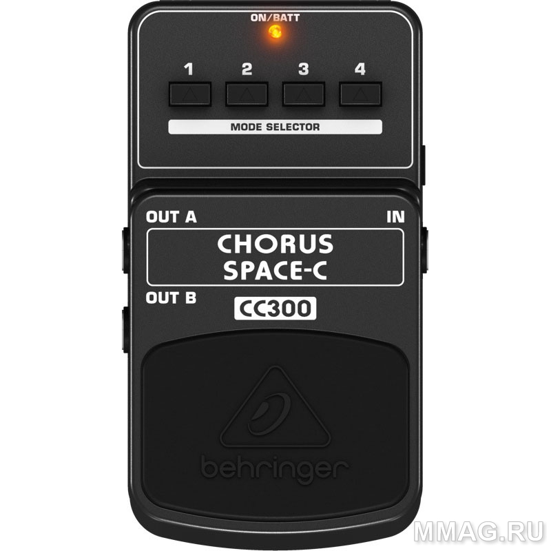

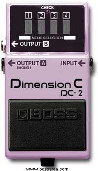

I've been suggested Behringer's CC-300 which is supposed to be a clone of the (rather expensive) Boss DC-2 Dimension-C (which in turn is a cut-down pedal version of the (even more expensive) Roland SDD-320 Dimension-D.
Alas I hear it's a poor substitute for the Boss DC-2, apparently being digital (some people claim it's analog but then again that might just be the input stage). Besides I hear it's tricky to make it work with a line signal (i.e. the vocoder), so I'll have to look elsewhere.

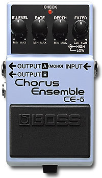

There's another ensemble called the Boss CE-5 Chorus Ensemble which I see is based on BBD chips (earlier versions at least) and doesn't seem to sell at such inflated prices as the DC-2.
How does it compare to the DC-2 Dimension C (and more importantly, the Roland VP-330 ensemble), and will it accept (or can easily be modified for) line-level signals?

Hi to all,
i am following this since years and after debugging here and there i found a way that solve distortion and signal/peak detector problems.
On the image attached you can find all the details.
Yellow: 500k to 100k already mentioned in this topic.
Orange: cut trace already mentioned in this topic.
Red: it should be 10k referring to okita schematics.
Green: from 47k to 10k reduce the gain sensibility so there is more space before reaching distortion
Blue: put the 1M resistor away and replace it with a 100ohm trimpot,
at the beginning i was quite surprised of that but now the signal led is working perfectly.
I still have 2 problems, maybe somebody can help me:
1: the 4053 is getting really hot (already fried one), at the moment i replace it with 3 spdt to get signal thru.
2: on the voice board the 356 has a strange behaviour, if i put it away all bands work perfectly if i put it in band 2,4,6,8,10 are "eating" the signal away, like they were inverted in phase.
 Filesize:  516.19 KB
 Viewed:  539 Time(s)
Are you sure for the value ? 100ohm is very different than 1M !
