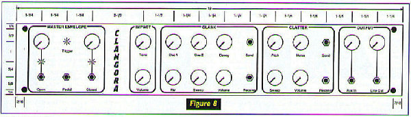

Yes, that's better. But don't think they have to be all in equal rows. It might make more sense to use something like this:
oo oooo oo
ooo ooo oo
o ooooo oo
ooo ooo oo
oo oo oooo
oo oo oooo
Or any of a number of other arrangements. Only you can know how you like to have it.
My main points are:
1) Can you see/identify which jack or plug you want easily?
2) Can you easily get to it to make a change when you want to? Consider worst case scenarios; when a majority of the jacks have plugs in them.
3) Does the planned arrangement of jacks help or hurt electronically.
Keep in mind that there will be wires going from place to place!<G> Behind the panel you will be going from PCB(s) to switches and pots and from pots and switches and PCB's to jacks. At least in most synth's this is the case. Very few use completely separate wires for pots, switches and jacks. There is usually at least some inter-wiring from components off the PCB. So just be aware of how the wiring will need to go from place to place. Whether it will need to be shielded or not.
FWIW, it's easy to get anal about this. And sometimes that's a good idea. But it is also true that many do get away with less than wonderful layouts and wiring practice. So don't be scared; but do try to become aware of the choices and possible results involved; so you know what to expect.
Randal

So if one were buying aluminum sheets to make faceplates from, such as, say, these:
http://www.amazon.com/Aluminum-5052-H32-Bare-Sheet-0-08/dp/B000H9OYV0/ref=pd_bbs_1/104-0843589-5404769?ie=UTF8&s=industrial&qid=1187703095&sr=1-1
Issues with others, such as a thin steel?
What thickness of sheet for each suitable metal would one want to use?
Recommended method of cutting aluminum sheets? Steel? Or is it time to find a real metalworker to cut to size, and content myself with mere drilling of pot, jack, and mount holes?
I did a Firefox word-scan for 'thick' in both pages of this thread, and only found one instance, with no details...

Aluminum is the way to go. It's light weight, strong, and easy to work with.
I would avoid steel because of the difficulty of cutting and drilling
in a home shop.
Some common and appropriate thicknesses for aluminum synth panels are .063" (1.6 mm), .094 (2.4mm), and .125" (3.2mm).
Blacet Frac panels are 0.063" aluminum and seem plenty strong.

what's the best way to deal with the straight cuts?
The best way would be a shear or bandsaw. A hacksaw will do a 'hackjob'.
Maybe theres a local shop that could cut panel blanks for you on the cheap?
If you get friendly with your local sheet metal smith, he might cut some up for you on his lunch break for a case of beer. Heat and vent guys have sheet metal shears also, me thinks.

How about working with the aluminum?
I have only a chop-saw, a dremel, a hacksaw, and an 18v cordless drill.
Obviously I can drill holes as needed, but what's the best way to deal with the straight cuts?
The best way is to have someone with more tools do that part for you! Very Happy
But if you add a good, sharp, new file or two to your tool list (coarse and fine, as one or trwo files) you can turn a hack job into a precision rank and file situation!
You're trading time for money. But you can certainly do excellent work by hand.
BTW, a 20 buck sabre saw (Some call this a jig saw) will take the pain out of cutting the aluminum to rough size. Get a fine tooth blade for the thin aluminum. Beats a hacksaw and is less expensive than other tools to do the job. (Squirt WD-40 on the cut line and blade for best results when cutting aluminum .) And when you file, do the opposite and use chalk on the file to keep it cutting well (get a block meant for concrete marking and layout at home depot))
Good luck! (But you'll develop skills to replace luck rather quickly, I think!)

i'm found myself quite lost with all these milimeters, inches and all...
I'd like to know hole spacings for mounting profiles, rack 19" :
http://export.farnell.com/1264830/electrical-circuit-protection/product.us0?sku=boss-enclosures-32275206&_requestid=152581
for sure no secret is revealed in the "Technical Data Sheet"...
my problem is that spacing is not regular (in fact there is two different hole spacings).
is the clangora panel a clue ?
(i guess it's inches)
1/4 5/8 1...
 Filesize:  350.68 KB
 Viewed:  1358 Time(s)

are you using the designer from schaeffer ?
there are macros with all the standard holes.
The pattern repeats every 1.75 inches. Google for "rack unit" to learn more.

For the 5U formats, some say [1] the actual height is 1/32" less then 5 times 1.75". Is this true for the synth modular formats (MOTM in my case), and does this apply to the width too?
Does someone have some basic-panels for MOTM, not in fpd (the Frontpanel Deisgner doesn't work in Linux, and however schaeffer mentions that it should work with Wine, it crashes when opening fpd files).
[1] http://en.wikipedia.org/wiki/Rack_unit
You mean like this?
http://www.synthtech.com/tech/m440_panel.pdf
