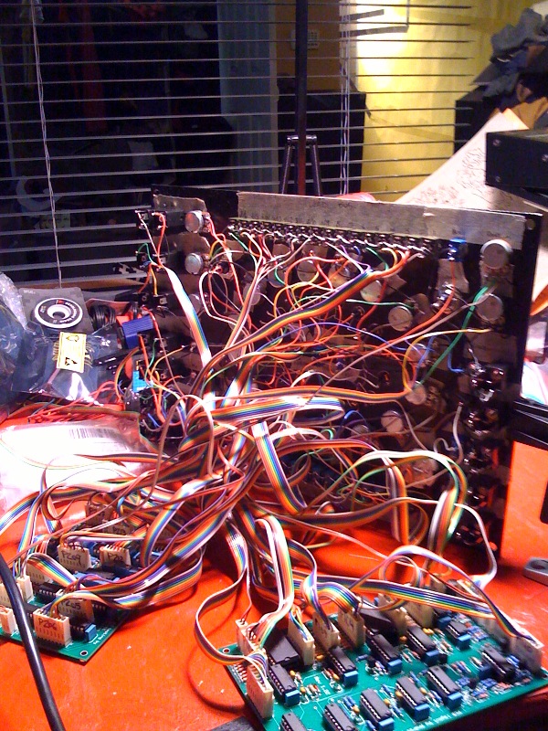

PostPosted: Thu Jul 15, 2010 6:46 am    Post subject: Klee Klee Klee!!! Reply with quote  Mark this post and the followings unread
So, all done wiring the Klee! Thanks everybody for this amazing sequencer. I have been playing with it using the step button and it really is amazing. If only I could load a pattern or have it run by itself... Embarassed I seem to be having the same trouble as mentioned earlier by Photon. I have the unit on and all 16 led's light in sequence and then they disappear in sequence, then light up, then... This is while I manually step with the step button. I'm getting cv out and gates and triggers as well. I have been trying to clock it with an lfo and another sequencer, but it just won't respond, though once I plug anything into the clock jack the clock led turns on. If I cycle the unit off and then on I get sometimes the aforementioned led cycle and other times a random display, but the load button in either case does not change this. I've tested the button and continuity is made when pressed. I'm wondering if anything more was found out in Photon's case. If anyone could help me figure this out it would be much obliged. Thanks. Embarassed

Okay. Pin 5 of U2 on the digital board is showing about 12.40 v and when I press load it goes down to about 12.33. Pin 6 goes from 0.00 to 0.07 when the button is pressed. Any ideas?
EdisonRex
Joined: Mar 07, 2007
Posts: 4579
Audio files: 172
PostPosted: Thu Jul 15, 2010 9:15 am    Post subject: Re: Klee Klee Klee!!! Reply with quote  Mark this post and the followings unread
Congratulations on making it this far. Can you tell me the make and type of 4034s you have? If you change to 2x8 mode does it do anything different?
Also if you put a single step pattern in (first pattern switch on) and load and enable clock, does it simply run through a single 16 pattern cycle and stop?
Relevant pages of the schematic are 2 and 3. On page 2, U3 pin 4 is your clock's output, you should see a clock pulse with your scope. There isn't a lot of logic involved after that point, hence asking about the 4034s, if you've read a bit you'll know there was a bad batch of them which are responsible for a fairly high amount of problems.
Also check U9, pins 4 and 14. They should alternate in 1x16 mode.
Does invert B do anything to influence the outcome? it should turn each light in 9-16 on progressively if you have entered a single stage pattern in stage 1.
Also, if you single step does it work ok?
ok I just read your other post too, check that load switch. It should have pulled that down to logic low.

Also, the step button works without trouble. And would it be relevant to report that when I plug in to the ext clock jack it turns on the clock led and gate led's and when i remove the plug from the jack it stays on until I cycle power.
The step button does not use U2 in its circuit, which is why I suspect U2, which is common to the other malfunctioning circuits you are mentioning.
Another test is to try to manual step your way through a Bus 1 Load. If that works, I would have another look at U2.

I have a signal getting to U5(4013), but nothing coming out of any of the other pins there. Could this be the problem?

To back up a bit, bus 1 load did not work when stepped. I checked the path of the load button and the pulse continued into the 4013, but then did not exit from any of the other pins. All other IC's seemed to work fine until that point. I just want to see a proper load, then I will move on to the clock issue.
So you saw a pulse at U3 pin 10? Even if you press manual load switch? hm.
Well, check your traces on the board. It's a complicated build and one blob of solder can make trouble. It is entirely possible that you have one or more bad chips, which will complicate debugging. However, if you see nothing coming out of U5 pin 1 when pulses are present on pin 3, it implies either the 4013 is fried or something else is holding it up or down. U2, however, is involved in that part of the circuit now I look too, so that might still be the problem... still looks to me like everything you're having a problem with has something to do with U2.
Yes, the problem could be along those lines. IIRC, on Photon's Klee, a couple of the feed-through's had become disconnected from the traces.
A good, tedious session of point to point resistance checks might help.
E-Rex is quite likely right also with the reason why the LEDs alternate between on and off.
Another problem would be that the clock LED should go off if no signal is applied. But, one thing at a time.
If this is leading nowhere fast, you can send the Klee to me and I'll get it working - no one should go through the hassle of building one and then have it go nowhere. Just return postage is all I would require (just to keep the wife off of my back regarding expenses). It would be a pleasure for me.
Take care,
Scott

That is an UNBELIEVABLY nice offer. Shocked I want to make sure I exhaust every possible thing I can do on this end first though. Especially after such a kind offer as that.
Also, I swear the plan is to clean up my wiring after I get it running... Embarassed
Traded out all the chips in question, and I am still having the same issues.
Then...
I fed a clock signal into the clock jack, and when I flipped the clock in switch, it stopped my sequencer. When I switched it off, my sequencer went back about its normal LED chase sequence life. Now, I never saw anything instructing me to do so in the Klee build, but I thought I should ground the incoming clock switch to digital ground. Is this not something that should be done? Is this one of my very likely to be many problems in the build?
I have obviously gnarled this thing up in all sorts of foolishness. I'll do the point to point tests, though I leave for tour in 2 days, so it will probably have to wait for a bit.
Thanks to the both of you for your help! One day this thing is going to SING!

That wiring job doesn't look any worse than most of the ones we've seen.
Scott is awesome, in case you never noticed.
Good luck. If you get a chance please check your wiring. The wiring instructions are quite explicit so if there's a question, post it here.

hey EdisonRex, thanks for the reply Smile
in light of your response, i have expanded and updated my search a bit so here it is below:
• 3 x 100k linear panel mount pot: mouser 531-PC16SC-100K OR mouser RV120F-10-15F-B100K
• 16 x 50k panel mount pots: mouser RV120F-10-15F-B50K
• 3 x 1m linear panel mount pots: mouser RV120F-10-15F-B1M
• 16 x pattern switch SPST on-off: mouser 1055-TA2120-EVX OR rapid switch
• 16 x Gate bus switch SPDT on-off-on: mouser 1055-TA2135-EVX
• 8 x switch SPST on-off: mouser 1055-TA2120-EVX OR rapid switch
• 2 x switch SPDT on-on: rapid switch
• 18 x 1/4 inch jack sockets: mouser 502-112AX OR mouser 568-NYS229 OR mouser 568-NYS229L
• for 22 red LEDs - holders: Lens mounts @ Rapid OR OTT holders : LED holders
• 1 x SP8T Rotary dial: mouser 105-SR2611F-18-18NS
• 2 x SPST (on)-off pushbutton switches (do the brackets around the on mean momentarily?): Digikey EG1938-ND
I've had a hunt through various posts over on muffs (link and linky) and it looks like 'modularplanner' has asked a few similar Qs there already. So i'm consolidating the findings in this post which is duplicated over at muffs too.
I'm also looking at how to power the Klee once built, and, looking at this post, think i should buy a MOTM 990 or an Oakley one mentioned here - i reckon i'll be building something remotely modular in the future, so i guess it'd be the right way to go.
the above stuff is looking fine, but if any one has any comments or alternative suggestion, please reply. i'll be getting this lot OR a set of bits from Bridechamber if they reply soon.
thanks in advance Wink

Make sure you get switches from the same brand for all toggle switches. Mixing those up will give a strange looking Klee, especially if the metal colours are different, or the length of the lever differs.
Remember you can use SPDT on-on for SPST on-off, just don't solder anything to one of the two outer lugs. Other good thing of using this: most of the time there are deals when you take 25 of one type. With 16 pattern switches, and the 8 SPDTs, you're already on 24.
Pot style is a matter of taste. I used sliders for mine, but I have seen many nice Klee panels with rotaries too.
Again, it helps when all pots are of the same brand, so the feel when turning is the same. Smile
EDIT: another trick that I can highly recommend is buying some pre wired connectors. Saves a lot of time when building a Klee, and only costs a few cents more Smile
I got mine at MusikDing (http://www.musikding.de/forums.html/cat/c158_PCB-connectors.html), but I think they are available in other shops too.
