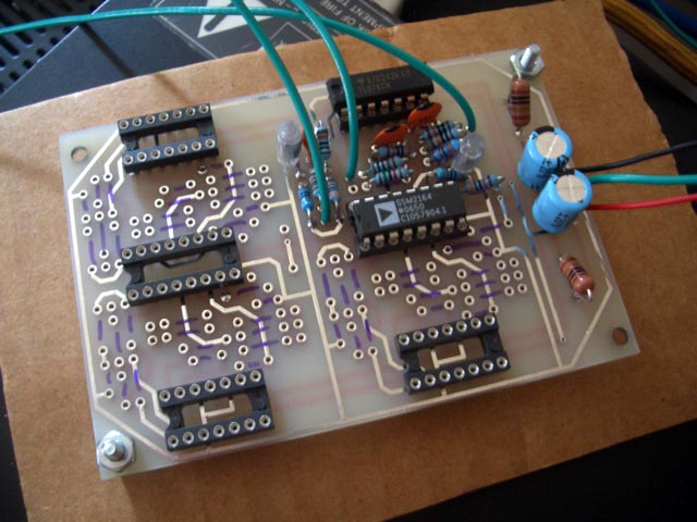

This VCA was fine on the breadboard, but now that I have finally gotten my boards made, and populated the first quadrant of it with the LAST of my applicable parts...NADA!!! No signal is passed, no nothing, what a drag!!
Anybody have a nice build of this running that could give me some voltages etc. to look for?? I have checked the layout vs. the schematic 10x+, it is spot on. Very confusing and maddening, I spent far too much of a beautiful Saturday inside trying to figure this one out.
Should have some more parts by the end of the week to re-breadboard it to test, but if any kind soul can lend a hand I would be most appreciative.
EDITED!! Man am I stupid, murphy's law indeed, sometimes we miss the most obvious things, and I mean THE MOST OBVIOUS!!!
Hats off to Thomas for this great simple VCA.

Coriolis
Joined: Apr 11, 2005
Posts: 616
Location: Stilling, Denmark
PostPosted: Sun Aug 10, 2008 10:37 am    Post subject: Reply with quote  Mark this post and the followings unread
Aww, c'mon - tell us what you did! Very Happy
Actually I recently finished one of these (fonik's dual vca layout), and it worked right off the bat! That's rare for me...
C
numbernone
Joined: Aug 16, 2006
Posts: 477
Location: new york city
PostPosted: Mon Aug 11, 2008 5:52 am    Post subject: Reply with quote  Mark this post and the followings unread
Lets just say it was a missed connection...
A rather IMPORTANT one...
Very stoked with this one, this is going to provide me with not only regular old VCAs, but big banks of voltage controlled mixers, and eventually quad panning joystick modules. I imagine I will think of some others as well.

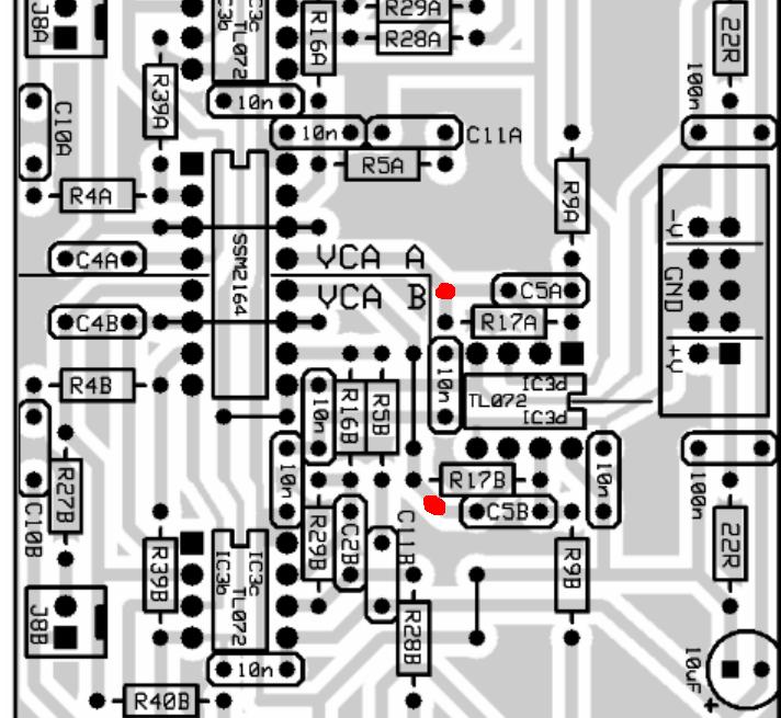

PostPosted: Mon Jun 22, 2009 1:14 pm    Post subject: Reply with quote  Mark this post and the followings unread
I'm planning on building this dual VCA using Fonik's layout and I want to add the line out jack as well. If I drill holes in the PCB at the points marked in red below, would they be good places for me solder in one leg of R13 (the other leg leading up to the attenuator)?
