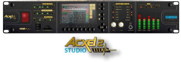

PostPosted: Mon Jan 11, 2010 5:19 pm    Post subject: Reply with quote  Mark this post and the followings unread
My eagle-eye saw this Question :
EDIT: updated pic with higher res from the new user guide pdf.
 Filesize:  51.1 KB
 Viewed:  783 Time(s)

PostPosted: Mon Jan 11, 2010 6:20 pm    Post subject: Reply with quote  Mark this post and the followings unread
Well spotted TekniK Smile
On the Acxel site there's a new brochure now. Click here to get it. It has some more images of the updated hardware design.
