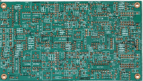

PostPosted: Fri Jul 11, 2008 3:32 am    Post subject: Reply with quote  Mark this post and the followings unread
This was in the mail today!
(BBD board only, so don't get overly excited yet. Smile )
JH.
 Filesize:  169.23 KB
 Viewed:  29782 Time(s)

News about the Dim D:
Tested the BBD board (which is one half of the Dim D project) - works great.
Tested with TL071 / 072 opamps so far. Will test with HA1457 soon.
JH.
... and it works with HA1457W's too, so I guess I got the footprints right. Smile
Which means, you'll be able to either build that effect using vintage NOS SIL package HA1457W chips, or TL071 / TL072 chips.
When you're using sockets, you can try what you like best.
The 47pF compensation caps for the HA1457W's are on the PCB, too.
(automatically disconnected when no HA1457's are in the SIL sockets)
Moving on to design the Main Board now.
JH.

Update: Main Board design finished
I've sent the Gerber data to Olimex for making a prototype PCB.
Let's hope this comes back ok - then maybe I can keep my promise to make the whole Subtle Chorus project available in 2008.
JH.
kokoon
Joined: Jan 09, 2006
Posts: 158
Location: slovenia
PostPosted: Wed Oct 29, 2008 4:00 pm    Post subject: Reply with quote  Mark this post and the followings unread
great news! can't wait!!!
