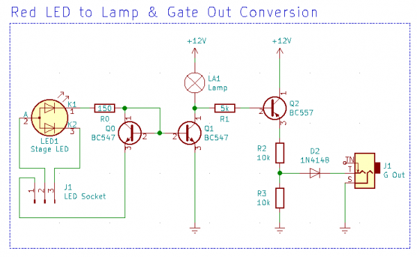

Are there any plans for a 5U version? I've spent the evening messing about with a design that I'd be planning to build if there's nothing in the works.
I've decided to give it some more moog 960 features but I think I'll have to bang my head against the circuits to drive these tomorrow.
EDIT: I've added a schematic for the additions; as my electronics knowledge is rather limited any comments on feasibility and idiosyncrasies would be appreciated.

Hello
Looks nice !
My design is to use the large 8way slide switches, and orientate vertically.
But I assume you are going for more of a Moog vibe.
PS the stage LEDs are common anode.
Would a current mirror inline with the LED do the job then? Or do you think an optofet might be a better choice to bypass that half LED completely?
Lamp Driver V2

nativeVS wrote:
Looks like it might work.
I bow to your transistor knowledge !
