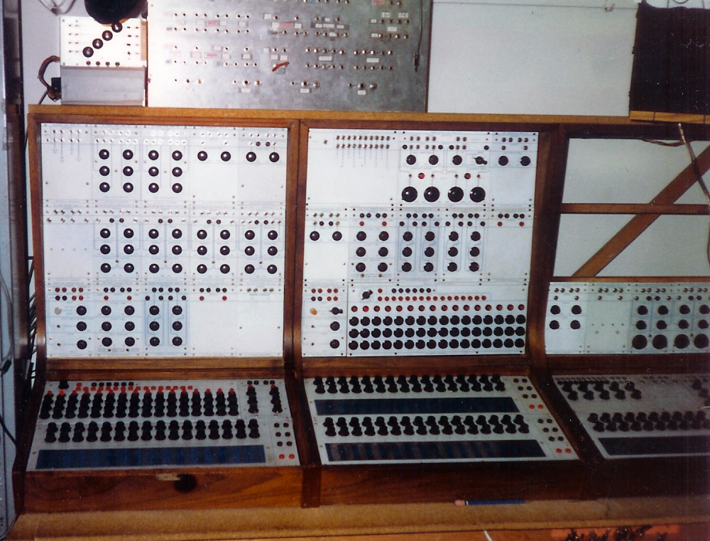

Speaking of the Buchla that I used to work with, here's an incredibly bad photo of our setup. When we had to close the studio down, I understand that the system was the subject of a small bidding war between the Smithsonian and the Stearns Musical Instrument Collection (at the University of Michigan).
Note the four model 112 touchplate keyboards! Also, just for Fonik--there's a model 292 quad lowpass gate in the upper left. It was from a later generation of modules, so it needed its own power supply--that's what's in the duct-taped box beneath it.
I've been missing this machine since 1994. Crying or Very sad
Thanks,
Ole

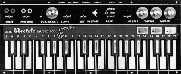

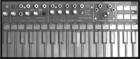

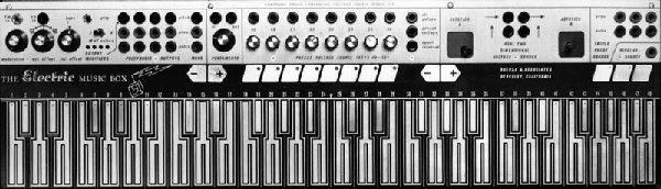

The shape supposedly isn't too crucial. I doubt if many have been tried though, I have seen only circles, ovals, squares, and rectangles of various sorts. Photos of Serge pads seem to indicate that they are only circular pads which are separate from a large ground plane. So there's a small solder pad which comes off of the touch plate for affixing a wire behind it, and a single ground connection for the rest of it.
The Buchla keyboards appear to use several rectilinear patterns. I have seen keys which are nested "U" shaped figures, perhaps alternating signal and ground. As I recall now, pictures of the Music Easel had shown touch plates in the shape of miniature piano-like keys. Here are some pics.
I like how Buchla expanded the idea with more touch button surfaces and psuedo ribbon controllers. I don't know anything about RF electronics but it appears that there is a lot we can try here.
