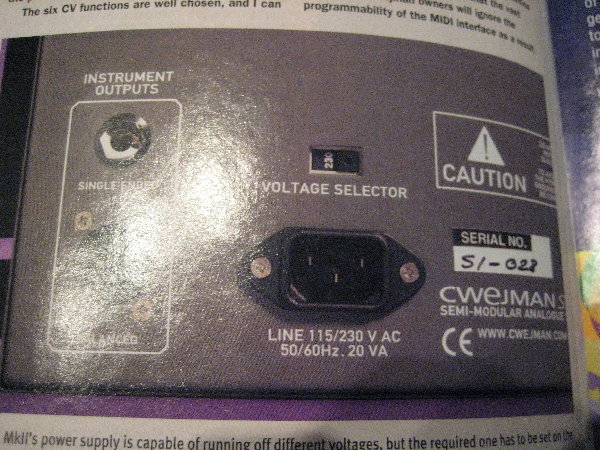

It is the S1MK2. Interestingly enough, the front panel says S1, but the back panel says S1MK2 as well as my manual. Looks like Wowa put the full name on the front panel on the newer units.
Anyone who wants a full in-depth review of the S1MK2 should also check out the soundonsound article (published in August 2004) below.
http://www.soundonsound.com/sos/aug04/articles/cwejman.htm
Sound, is your S1 the MK2 version? What I'm finding odd is if you purchased your S1mk2 from Wowa in April 2006 you should have a later serial than 021. Unless he screwed up the serials. The soundonsound article shows pictures of an S1mk2 for the review and it's serial is 028 (I have the article, it doesn't show up on the web edition). This is back in August 2004. How then can you have 021 purchased in April 2006? Further, my serial appears to be #71, which would seem right given the incremental numbering from the 2004 article above to 2005 when I purchased my unit.
Maybe you can include some pictures of the front/back panels of your S1. If Wowa screwed up the numbering some expanation is in order.
monads

I didn´t know it! ... My S1 is labeled as a MK2 in the front panel as well in the back panel. Maybe he resets the serial number when he change the front panel?
I did test the "external input" and "white noise output" of my S1mk2 and didn't notice any crossed signals or problems.
These jacksockets are wich are failed in my S1, but it can be in any jacksocket, the majory have the circuits passing under them.
I noticed from eye's view the Cwejman S1mk2 appear a 'hair' longer than the other ones I have. I've never really used the patchcords originally supplied with my S1 so maybe this is why I haven't had any issues?
Yes, if you are using jack plugs shorter than 14,2mm you can not touch the PCB nor debaste the greenpaint, nor short the cooper of the circuits with the tip of the jack plug.
The Cwejman S1mk2 supplied patchcords, at least mines, measures within 14,4 to 14,8mm
I found this plug jack that measures 15,5mm
It appears the serials were reset when Wowa added MK2 to the end of S1 on the front panel?! It's puzzling to me and makes no sense.
Makes me worry now since it can happen on any jack-socket depending on how frequently used. Only thing I feel positive about right now is I never really used the Cwejman supplied patchcords. It was just blind luck I used my other ones, and these tips don't appear as long as the Cwejman ones. Maybe that's all I really needed to not damage my PCB.
In the long run it could prove problematic without a solution or exact measurments confirmed from Wowa Cwejman. I do remember (and still do) patch with these patchcords. I haven't noticed any problems, then again I haven't tested every jack-socket to be 100% sure. I didn't know there were different 1/8" patchcord "tip" lengths for these synths either.
I think a solution & statement from Wowa is warranted with these concerns/findings. We're talking about a $3,000+ instrument here in the states and the PCB becoming damaged from normal patching is unacceptable. That's the main feature. Sure the problem may be fixed on newer S1mk2s, but what about the customer base who has the previous version? Currently there's no statement or solution. Heck, no one would even know about this issue unless Sound came forward (thanks by the way!)
As it stands right now, this is a pretty big issue for earlier S1mk2 owners/users.
Pic from the soundonsound article showing serial 028 used for the review.
 Filesize:  3.61 MB
 Viewed:  693 Time(s)
