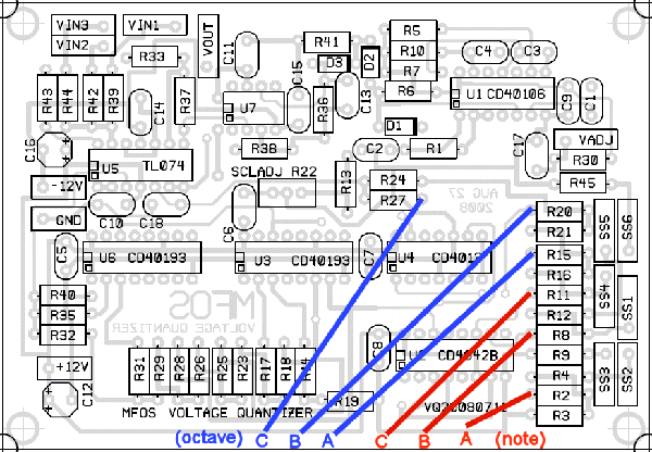

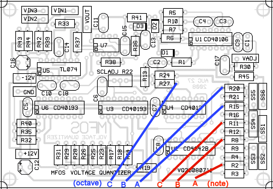

I hooked wires on the marked ends of R2, R8, R11, R15, R20 and R27 to do this. Worked a treat. Very Happy
How did you do this exactly? I've tried to hot wire a board in this fashion before and had a difficult time. Do you have a photo you wouldn't mind sharing? Do you actually get the wire to fit into the pad along with the resistor lead or do you leave the resistor high enough off the board to leave enough of its lead exposed to wrap and solder a wire right there on top of the board?

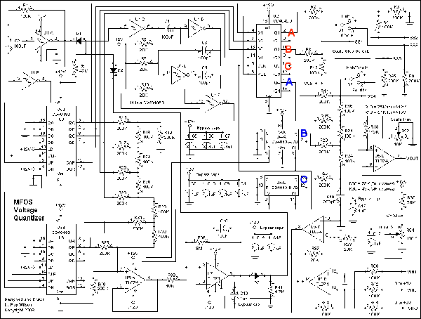

Pretty much the way it looks in the drawing. After populating the board, I took wires stripped at both ends (like they were to be soldered through a hole to a pad), but bend the one end into a hook, and slip the hook under the resistor lead in between the resistor body and where it goes through the hole. There's no heat issue soldering like this with resistors and ceramic caps, BTW.

Gotcha. Thanks for the explanation and photo!!

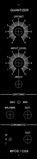

Below is a preliminary layout for my dotcom panel.

Thanks so much for all the info! One more question - for the diatonic Maj/Min what is the configuration - do you get Maj on a pos part of the input pulse (or when the toggle switch connects the Maj/Min input to +15V) or would that engage Minor mode?

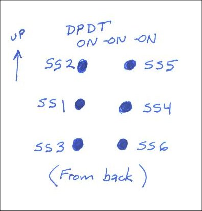

Sorry, actually another question - for the MFOS switch, instead of the 2 switches I see you have 1 - is this an ON-ON-ON DPDT? If so, how do you have it wired?
Also what value and taper pot did you use for the voltage input attenuator?
Thanks again.

Close. Voltage input (with attenuator), offset control (manual voltage input, same as "inital v" on the MFOS website panel), toggle switch to select between half step, whole step and fourths, and output (all for the MFOS quantizer board). For the diatonic part, a switch to manually select major/minor, jack for major/minor select, and diatonic output.
I used an ON-ON-ON DPDT switch used as Matthias so nicely explains on his website (it's in one of the other threads around here somewhere). It helps to understand how the switch works, and use an ohmmeter or continuity checker on the switch as you toggle it to make sure you have it right. The picture below shows what the connections I used to the MFOS card. Any ON-ON-ON DPDT switch can be wired like this, but you may have to swap sides (or flip the orientation of the switch) to get the right results.
