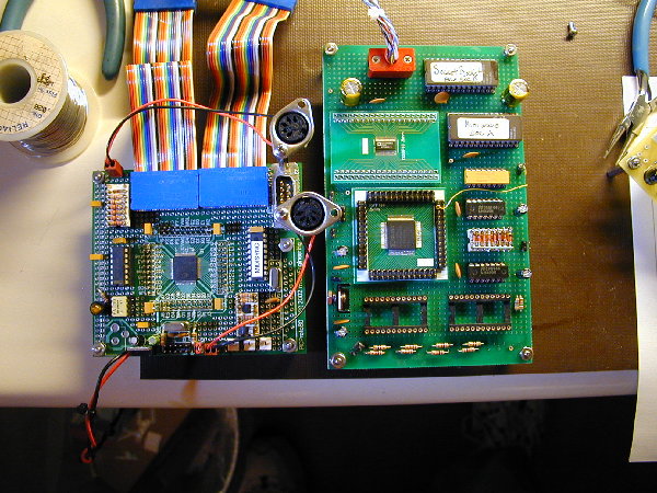

If you like to do the surface mount soldering yourself, which is what I did, I used this prototype board from "MCU Mart" (Micro Engineering Labs) which will allow you to mount this 80 pin QFP chip onto it for your experiments.
http://www.cippsites.com/Merchant4/merchant.mvc?Screen=PROD&Product_Code=PP80&Category_Code=PROTO&Store_Code=melabs
Here is a picture of the ME labs baord on the left with some associated support circuits in the prototype area ....

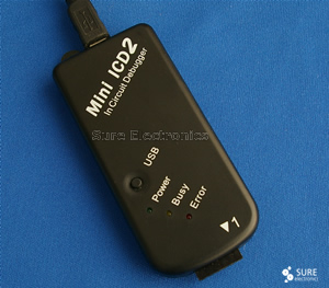

Yes, funny when the programmer is more than the controller itself Very Happy There is an Ebay store called "Sure Electronics" That sells these ICD2 in circuit programmer, debuggers. I have bought things from these guys before so I would trust them. This programmer is usually sold for about $55.00 and free shipping Exclamation You might want to check this out. I am not sure if you can get USB connected ICD2 programmers any cheaper. Wink If you do, please let us know ............
Bill

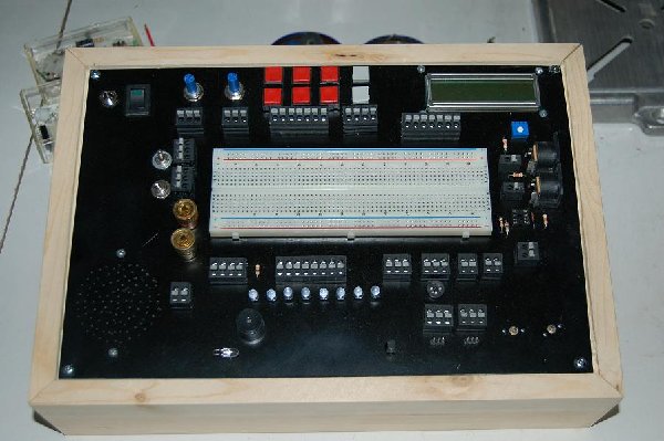

I just made my own board, this is the prototype, I am going to do a few more with proper silkscreening to designate the components, there is a full description on my website, click on "Pic Workstation"
Very nice Dragon Cool Plenty of switches, pots, LCD Display, LED's, hell even MIDI connectors !! Looks like a handy development platform Wink

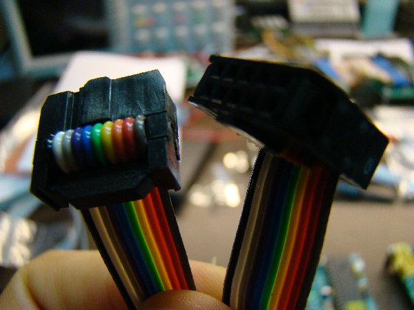

Also, I purchased a bunch of the 10 position IDC connectors and 10 meters of multi color ribbon cable to make my own cables for their boards. I found a decent IDC connector press on Ebay for about $20.00 that's works just fine. It's much cheaper to make you own cables. Here is a sample of my cable ends .........

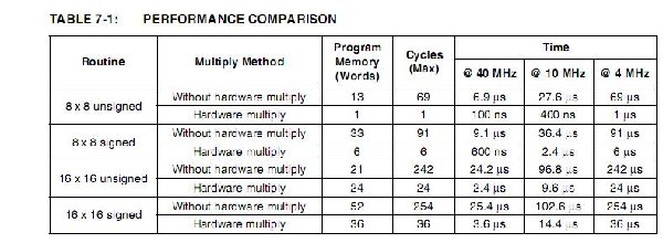

This board has a 6 MHz xtal... With the 4x PLL deal, equivalent of running it at 24 MHz - looking at the datasheet for the PIC, it looks like most instructions (including the hardware 8x8 multiply) execute in one cycle - wouldn't that mean that for the most part, it runs at 24 MIPS or nearly 24 MIPS ?
Scott, actually, 6 MIPS. Each instruction executes every 4 oscillator clocks. It would be (6 MHz x 4)/4 if you enable the HS-4xPLL. The 4 cancels of course. The MCU has no pipeline for instruction parallelism. There is, however, an instruction pre-fetch that takes place during one of those 4 clock cycles. If you want 10 MIPS, you must install a 10 MHz crystal and enable the PLL. If greater performance is needed, you may opt for the 24F 16-Bit MCU's or the DSPic series but this may be too late.

PostPosted: Wed Sep 17, 2008 4:34 pm    Post subject: Reply with quote  Mark this post and the followings unread
Multiplier specifications for 18F family devices ........ just click on it to read it clearly

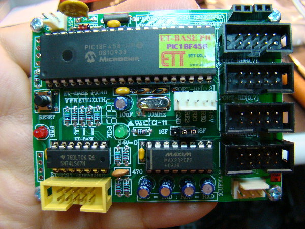

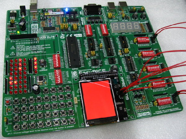

Here is an example of some of the development boards being sold on Ebay. Just type in the search word "PIC DEVELOPMENT" and you will see a bunch of these type boards !! Here is a picture one that has a cool graphic display .... nice !
 Filesize:  438.07 KB

Ah, I see. 1 cycle for unsigned, 6 cycles for signed. (8x8). Interesting that they call it a "single cycle multiply"... You need to use more than one instruction for a signed multiply, so the multiply instruction itself is 1 cycle, it needs other code to extend it beyond unsigned....
