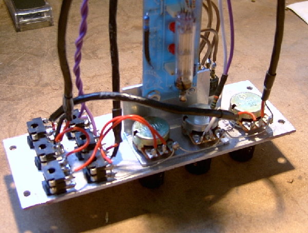

Dave Kendall
Joined: May 26, 2007
Posts: 421
PostPosted: Tue Sep 23, 2008 6:25 pm    Post subject: Reply with quote  Mark this post and the followings unread
Hi all.
For smaller formats (eurorack) I use 25mm x 25mm x1.5mm aluminium angle from the hardware store. All you need is a hacksaw, centre-punch, drill, and something to de-burr the holes. ( I sand mine down afterwards, but that's optional)
Nuts and bolts to hold PCB onto bracket are M3. The photos show a short length, holding a CGS65 tube VCA with clean/dirty mod, feedback pot with separate normalled I/O jacks, and 2 CV inputs jacks. The pot that doesn't go through the bracket is spaced from the panel rear with an M8 washer.
It's cheap, small, and strong enough. Smile
