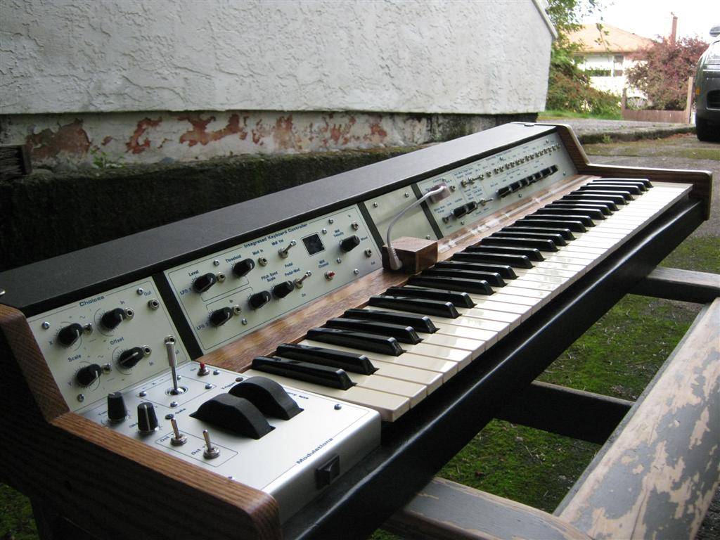

PostPosted: Sat Sep 18, 2010 7:29 am    Post subject: Reply with quote  Mark this post and the followings unread
New pic of my finished IKC controller
More over on the Appendage thread

PostPosted: Sat Sep 18, 2010 3:42 pm    Post subject: Reply with quote  Mark this post and the followings unread
javascript:emoticon('Shocked')javascript:emoticon('Very Happy')
Slo,
Dang! That turned out even better than your early pictures indicated! I think this is what Bill and I envisioned when putting this thing together. Thanks for sharing your picture!

PostPosted: Sat Sep 18, 2010 5:54 pm    Post subject: Reply with quote  Mark this post and the followings unread
Thanks Dan and thanks for yours and Bill's effort, your controller was a big inspiration to me, and the build doc's made it a lot easier. I don't think I'd do anything different with mine, it feels and operates just right with a ton of modulation possiblities in front of me.

PostPosted: Sun Sep 19, 2010 5:52 am    Post subject: Reply with quote  Mark this post and the followings unread
Oh my Slo !!!!!!!!! What can I say but wow! !!!
I agree with Dan, this is certainly what he and I envisioned. I wish more folks saw the value in the project. We always believed it ranked as one of the top DIY controllers out there Wink
You have made my day sir !!!! Thanks so much for posing that.

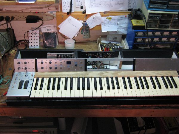

PostPosted: Sun Sep 19, 2010 8:16 am    Post subject: Reply with quote  Mark this post and the followings unread

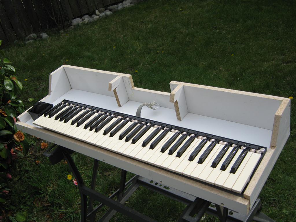

Thanks Bill and for all your help and parts for this project. The IKC I've built is divided at the rear of the keys into 3 sections. I don't have real good shots of the insides but these should give you some idea of how I built it. The left section holds the power supply, the bend circuit and the Choice PCB. The center section holds the IKC PCB, a power distibution bar and the rear panel. The right section holds the Appendage PCB. There was suprisingly lots of room and nothing is cramped back there. I was hoping I could get the geometry right to make the front panel pivot, but it didn't work out that way. The front panel are mounted to 2 long aluminum .5 inch angle, with movable separators.

Posts: 2810
PostPosted: Sun Sep 19, 2010 9:49 am    Post subject: Reply with quote  Mark this post and the followings unread
Slo, thanks. If you were striving for a "vintage" analog keyboard look, you certainly met your goal. I am looking at the details of the cabinet. I am not very good at doing wood working and probably the reason why I have procrastinated in making the enclosure for my Appendage/IKC. I have some really nice GOLD anodized front panels I designed and had manufactured for it. I want to have it ready for EM 2011.
Which keybed is that one? A Fatar? Is it mounted on standoffs? Some details would be appreciated. Wink

PostPosted: Sun Sep 19, 2010 12:16 pm    Post subject: Reply with quote  Mark this post and the followings unread
The keyboard is out of a Yamaha keyboard, I rewired it to the needed matrix (this was the worst part), so no need for convertor board. No standoff's used, the keyboard had 5 mounting holes and I just made a bracket for the corner with no mount. I studied your gold Appendage panel a lot to get all the controls right for the Appendage, it's nice. As for woodworking skills, I'm no craftsman, I just used pressboard, covered it with vinyl and used some scrap oak from the delete bin at my local hardwood store. A good table saw comes in handy.
