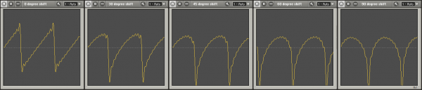

No it won't *look* like sawtooth, if we are talking about the shape of the wave (which will change) and not about it's harmonic content and sound (which will stay the same).
Even if the dome filter would do 90deg shift, it would not look as saw-wave anymore. Imagine the saw-wave decomposed into its sine-wave components - each component has a different wavelength, so for each of them the 90degrees shift means a delay by different time... When you add them up back together, the shape is different. (i believe it's like that for all waves other than single pure single sine-wave without any harmonics and for any amount of phaseshifts except for 0deg and multiples of 360deg)
...and this dome filter doesn't do 90deg phase shift to the input anyway. What this dome filter does, is creating two outputs with 90deg phase shift between them. So it is not 90deg phase shift between input and output, it is between output1 and output2. And neither of them will look like saw. But will sound the same.

PostPosted: Fri Sep 02, 2016 9:39 pm    Post subject: Reply with quote  Mark this post and the followings unread
Found my old patch, where I was checking exactly that - how a saw would look after various phase shifts.
Attached a screenshot of 0/30/45/60/90 degree shifts. (It's not very smooth as the saw is made using 12 sine oscillators...)
