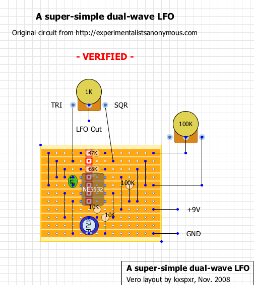

I made a vero layout from Colin's Super-simple dual LFO:
http://experimentalistsanonymous.com/diy/Schematics/Oscillators%20LFOs%20and%20Signal%20Generators/Simple%20Dual%20LFO.gif
Just finished soldering it. Works like a charm Smile

PostPosted: Thu May 03, 2012 3:51 pm    Post subject: Reply with quote  Mark this post and the followings unread
It works!
How to get bigger output voltage?
apart from adding another opamp?
JovianPyx
Joined: Nov 20, 2007
Posts: 1988
Audio files: 224
PostPosted: Mon Nov 24, 2014 10:55 am    Post subject: Reply with quote  Mark this post and the followings unread
The 68K resistor is close to 1/2 of 100K, this is limiting the output voltage swing. This resistor must be less than the 100K feedback resistor. Try increasing the 68K by adding other resistors in series, 27K might be a good place to start (68K + 27K = 95K). If it stops oscillating, then it's too large. I don't know what precision level your resistors are, but you should know that just because are resistor says "100K" doesn't mean it's exactly 100K, it could be a little more or a little less. Another way to maximize the output swing would be to put a pot (say, 50K) in series with the 68K (wiper and one side). Then increase it until it stops oscillating then back if off until it starts to oscillate again. Remove the pot and measure with an ohm meter. Then find a suitable fixed resistor to put in place of the pot. Make sure that the fixed resistor is less than or exactly equal to the pot value. You should verify this using the ohm meter.

Ayab
Joined: Oct 27, 2015
Posts: 186
PostPosted: Mon Dec 07, 2015 8:25 am    Post subject:
Subject description: Dual-wave LFO Vero layout
(Again resurrecting a thread - but I think that is a good thing really Cool )
Thanks Jovian Pyx for referring this great layout and for all the information.
I am just wondering why there is no connection for -V
Do I just wire up +V and ground with no -V?

PostPosted: Mon Dec 07, 2015 8:34 am    Post subject: Reply with quote  Mark this post and the followings unread
Yes, referring to the schematic, I see a single rail (+9v) and ground. However, he creates an "internal" virtual ground that he calls "Vb", so the opamp can work properly. So this circuit needs only one positive rail and no negative rail.

Been trying the socketing but is a bit fiddly. Maybe putting a variable resistor makes more sense. So if I put a small variable resistor (20k) in series with the 68k that should adjust the range?
JovianPyx
Posts: 1988
Audio files: 224
PostPosted: Mon Dec 07, 2015 6:27 pm    Post subject: Reply with quote  Mark this post and the followings unread
Yes, that would adjust the amplitude of the output.

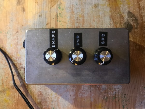

PostPosted: Thu Oct 03, 2024 10:49 am    Post subject: Reply with quote  Mark this post and the followings unread
Hi
I did built this with success. Thanks for the layout.
However I would like to decrease the slowest speed of the lfo. Is this possible and how?
Ayab
Posts: 186
PostPosted: Thu Oct 03, 2024 5:40 pm    Post subject: Reply with quote  Mark this post and the followings unread
The speed of the LFO can be altered by increasing the size of the 1uf capacitor and the 100k potentiometer.
Try a 1m pot and a 2.2uf capacitor, this should be a good start
It is important to use a non-polar capacitor i.e. a film capacitor
You can keep the 1uf and add the larger capacitor with a switch for flexibility
1rrah
Joined: Oct 03, 2024
Posts: 2
Location: Finland
PostPosted: Fri Oct 11, 2024 12:11 am    Post subject: Reply with quote  Mark this post and the followings unread
I did add a 1uf pot in parallel and 1m pot as suggested. The range is now much more in my liking. Thanks! Will think of adding a switch and possibly one more cap to go even slower.
I also added a 10k pot as voltage divider to the output. This to attenuate the voltage swing in addhoc basis. Currently the pot has an effect only at the very end of its range. Wiring is so that waform output goes to lug2, output jack to 3 and ground to 1. Might this be better implemented in parallel with 68k resistor?
My aim is to limit the overall voltage to 5v and have 0-5v range available from potentiometer.
While checking the voltages, I noticed that the swing is now 1.3–9.5v. So there is a bit off voltage even on the down slope. Wonder why?

Ayab
Posts: 186
PostPosted: Tue Oct 15, 2024 2:09 pm    Post subject: Reply with quote  Mark this post and the followings unread
Great looking unit! I like the type tape labelling where did you get the machine from? Glad you like the range with 2.2u & 1m. And of course you can use a 3 way centre off switch with 3 speeds of capacitor Cool
I can only suggest to try your idea of parallel with the 68k and hope works: i do not have a picture in my head for these things but others on here are more experienced maybe they will help. Maybe you need a 5v zener in there?
