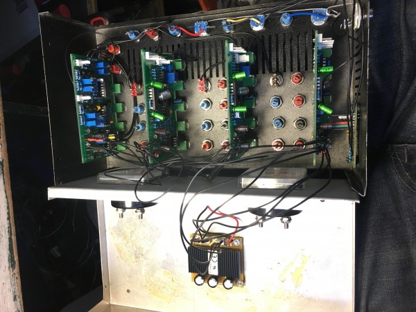

I'm in need of a little help with a Living VCO's build.
I made a standalone box using 3 of the Logicgate 2014 Barcode edition 1.3 Core PCB's and one of the Logicgate / Thomas Henry 2014 V1.1 Driver PCB's. I think these pcbs were original meant for a Euro build, which I'm not interested in. I need a standalone, easily transportable performance box
I'm finding it very difficult to find any pictures of the bare PCB's as I forgot to match resistors.
Also, I'm finding it impossible to find any calibration specifically for this set of PCB's. I know that some of the function will relate to the original calibration instructions but I'm wondering if anyone has built with these PCB's.
 Filesize:  2.55 MB
