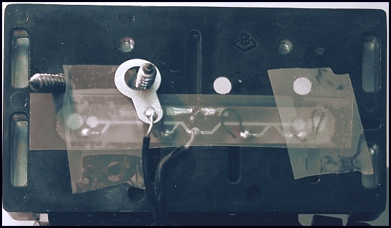

I bought a new one just yesterday and although it's a wonderful instrument, its electronics are almost useless...
First of all the bass has the looks. An audience will know for sure what kind of music they can expect by just seeing the instrument on stage.
Secondly playing it is pure joy! It plays smooth and easy and compared to my two double basses (9/10 and 3/4) it's like taking a break.
The strings and finger board are capable to get a wonderful intonation and expression to the tone. I was surprized!
Using a strap I can play it like a normal bass guitar and when using 'The Stick' technique tapping the strings with both hands my under arm may rest on the flat side Smile BTW the strings produce very nice over tones...
Going to the practise location will be much easier then transporting a double bass: I can leave the car at home Smile
Only the electronics, which are very important, sucks.
Hum, crackling, buzzing, you name it, all is delivered with the music, even a distortion on just one string. Sometimes it's clean and how it has to be, but only one movement of the instrument, like replacing it to another side of the room, is enough to get in trouble... To bad!
Now I'm thinking, besides returning it to the shop, to replace the electronics. Somebody has some experiences with that? I want to play this instrument. To me it could be a wonderful addition to my creative needs Very Happy

A little follow-up from Harmony-Central. Apparently, you're not the only one to have experienced problems of this sort.
Cliky da linky:
http://reviews.harmony-central.com/reviews/Electric+Bass/product/Dean+Guitars/Pace+Bass/10/1
Lin Yutang (1895-1976)
Wout Blommers
Joined: Sep 07, 2003
Posts: 4529
Audio files: 123
G2 patch files: 12
PostPosted: Mon Dec 29, 2008 6:29 am    Post subject: Reply with quote  Mark this post and the followings unread
Yep!
I found this review!
This is a follow up to my previous review. I was playing a gig and suddenly the bass developed a HUGE hum during the first set. It went away but as I was waiting to go back on at the end of the night (it was a one day mini-festival and the act was opening and closing) I was jamming backstage and the hum returned big time, but intermittently. I ended up using my Precision for the last set.
As I had to fly out to Goulburn for the Australian Blues Festival a couple of days later, and I can't trust any of the local so-called repair people to respond in a timely manner to what was an emergency for me, I decided to do some trouble-shooting myself
Obviously it was a grounding issue so I decided to start at the bridge - voila! This bass has a problem with it obviousy being designed to be slung together quickly by unskilled labour. The ground wire comes out of a hole drilled in the body between the electronics cavity and the bridge then the bridge is just clamped down on top of the wire. After a time, the wire presses a little indent into the body wood, becomes loose, and contact between the bridge and the ground wire becomes intermittent.
Easily fixed by someone with some basic electronics skills (like me), but not something which should be an issue on a nearly new instrument, and I can see it being a major unnecessary panic situation for someone electronically-challenged who has to run off to the repair dude for every little hiccup.
Now finding someone with more skills then I have concerning electronics...

Sounds simpler than I thought, from the earlier descriptions it sounded like the piezo pickups themselves would be bad, which would be hard to fix probably.

Yes, the 'hum' due to bad grounding is gone. Now the bad A string sound is the next chapter. The URL you send me last monday was right about the strange wire underneath the pick-up. I took pictures, but aren't able to upload these yet, so maybe tomorrow.

PostPosted: Tue Jan 06, 2009 1:38 pm    Post subject: Reply with quote  Mark this post and the followings unread
Here are some pictures how Jan and I get rid of the hum.
The pictures show the bottom side of the comb. The red arrow indicates the loose wire which is clamped between the under side of the comb, which is made out of metal, and the body of the guitar. The screw in the left upper corner is underneath the E string and could not be removed without disturbing the saddle settings of the comb, so we left it in the hole...
The solution...
The wire is soldered to a little ring around the second screw, so grounding is fixed.
Bringing the wire in contact with the mixing strip of the print will mute the instrument completely, so using some tape and a plastic isolation strip could prevent an unwanted connection.

This "little ring", where did you get it? I needed such an object, well six of them, for my guitar modification. So I made them out of tuna can lids. I would like to find a source of where to get them. Any ideas?
Posts: 24611
Audio files: 313
PostPosted: Tue Jan 06, 2009 2:46 pm    Post subject: Reply with quote  Mark this post and the followings unread
From a pile of stuff I could never throw away Wink
It's a a solder lug from an RCA type socket, googling for "solder lug" will find you some.
Wout Blommers
Posts: 4529
Audio files: 123
G2 patch files: 12
PostPosted: Tue Jan 06, 2009 2:49 pm    Post subject: Reply with quote  Mark this post and the followings unread
They were used to ground the chasis of a turn table to the chasis of the amplifier, so I think any radio shack should still sell these...
They were attached to a screw at the back.
Wout
Joined: Oct 13, 2007
Posts: 6221
Audio files: 267
PostPosted: Tue Jan 06, 2009 3:11 pm    Post subject: Reply with quote  Mark this post and the followings unread
I tried Radio Shack and Digi-Key, they don't carry them with a big enough hole. But I'll keep on Googling, I'm not in a hurry. I tried different keywords before like "spade lug" and such, but "solder lug" seems to work the best, thanks.
Posts: 6221
Audio files: 267
PostPosted: Tue Jan 06, 2009 3:19 pm    Post subject: Reply with quote  Mark this post and the followings unread
Found a wide selection of them!
http://www.zierick.com/pages/ha_sl_flatb.php
