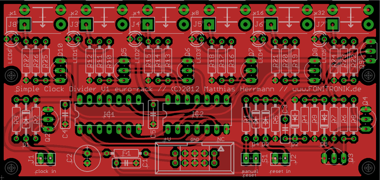

PostPosted: Mon Apr 23, 2012 3:44 am    Post subject: Reply with quote  Mark this post and the followings unread
something like this? Very Happy
this is in my drawer for a while now, maybe i should offer a PCB?
anyways, i am glad you built and like it!
great idea of making your own perfboard with socket footprints and power header!

Nice one Matthias!
Maybe I should have done a PCB as well, it's a lot smaller than the thing I'm using now. But yeah, projects with PC-mount jacks or pots get done very quickly, but projects where I have to mount the PCB somehow stay in the drawer a longgggg time. Hate doing wiring and sheetmetal work to mount something (despite being a mechanical engineer Very Happy ).
The disadvantage of the thing I did was that I didn't use Eagle but illustration software, so I don't have gerbers, so I can only make it using PnP and hence have to drill a ton of holes.
Do you have a library with a footprint for those cliff sockets?
