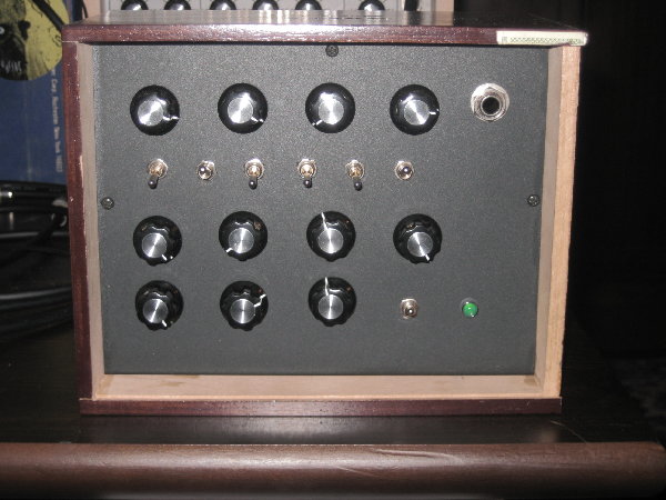

PostPosted: Sat Jan 17, 2009 1:01 pm    Post subject: Reply with quote  Mark this post and the followings unread
Hi, I dont know much about anything so I dont pipe up too much on this site but one thing I do know about is being cheap and super DIY. I dont want to shell out money for anything. This is what I do for my panels, I dont advocate stealing AT ALL, but street sign stock is usually aluminum and is a perfect 1/16 inch so its easy to work with (you can find them also at yard sales and thrift stores). To get the paint off I use a pnuematic sander but an electric would do well. Also (I dont know how it works in the UK or elsewhere) I got friendly with the guys down at my local city maintenence facility. they usually have a sign shop to make signs for ball fields and the like. go ask them, buy them some coffee or beers and they would be happy to give up some unpainted sign stock. a couple panels of those will go a long way. I dont get the black anodized but polished aluminum looks nice too. if i do want the black, I cut up the covers to old VCRs or tape decks or DVD players that I find in the garbage. they work well and also I reuse the components inside. I just made a power supply for free using parts out of an old amplifier. I have access to a shop so cutting isnt an issue for me. the way I would do it otherwise is either A) find somebody with a band saw or B) go to sears or home depot and get a high speed drill and also get a cut off wheel and bit. it will take some practice to get straight lines but I have done this in a pinch. heres some pics to get and idea of the results

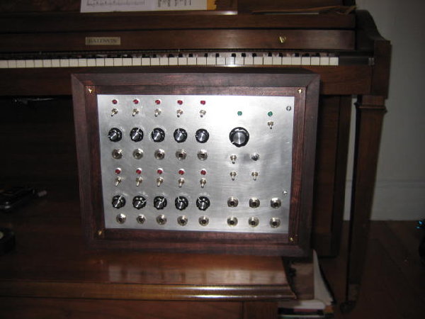

PostPosted: Sun Jan 18, 2009 10:36 am    Post subject: Reply with quote  Mark this post and the followings unread
Heres an example of a WSG I recently made. the black panel was from the top of a DVD player. its made of steel but its strong and thin enough to drill through without issue.

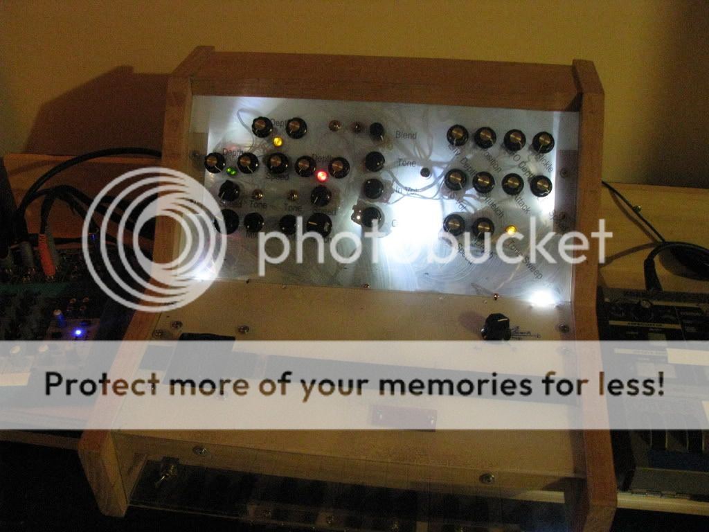

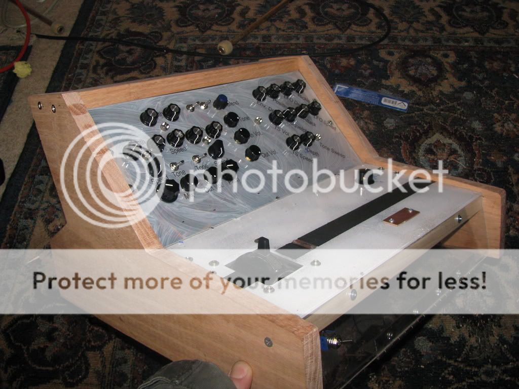

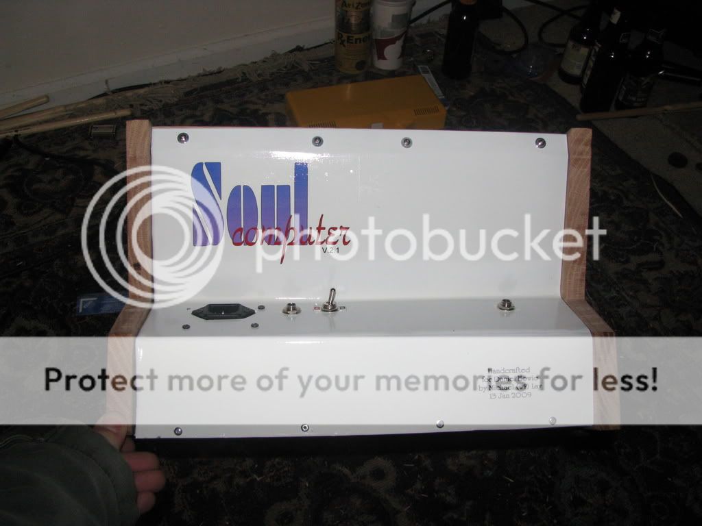

PostPosted: Mon Jan 26, 2009 7:37 pm    Post subject: Front Panel
Subject description: DIY
Hey guys, I've been reading a lot of the posts but this will be my first response. I know the aluminum front panel will look awesome once it is done. Personally though I really love what you can do with plexi. I know it's already been discussed but here is my example of what can be done with it. This is a piece I was commissioned to build for Daniel Howie of the band Sugar Glyder. I recommended the WSG or the Sound-Lab but he decided he liked the chirps of the TriWave-Atoner combo.
Photobucket
Soul Computer
Photobucket
RF
Joined: Mar 23, 2007
Posts: 1502
Audio files: 28
PostPosted: Mon Jan 26, 2009 8:56 pm    Post subject: Reply with quote  Mark this post and the followings unread
Great Job WizMike! I really like the backlit panel.
bruce
www.sdiy.org/rfeng
Wizard Mike
Joined: Jan 26, 2009
Posts: 52
Location: Charlotte
PostPosted: Mon Jan 26, 2009 9:49 pm    Post subject: Reply with quote  Mark this post and the followings unread
Thank you Very Happy The were kinda added as an after thought. I think it will look good on stage.
