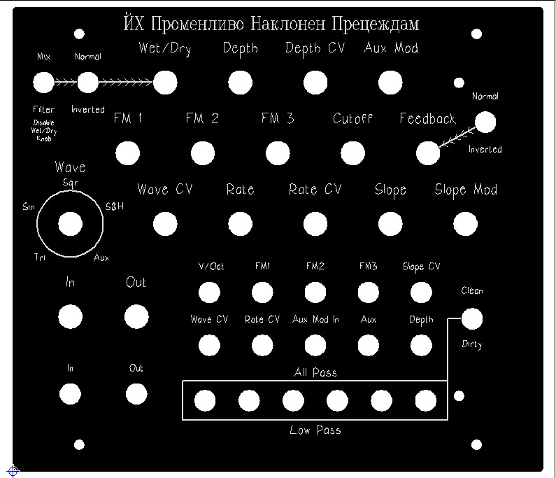

PostPosted: Mon Mar 01, 2010 10:56 pm    Post subject: Reply with quote  Mark this post and the followings unread
I'm gearing up to build one or two for a Frac Rack system. So, here's my close to order FPD panel file for your consideration. It does not have mounting holes for the PCB yet. I like to use a pair of standoffs and mount the PCB vertically if i can. Anyway, this panel includes all the controls except a bypass switch. I figure I can unplug it if I don't want it. It also includes JH's Mix/Filter switch which is not on the schematics. It takes the mix pot out of the loop. JH used a Push/Pull type pot. I'm going to use a DPDT switch.
I've test fitted Alpha 12 mm pots, Swichcraft "tiny" jacks, and the small SPST switches and I think it is good to go. Bigger pots will probably not work especially on the top row.
This should translate well to a Euro size with little or no modifications. other than panel width and mounting holes.
Please let me know if I have missed something. I'll probably order the panel in a couple of weeks.
The name is in Bulgarian as are all my custom designs (long story) and reads, "JH Variable Slope Filter".
EDIT *****************************8
I made some small changes to the panel and added some mounting holes
on the right side. Also, note that the pot holes are 0.2813 inches which works great for the 12mm alpha pots.
I don't think the switches on the bottom are ideal, but i like to put labels on top and so this configuration worked best for me.
David

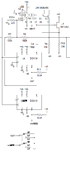

jhaible wrote:
Theoretically that HPF should come as MOTM module some day, so I was reluctant put a HPF mode into this PCB project.
But you can easily hack the circuit to get a HPF:
http://www.jhaible.de/varislope_filter_phaser/varislope_filter_phaser_sch1.pdf
(1) Remove R7, R15, R20, R26, R31, R36.
(2) Omit all DG419 chips and connect Pin1 to Pin2 on each DG419 footprint.
Not tested by me, but it should work!
(Please report back if you have tried it. Smile )
JH.
If I'm reading the schematic correctly, then it should be fairly simple to add a DG419 for each stage and use DPDT on-none-on switches to select high pass, all pass, & low pass for each stage. I've modified Jürgen's schematic to show this for a single stage.
Time for another parts order!
 Filesize:  48.89 KB
 Viewed:  2371 Time(s)
jhaible
Joined: May 25, 2007
Posts: 2014
PostPosted: Mon Oct 25, 2010 12:27 am    Post subject: Reply with quote  Mark this post and the followings unread
Sure, you can disconnect the path from the previous stage to the OTA input, while leaving the capacitor connected to the previous stage, thus forming a HPF function. Just like this old Emu patent, and the SSM2040 data sheet, show. And with the voltage controlled pole spread circuitry on that board, you get a Variable Slope HPF.
The reason why I had not implemented this on the board right from the start is simple: I have contributed a Variable Slope HPF, using this technology, to become a MOTM module. But that was many years ago, and I haven't seen it seeing the light of day, so yes: it's a good thing to modify the circuit like this.
Just a little hint: Instead of packing another six DG switches somewhere on the solder side (?), build a second board and hard-wire it to HPF function. Omit the DG's altogether, wire the caps to the previous stage, and omit the 100k resistors from previous stage to OTA inputs. You may even omit the whole LFO stuff on that HPF board. Then, connect two of the filter boards in series (speaking of signal path), and enjoy a varible slope HPF - LPF configuration. You may find an unused opamp on the HPF board to make a CV inverter, and route some Voltage Controled Bandwidth function for the resulting BPF filter. (I think Buchla or Serge had something like that, but certainly not in 12-pole configuration, and probably not Variable Slope, either.)
