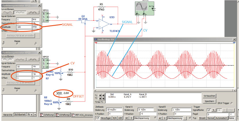

Sorry for bringing up the old threat, but I think a simple VCA is always interresting.
I found in the wonderfull YUSYNTH Archive the chronosynth.
The chronosynth has a very simple VCA.
I didnt had my Stuff here , so I cant breadboard it.
So I simulate this, and it seem to work.
I omit one Resistor and one cap. Please notice the input Levels.
GL
gabba

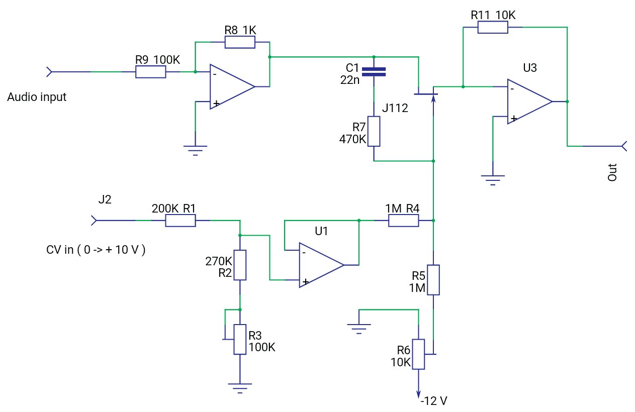

PostPosted: Tue Jan 24, 2017 5:51 pm    Post subject: Jfet VCA Reply with quote  Mark this post and the followings unread
It is possible to improve the performance of the jfet VCA by adding 50% of the signal on the drain to the gate the rationale is somewhat mathematical but basically it helps iron out the non linearities in the resistance between drain and source reducing distortion that these non linearities normally introduce.

PostPosted: Wed Jan 25, 2017 1:36 am    Post subject: Re: Jfet VCA Reply with quote  Mark this post and the followings unread
interesting circuit. did you simulate this circuit? how it performs?

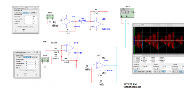

PostPosted: Wed Jan 25, 2017 2:39 am    Post subject: Reply with quote  Mark this post and the followings unread
this reminds me on something from the storeroom
 Filesize:  467.43 KB
 Viewed:  626 Time(s)
 Filesize:  114.36 KB
 Viewed:  680 Time(s)

PostPosted: Wed Jan 25, 2017 4:04 am    Post subject: Re: Jfet VCA Reply with quote  Mark this post and the followings unread
jurekprzezdziecki wrote:
I've built it on a breadboard and it works well in terms of distortion. The unusual thing about it is the relationship between CV and gain, which is neither linear or exponential in nature.

PostPosted: Wed Jan 25, 2017 1:57 pm    Post subject: Jfet VCA Reply with quote  Mark this post and the followings unread
The attached circuit shows the key components for the distortion cancelling circuit, this addition with C1, R1 & R2 can be used with any existing jfet based audio circuits, in this case VCA's such as the one featuring a bf245 ( if you can find one anymore! )
As I mentioned earlier the circuit works by putting 50% of the signal voltage at the drain onto the dc control voltage at the gate. From the point of view of the AC signal the capacitor is basically a short circuit, it exists so that the DC control voltage isn't similarly halved.
I would add a variable input resistor as a initial gain offset. It helps if you're not feeding any cv input signal.
I agree that this would be a good idea in a practical design.
