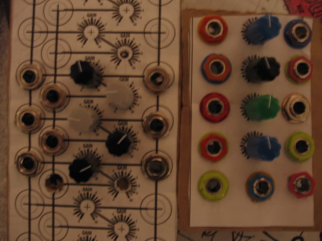

I think both arguments are valid. That's why I am using a bunch of separate modules to make my ideal vc pan/fade/mixer, but all integrated behind the same panel. 8 LED drivers, 7 mixers, 4 MFOS dual VCA's, and 4 cv inverters to be exact. Here's(the one on the left) the fake partially populated cardboard version I built just to see If I could squeeze my skinny fingers around the knobs. The leftmost column of knobs and the jacks aligned them with them are the input, output and offset control, the right column and associated jack are the CV input. The inverse of every second CV input is normalled into the next. Each output 2-8 has it's own mixer and plugging in to any output from 1-7 prevents it's output from cascading down to the next mixer/output.

PostPosted: Sun Apr 12, 2009 7:14 pm    Post subject: Reply with quote  Mark this post and the followings unread
Clever use of normals. Just needs another output bus on the right to make a stereo mix from pairs of input channels.

PostPosted: Sun Apr 12, 2009 9:01 pm    Post subject: Reply with quote  Mark this post and the followings unread
I never considered making anything stereo. I'm still running my while rig through a big ol' keyboard amp and spending way too much time/money on the modular to look into proper monitors Embarassed
